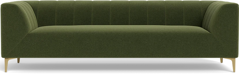

I am somewhat modeling my design after this sofa:

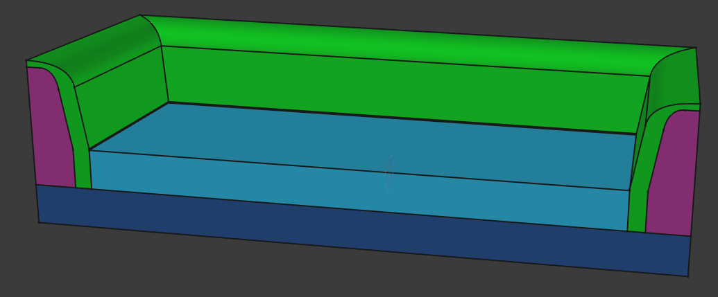

Except in my design I'm creating a separate bench cushion, this is my work in progress CAD model:
If I were to use springs or webbing, I don't think they would even really come in contact with the person's back (most of the back pressure is at the upper back)..
I have been designing this sofa around the plan that I will use about 2.5 inches of medium/firm density foam (indicated by green in my CAD model), on top of solid wood (no webbing/springs. But I am concerned it may be too hard..
Do you have any thoughts, ideas, recommendations how to approach this? Have you seen the frame work of a sofa similar to this style to see how it was made?
