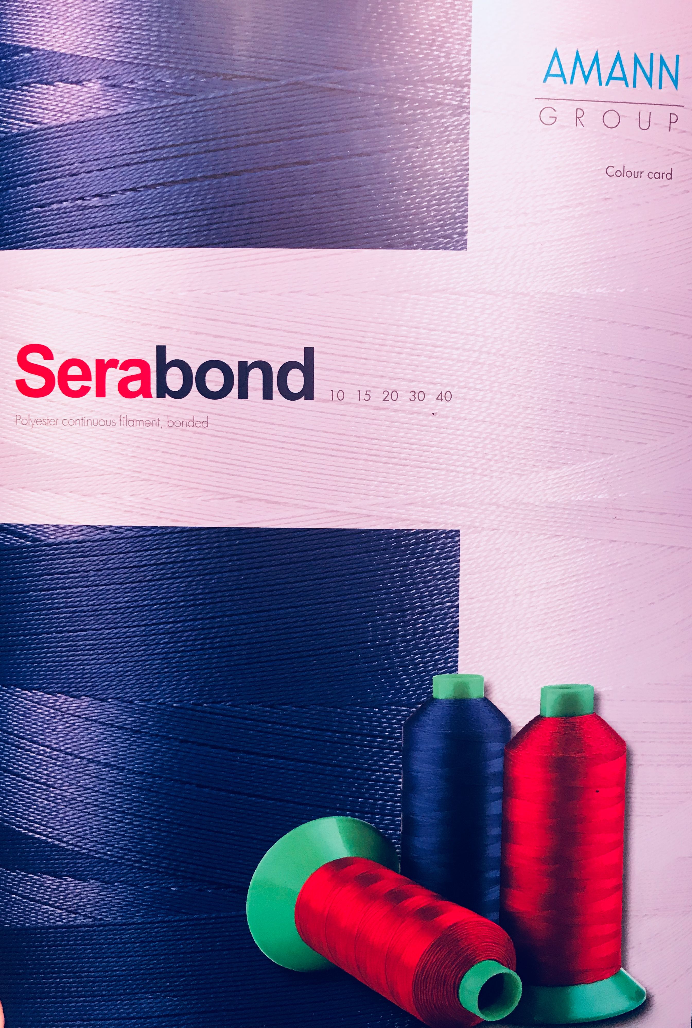

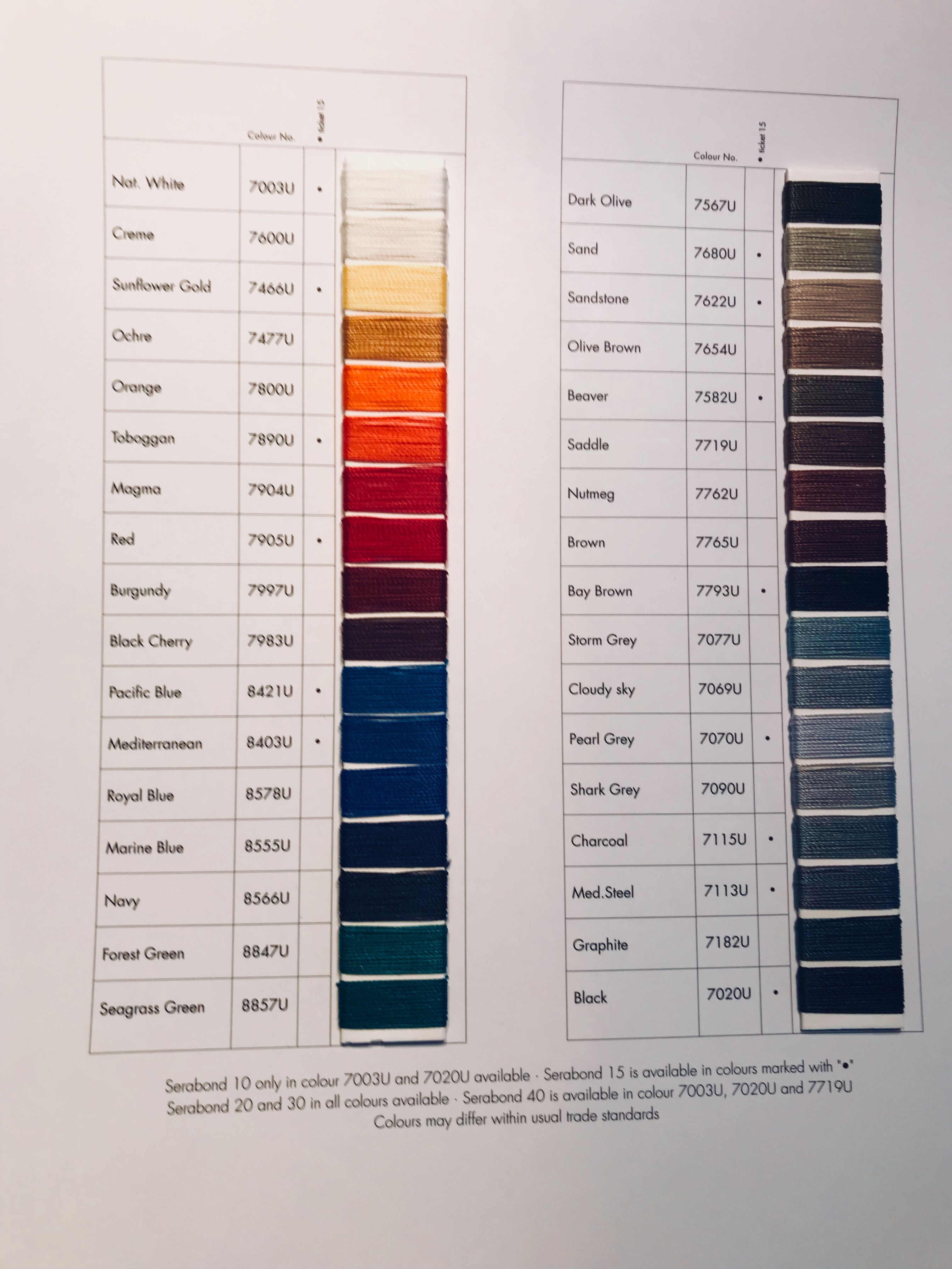

John,
Serabond really is a fantastic thread. It is made in Germany by Amann Group who is considered to be the premier thread manufacturer in Europe.
Serabond is manufactured using the best UV stable dyestuffs available in the world. It is also bonded using a proprietary process which prevents it from unraveling or balling up on your needle while sewing.
At Bry-Tech, we tested it in the field for months before becoming a Master Distributor.
Our customers love the quality, color range, sizes available, and most of all the price!
We stock Serabond in 92,138, and 210 and Bobbins in style G and M in 92 and 138.
I can email a color chart and price list to anyone who is interested.
