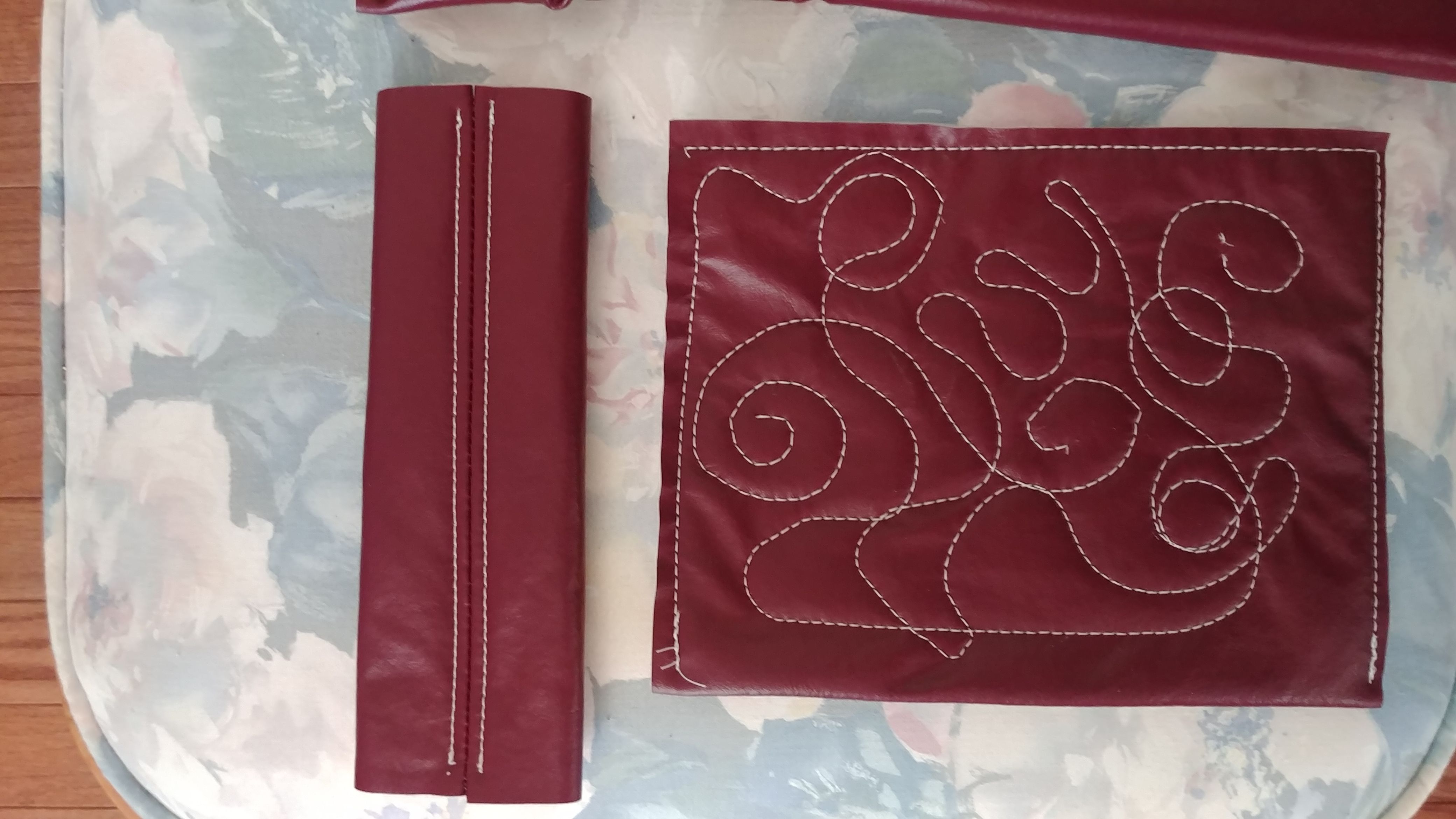

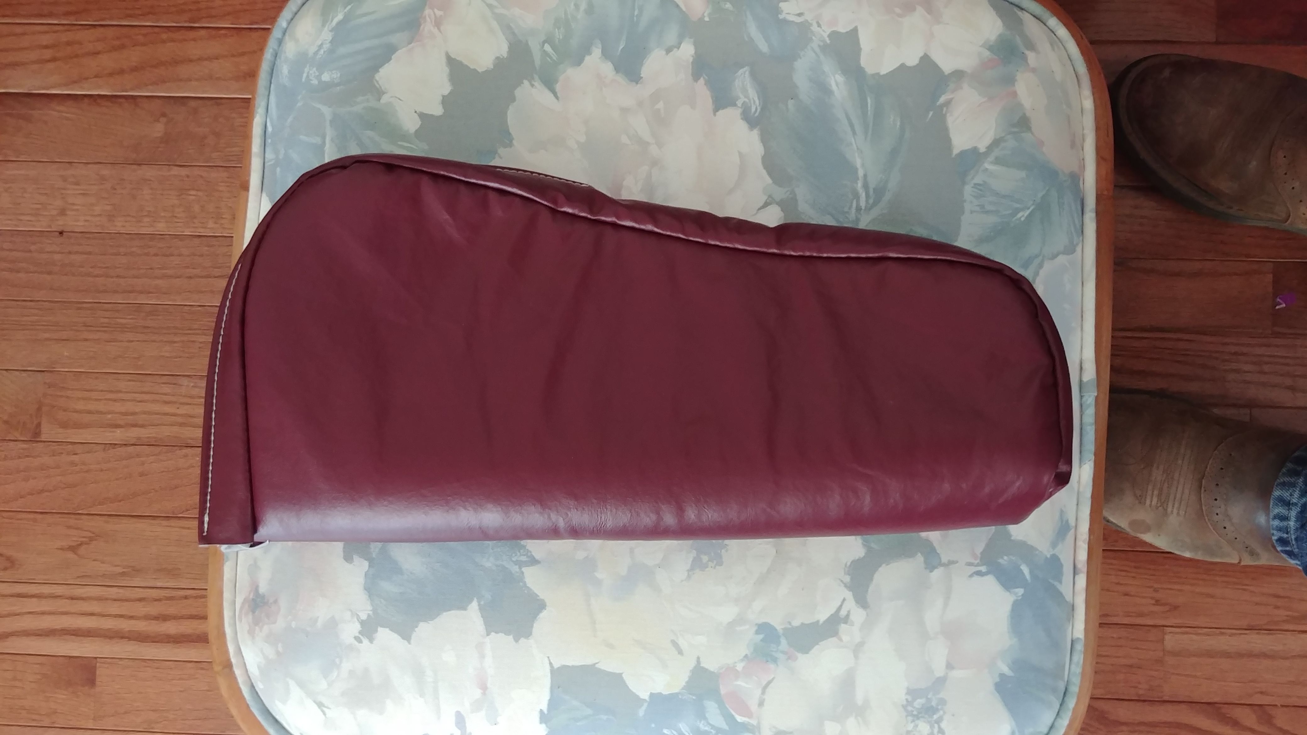

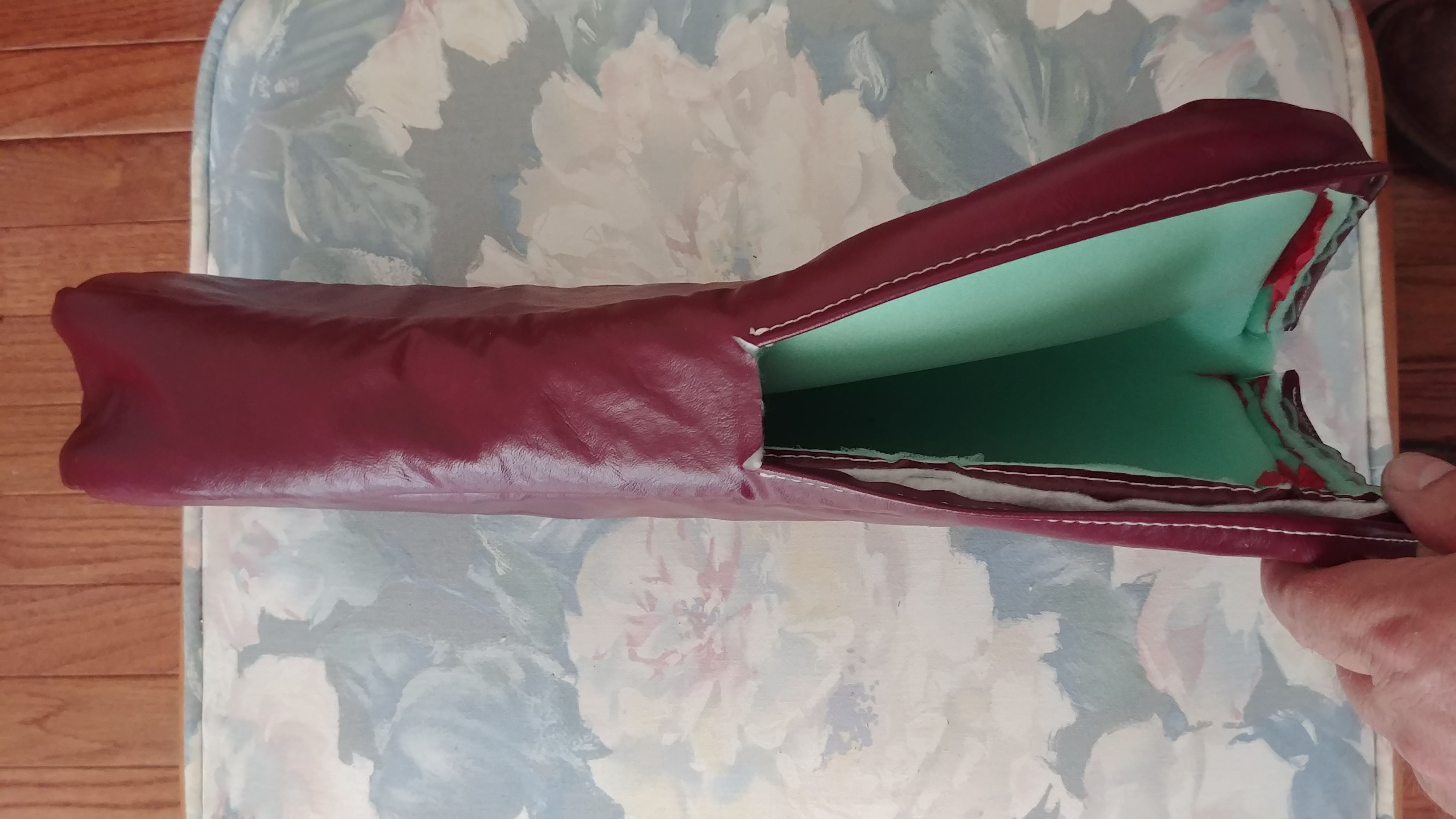

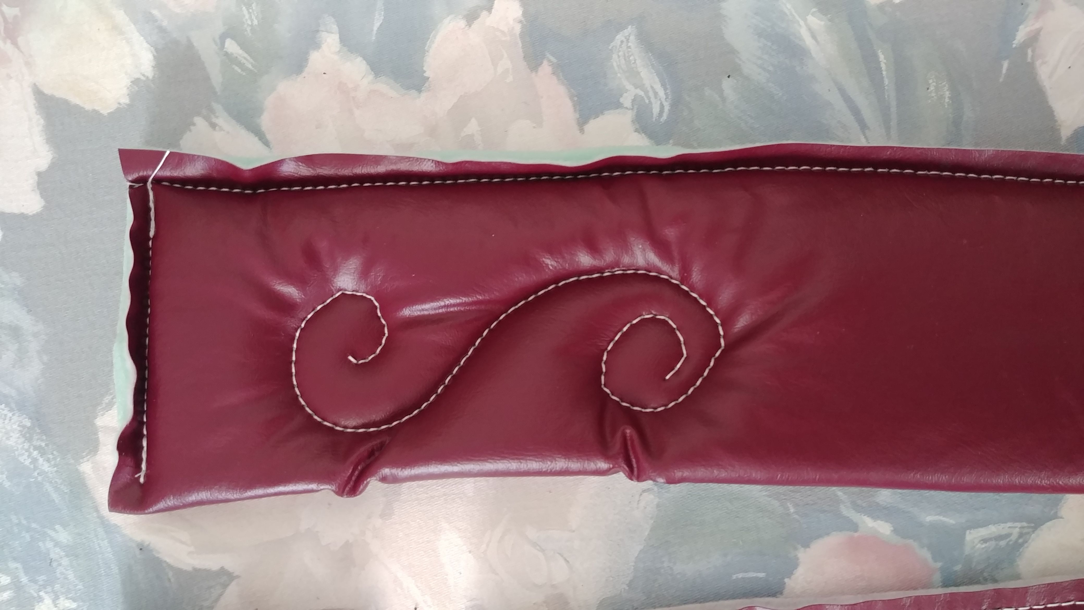

#544
Hope these don't disappoint but hey it was the first couple of hours at a sewing machine
Miker liked this
#549
I didn't have much material to practice with so I was just trying out as many fundamentals as I could with what I had so I could get a handle on this contraption they call a sewing machine. Y'all ever heard of one of these? LOL.
#550
Looking slick!
Now remember needle down and keep the foot off the gas. Sewing some pretty nice pleats then I remember John saying they look better if you can sew them faster. I will not show you how fast you can lose your stitching.
Bondo497, John liked this
#555
Hey@John, yes I tried to make a mock up with scraps I had. You made my day...... My practice resembled something you could recognise! :grinning:
