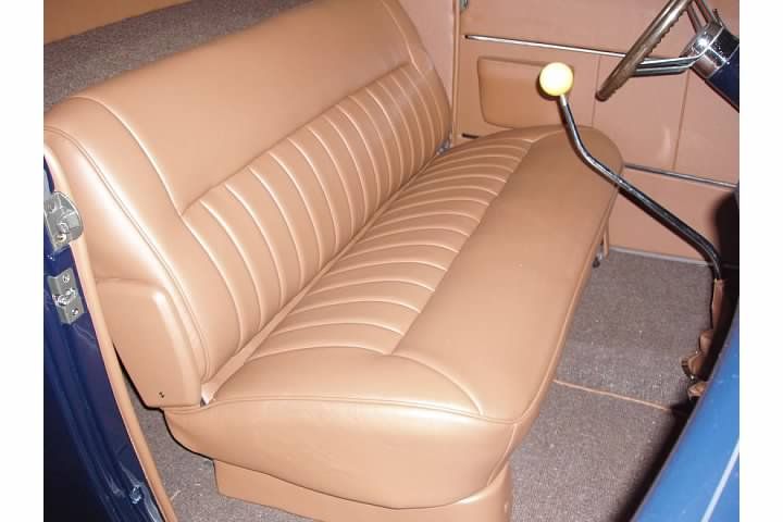

By John Long
#5880
Here is the front seat right after it was upholstered. It is the middle seat out of a Dodge Caravan.
Here is the seat today. You can see it has a pretty distressed look that I don't think it ought to have this quickly. In defense of the Ultra Leather, the front seat was sewn on a Mini Brute machine that leaves a lot to be desired. The rumble seat was the first thing I sewed after I bought the Adler 267. What a nice upgrade that was.

By Mikesimpson
#5881
I've kinda wondered how ultra leather held up long term. I have talked to some guys that have used it in show cars that don't get driven much, they let me check theirs out and it feels really nice. But when I looked into getting some samples I found out that its not really rated for automotive use.
John Long liked this
