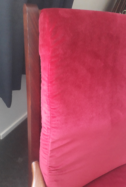

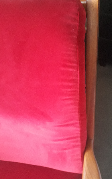

Am reupholstering a cushion for a chair using an upholstery velvet and have nearly completed it!
However I can't get this corner seam to sit flat:
Velvet - 01.png (325.58 KiB) Viewed 7116 times
Velvet - 02.png (379.67 KiB) Viewed 7116 times
The rest of the seams on the chair are fine, but none of them are on the corners like these ones.
Any idea where I'm going wrong?
#5178
This is a guess but the cover may be too tight. And so the material is trying to stretch which is really can’t. You’ll notice it more on the corner where it’s 2 directions and fighting each other vs the flat middle. Maybe if you could round the foam corner just slightly to give you a bit more room without sewing it over again

Thanks for your reply! It actually used to be lot worse when it the cushion was looser, here's a photo of before:
I wonder whether if I put it under more tension whether it would be smoother?

A couple of things to consider:
1. Are you using match marks? It looks like the wrinkles are in the boxing. The boxing look like it is gathered. You maybe pulling or pushing the layers out of alignment.
2. I find for light materials it is best not to use a walking foot machine.

Thanks, to answer your questions:
1. Initially I didn't use matching marks, but have since done so and it improved the overall shape of the cushion.
2. Have just been using a normal foot.
Was thinking of sewing the seam allowance flat, because I suspect it's the peculiar angle which the fabric is bending which is causing the distortion:
Do you think this would be a possible solution or is it kinda weird and not a common practice?
The other thing is I'm going to put 4 No. buttons in the same cushion (in tufts), so maybe I shouldn't be so concerned about the ripples, what do you think? :thinking:
#5214
Try steaming the seam and pulling it tight to get the thread to relax. Sometimes on lighter weight fabric the stitch will be tight and cause wrinkles.
Also its possible your pattern is misaligned
I hope this helps!

Hi, velvet takes a little practice and everyone has their own way of doing it. I would try and sew in the opposite direction to what you did and pull the fabric through from the back as you sew it. Just a small bit of tension when pulling it.
Hope this helps
