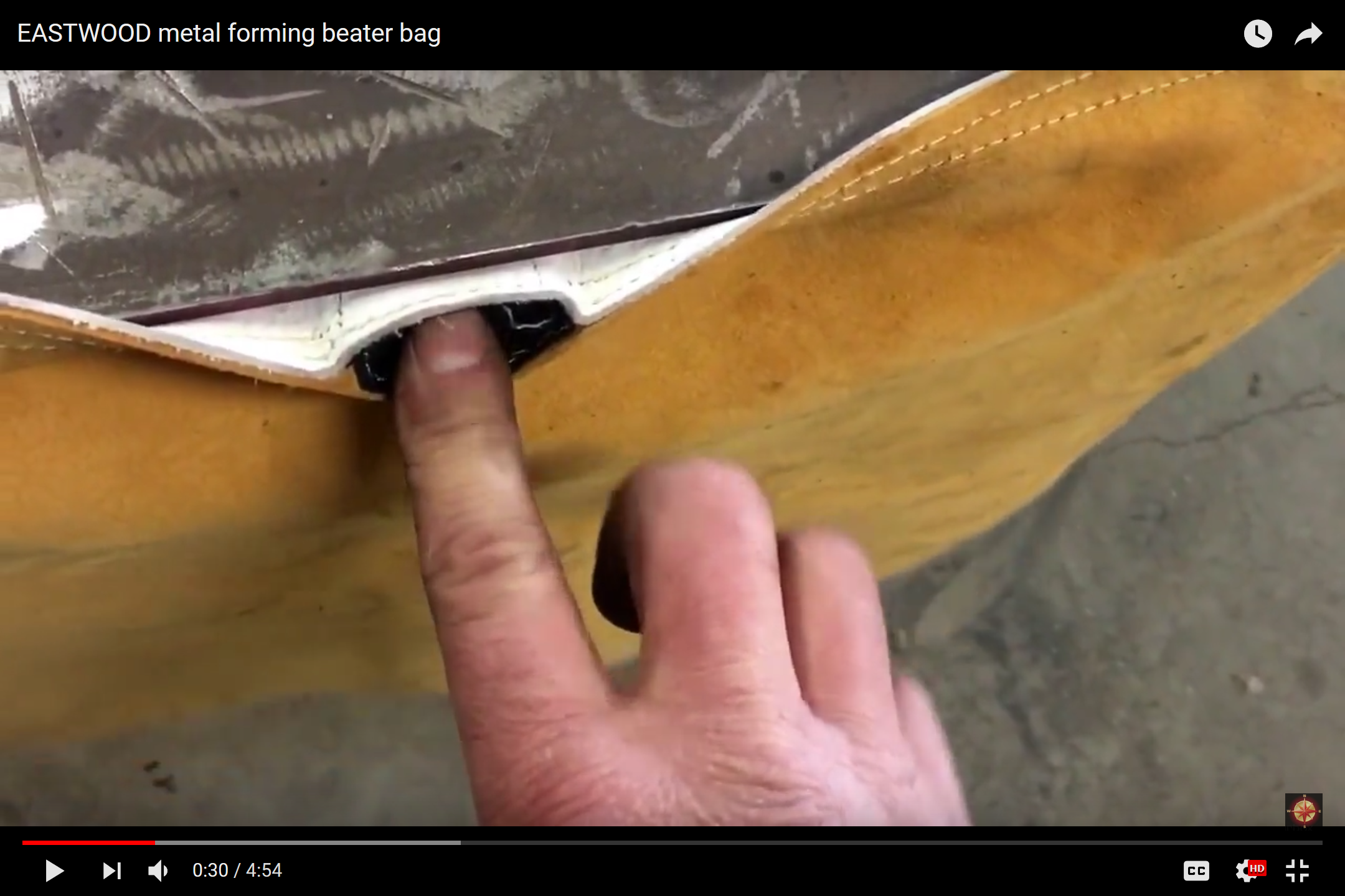

Great question. So on the cheaper bags I have seen and used have Velcro like your talking about. You might be able to use a super strong Velcro like dual lock and have better luck.
Here is a picture of an Eastwood bag with velcro.
Screenshot (37).png (1.78 MiB) Viewed 3896 times

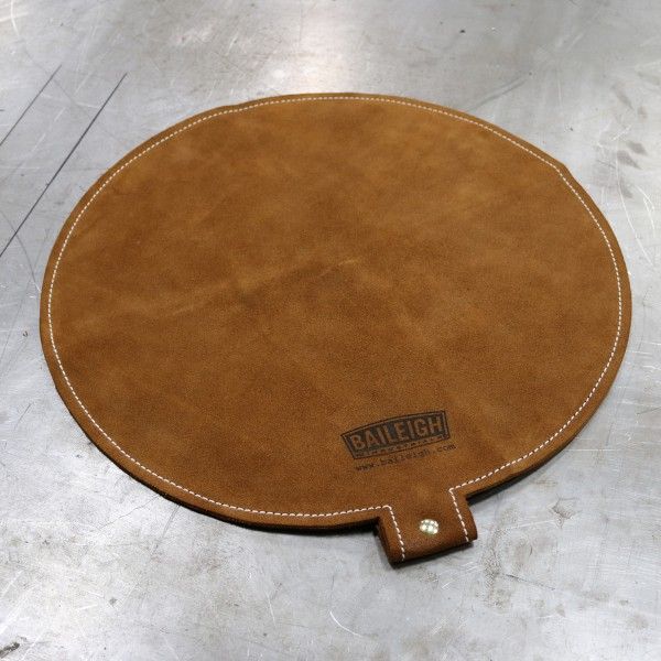

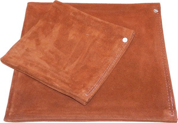

Here is a picture of a bag that uses one.
Some also have a tail that folds over like and is closed with a screw rivet.
