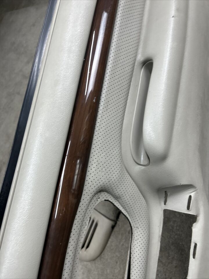

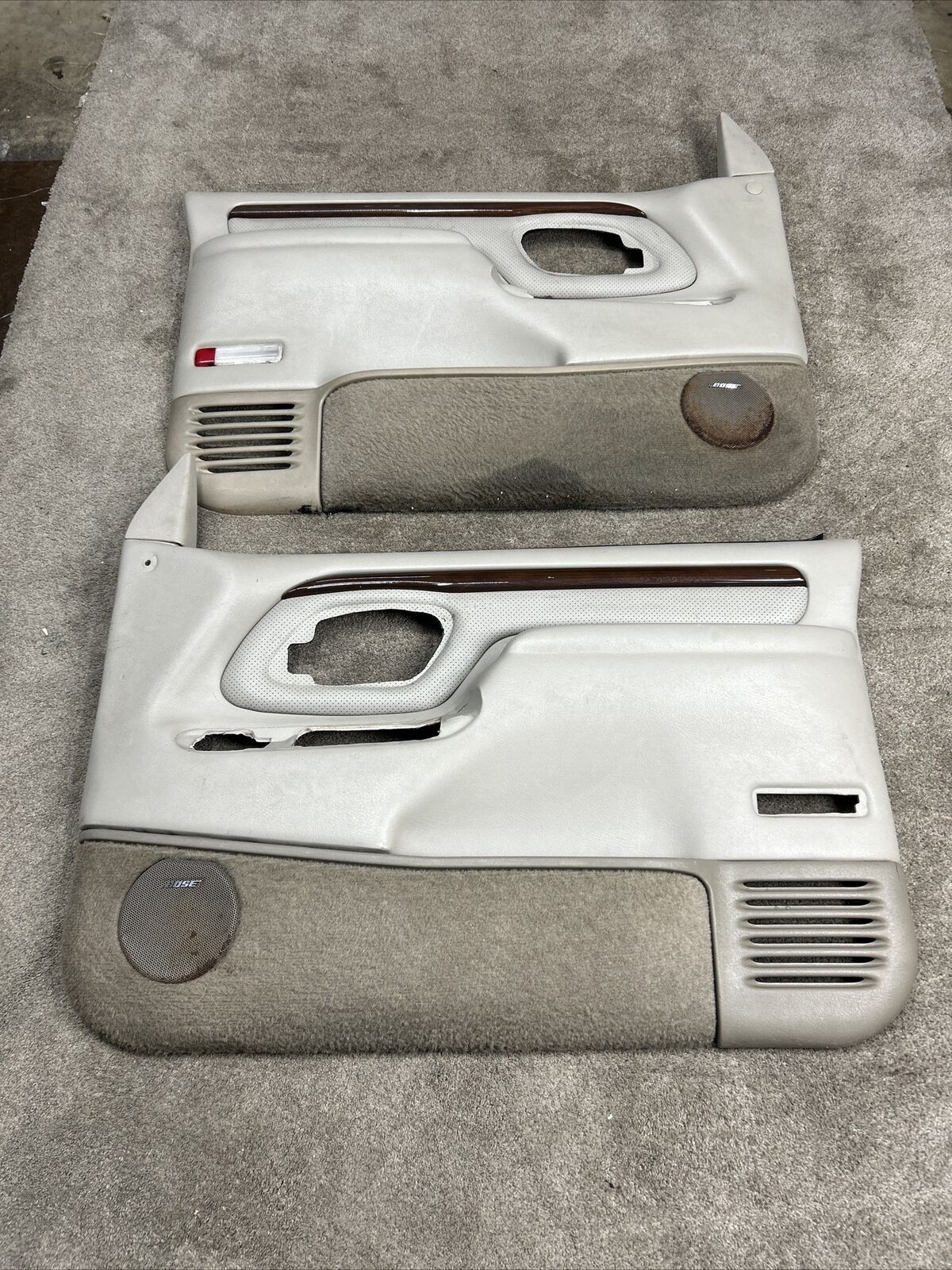

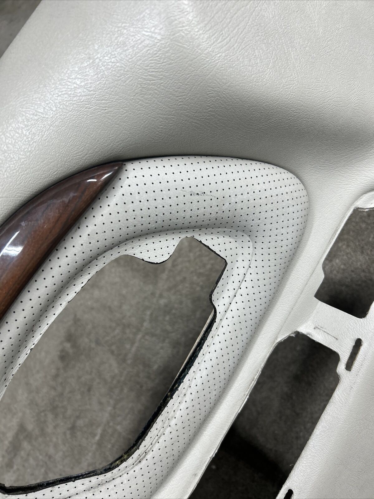

Hey all, quick question... How do you deal with door panels that have non removable inserts? I mean, do you cut everything out (foam and material) and try to come up with a suitable looking piece to replace it? Or, do you try to recover the insert where it sits on the panel? Pics are of the door panels in question...

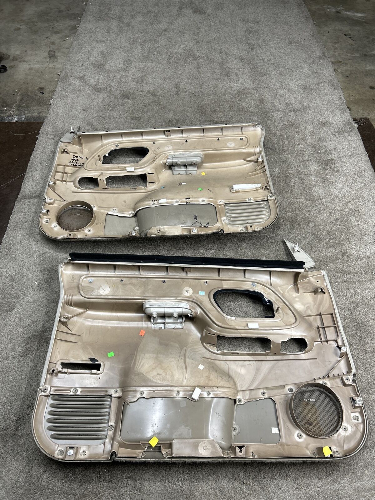

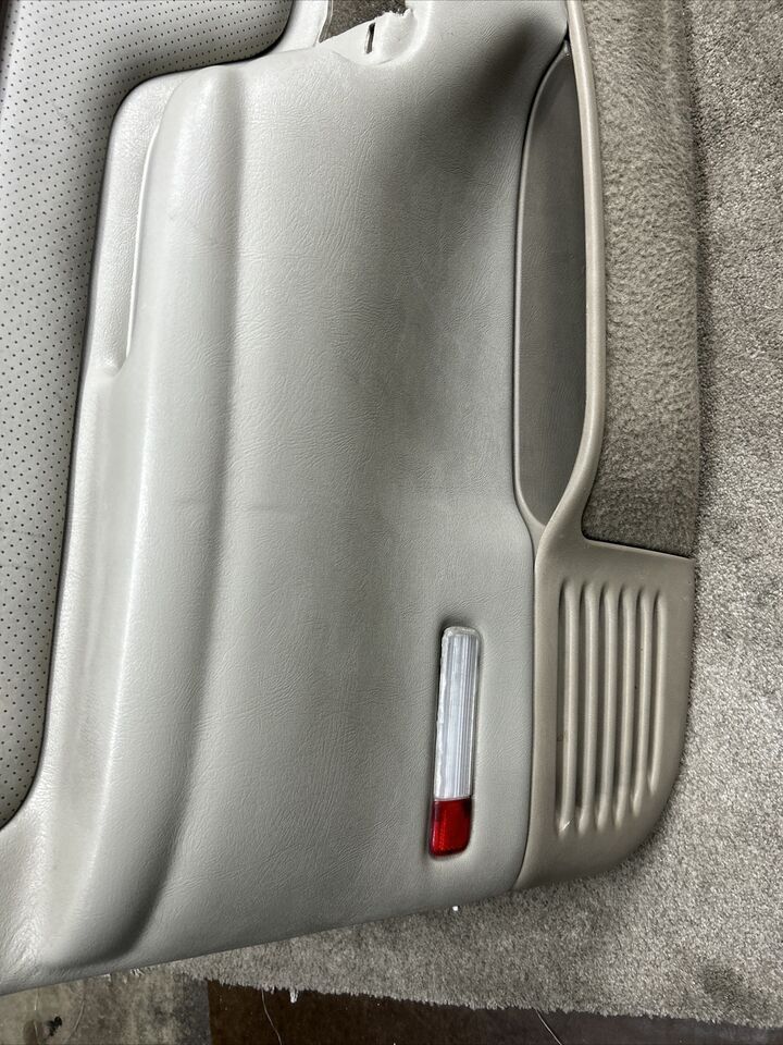

Just a couple more angles

Do you mean the ones where the door is held together with melted plastic pins?
If so I usually just unmelt the pin and reshape it then separate the pieces. Then afterward put it back together and melt the pins back down.
#17819
I use a torch.
I reshape the pins the same way I remove scratches from the front side of the door panel.
You affect only the surface of the plastic. If you affect the plastic in depth it will lose structure and you will make a mess.
This does not work for thermoset plastic, it only works for thermoplastic plastic.
