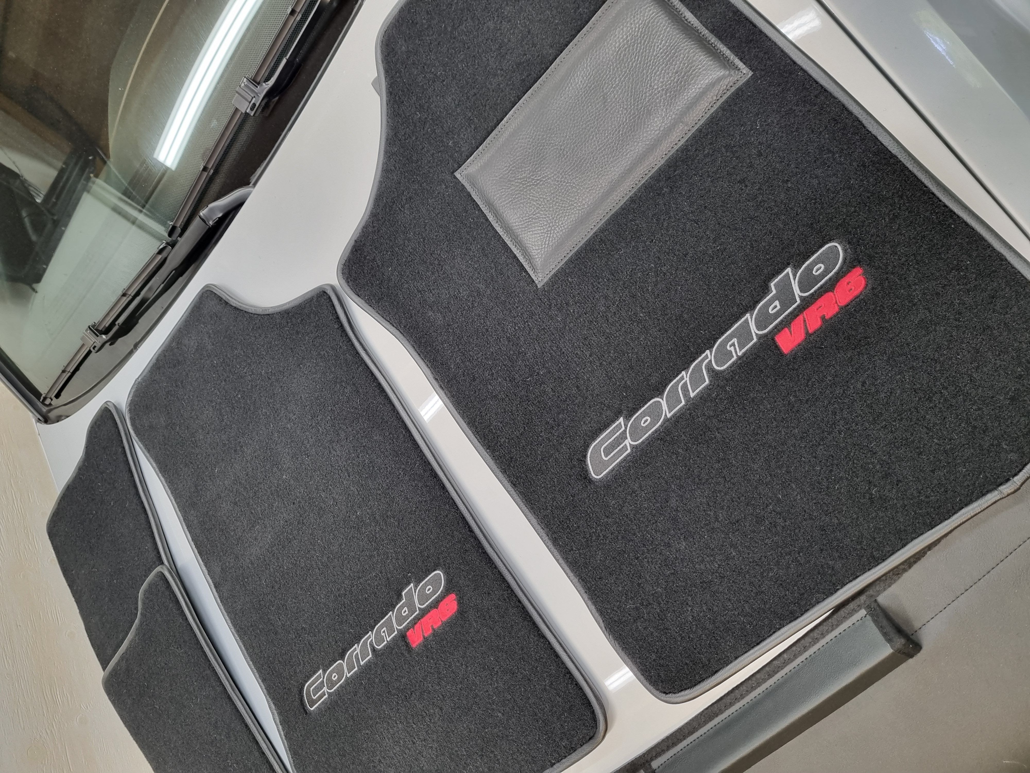

I'm thinking that it would be a good idea to make a build thread for my seats project. I'm not a professional but after buying my dream car, I promised myself that I would do everything on it. After 3 years of restauration, it's mechanicaly sound. I now turn my head towards the interior. I've done a shift boot, a e-brake boot and recently mats. I have notions about sewing but never did upholstery before. I'm sure along the way I'll have questions that will emerge and I'm hoping to get answers from the experienced people on this forum...
So I recently bought a cheap/used walking foot. Learned about thread sizes and composition and also needles from this forum and videos. And I'm giving it a go! More to follow as I go. Cheers!

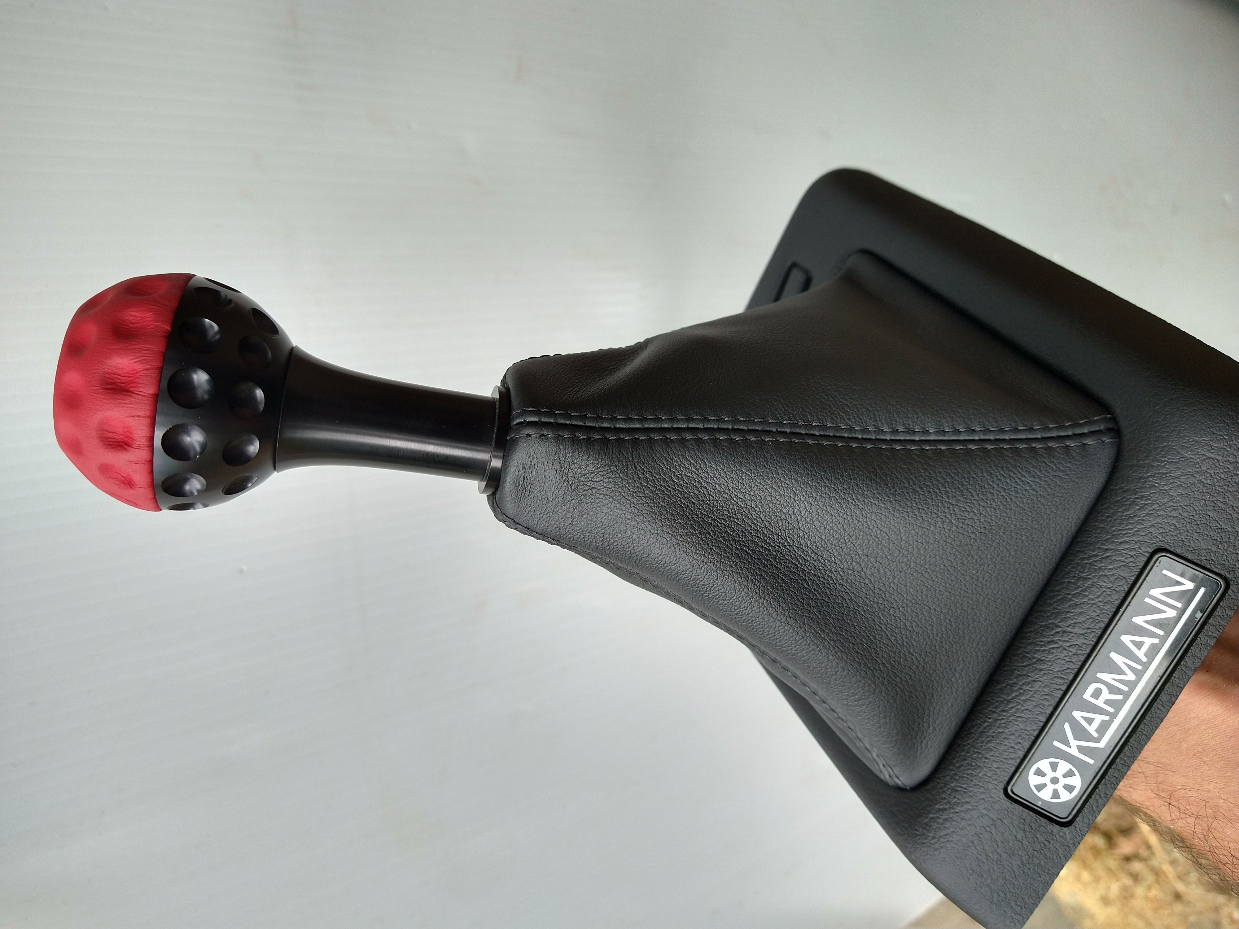

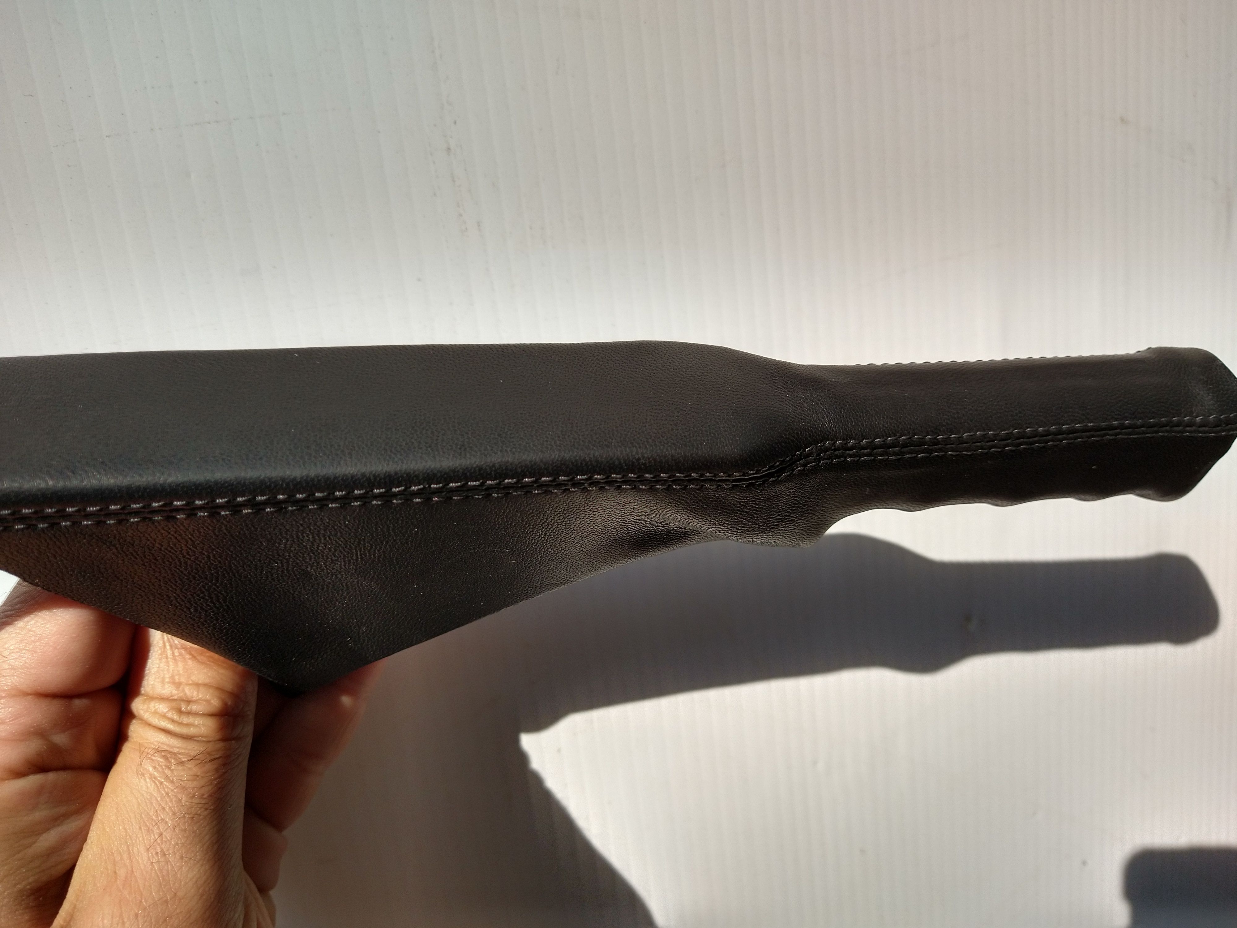

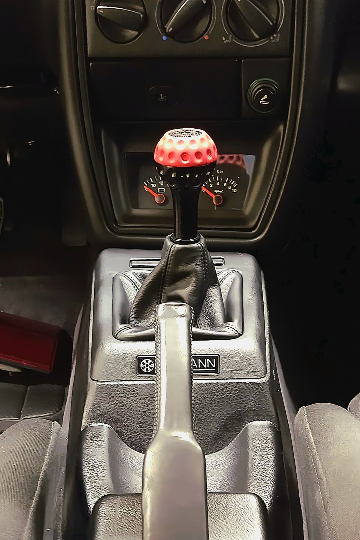

Here's the e-brake a shift boot.

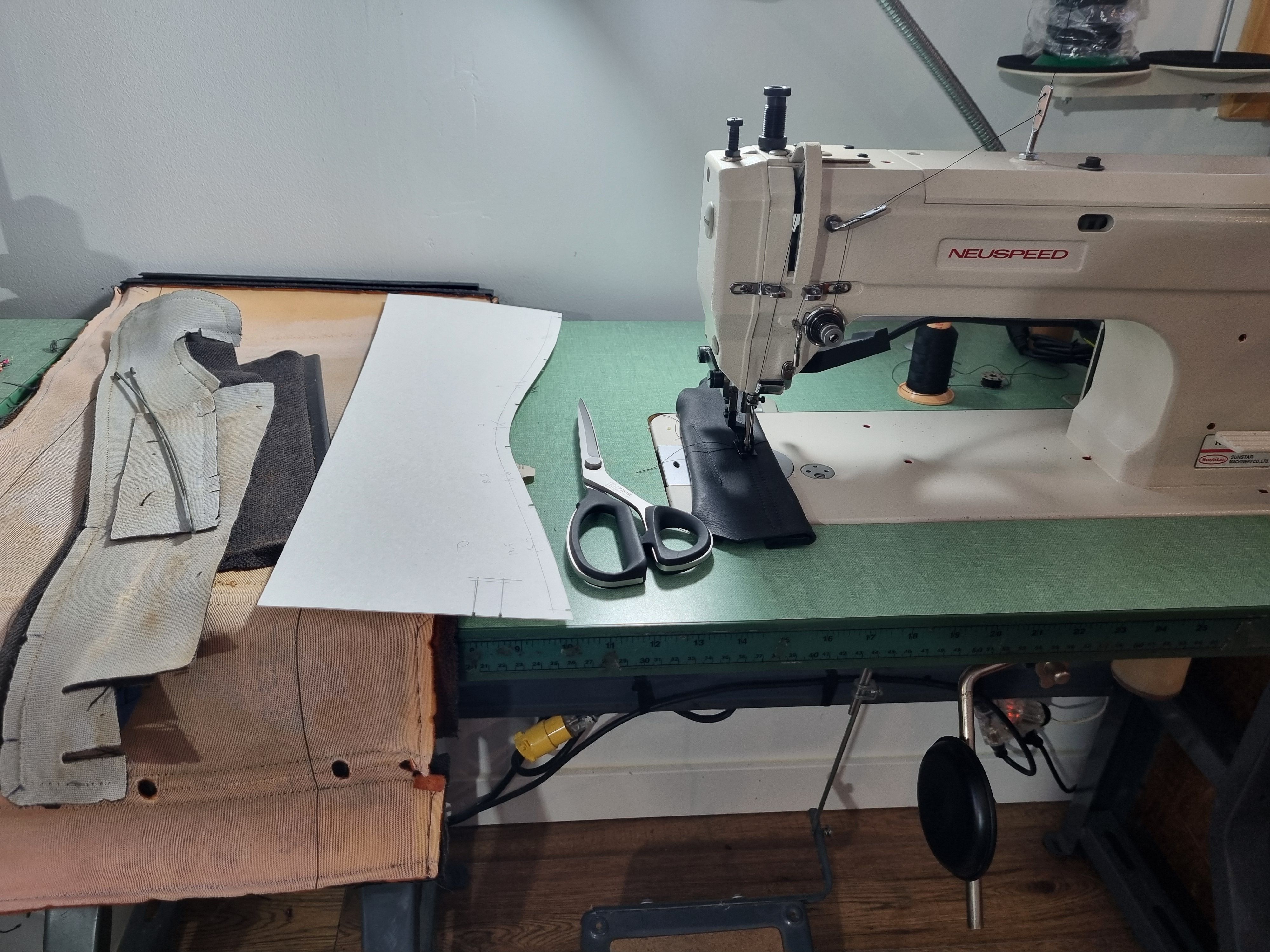

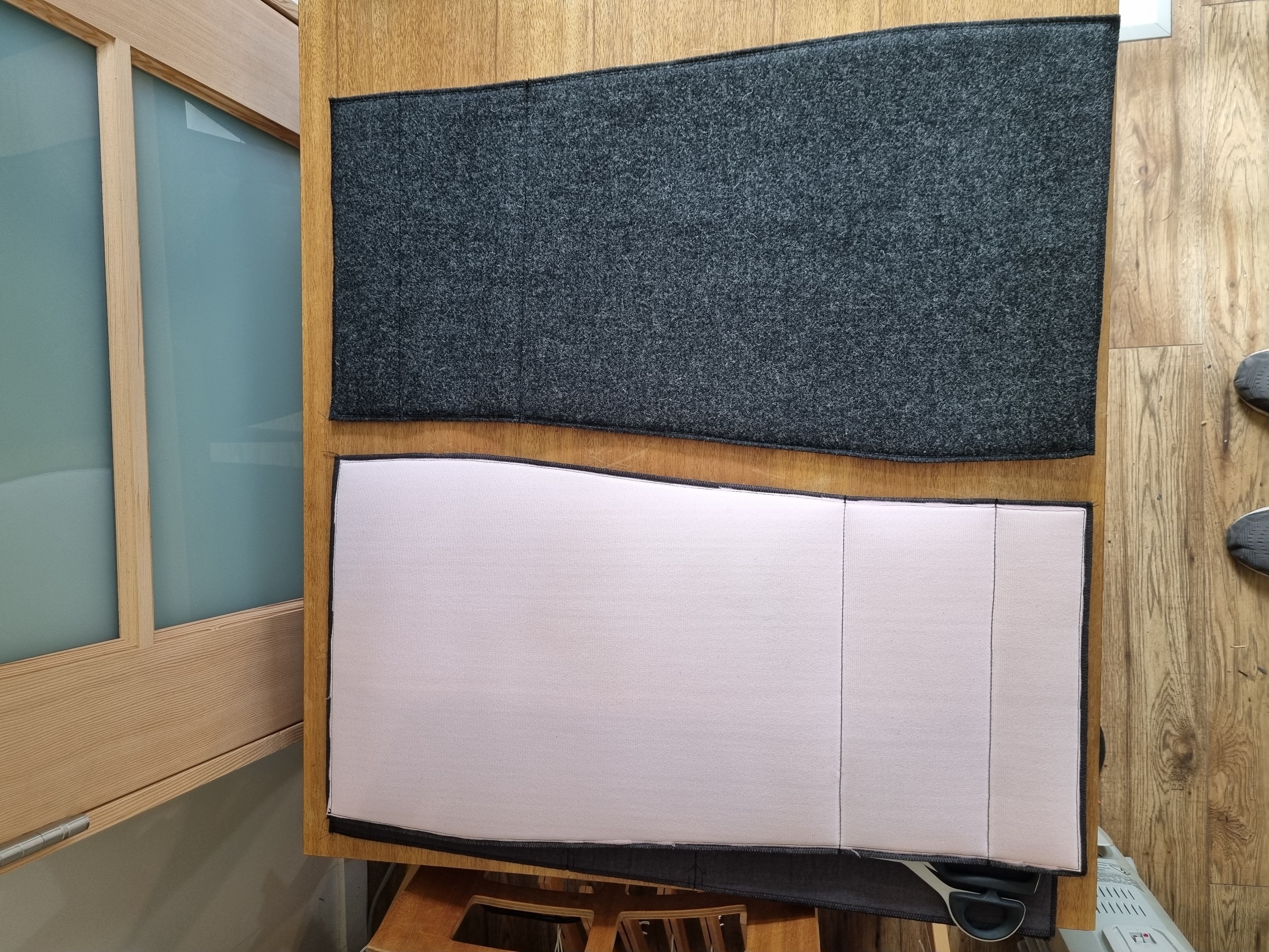

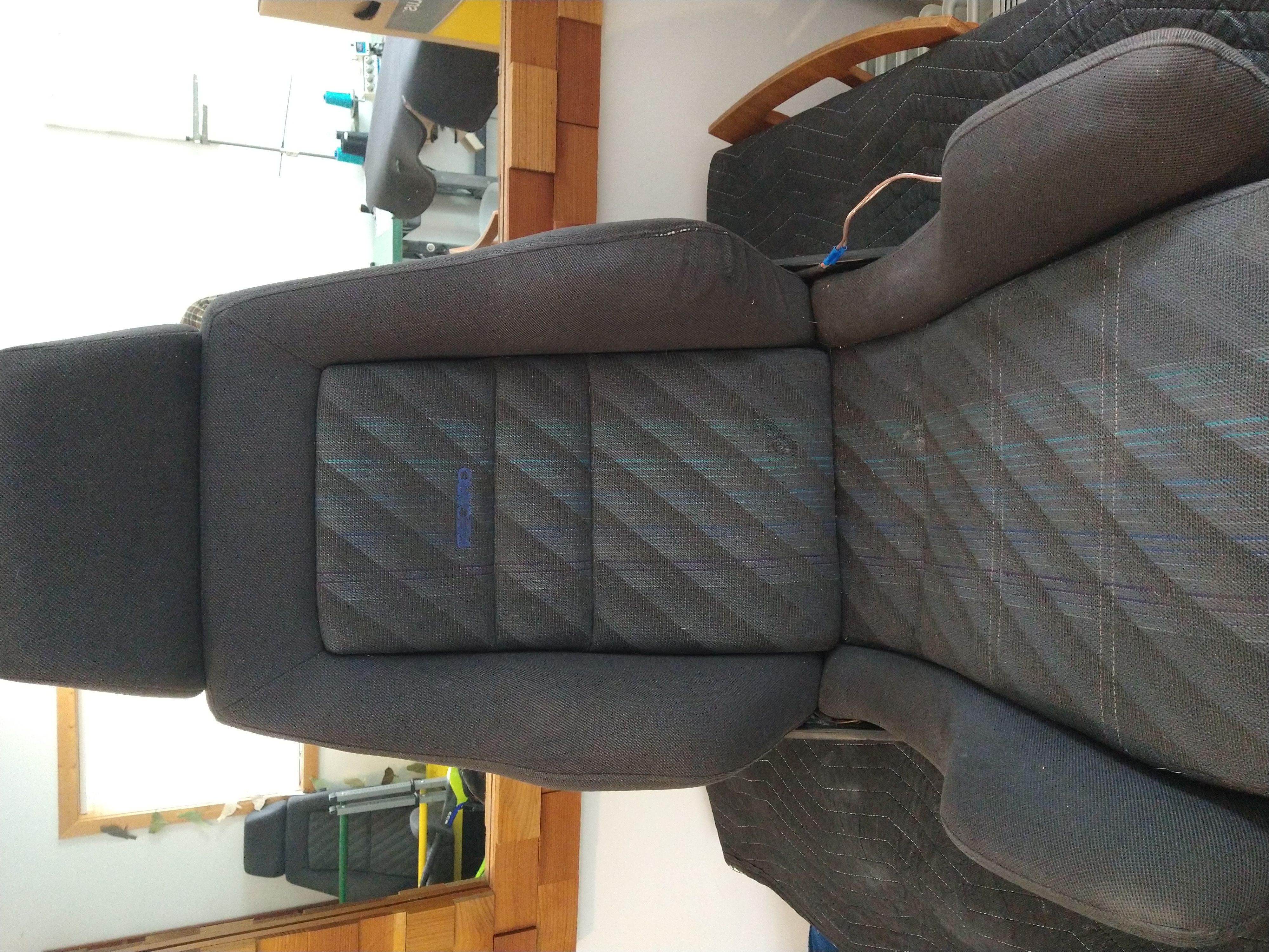

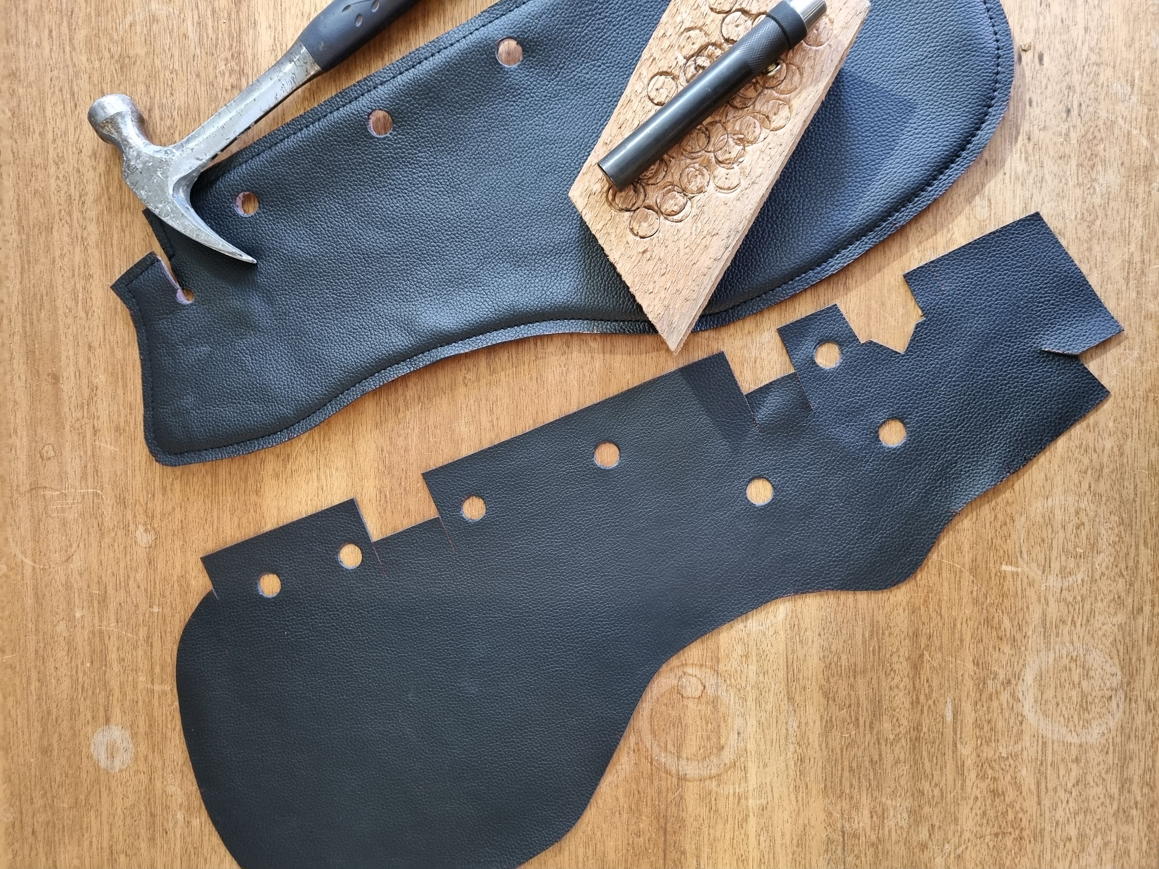

After this I'll be up to date. Basically these are the seats and I unsewed one cover to mock up the pattern. That took a long time, Recaro seats are pretty complex. Those seats are 30 years old and you can't get replacement bolsters for them. I'll have to fix a few things, that's what scares me the most in that project because if I mess up, it's game over. These seats are so rare, it took me 2 years to find them...
I made the pattern using cardboard because I'm planning on doing the bolsters in leather. I actually imported a nice upholstery leather hide from Italy. Believe it or not, it was cheaper than locally. It came rolled, it's pretty large 53 sqft actually. I'm going to try a Harris tweed for the inserts, I see this being used more and more in Europe for 90's cars restaurations. It's soft, not itchy, some are made for upholstery (rub resistant + extra thickness). Harris tweed is the only regulated fabric in the world and I imported it from Ireland. So that's the plan!
Over the weekend, I'll tackle the lower bolsters and see how it goes! More to follow...

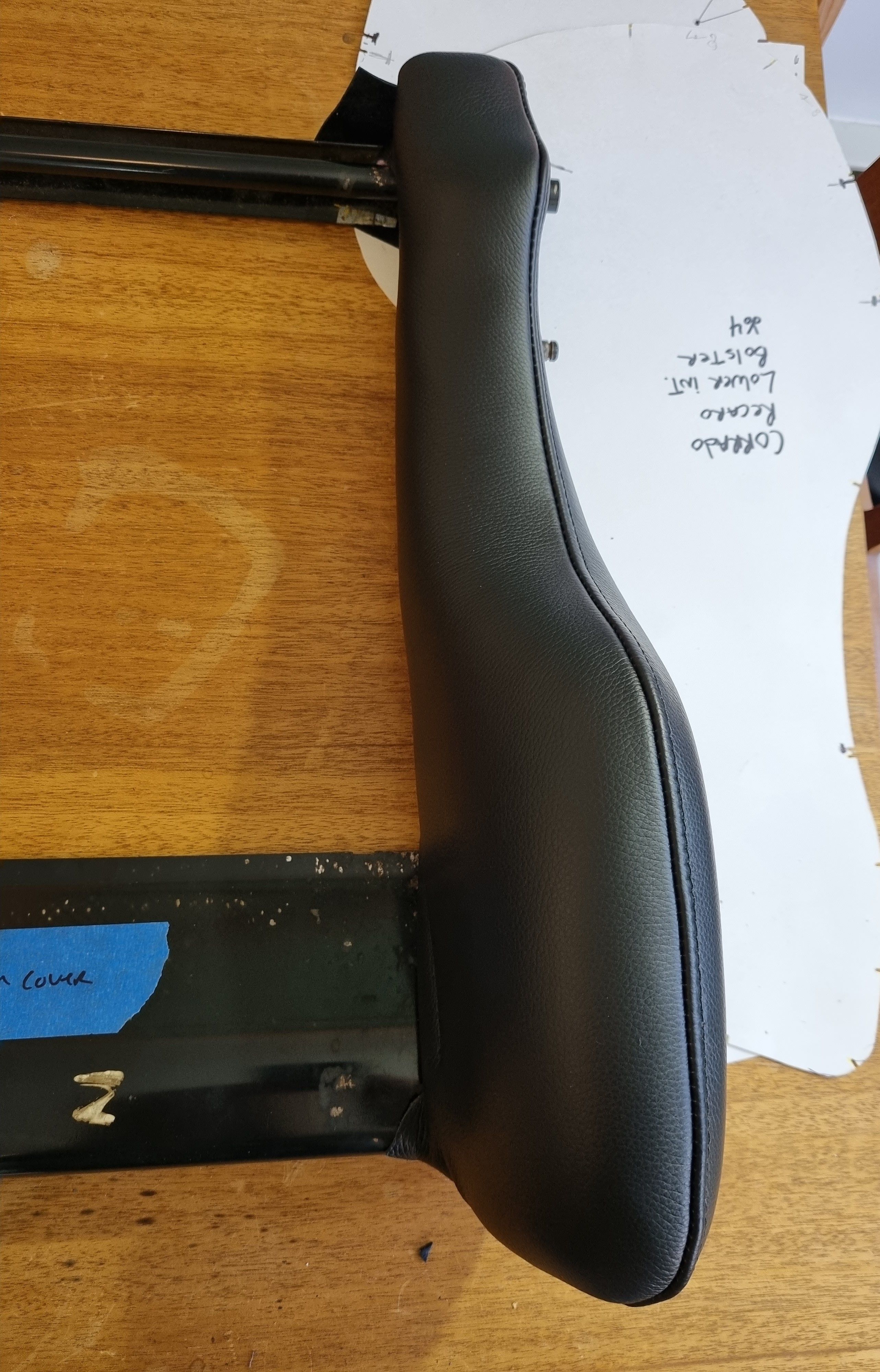

#17544

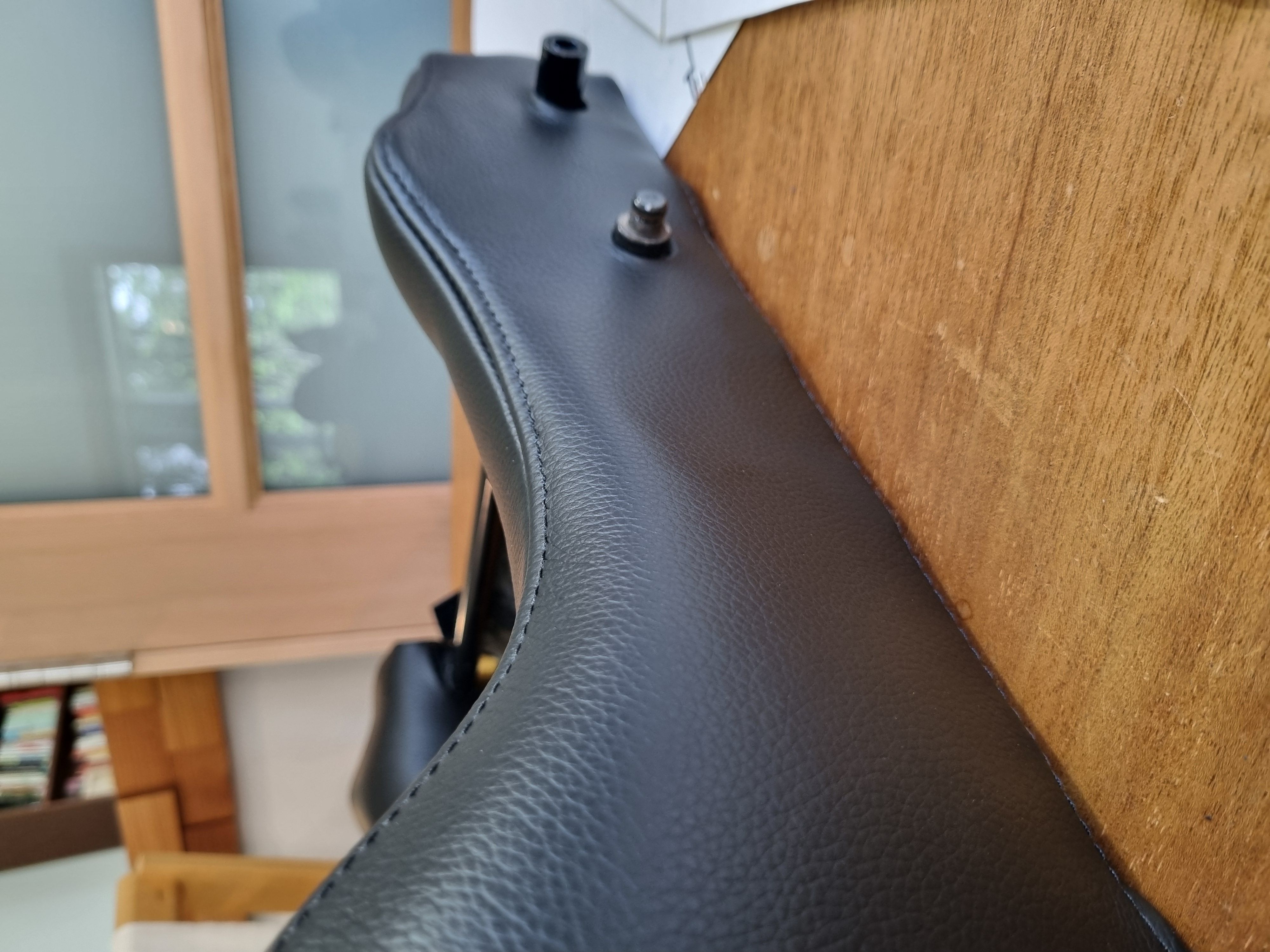

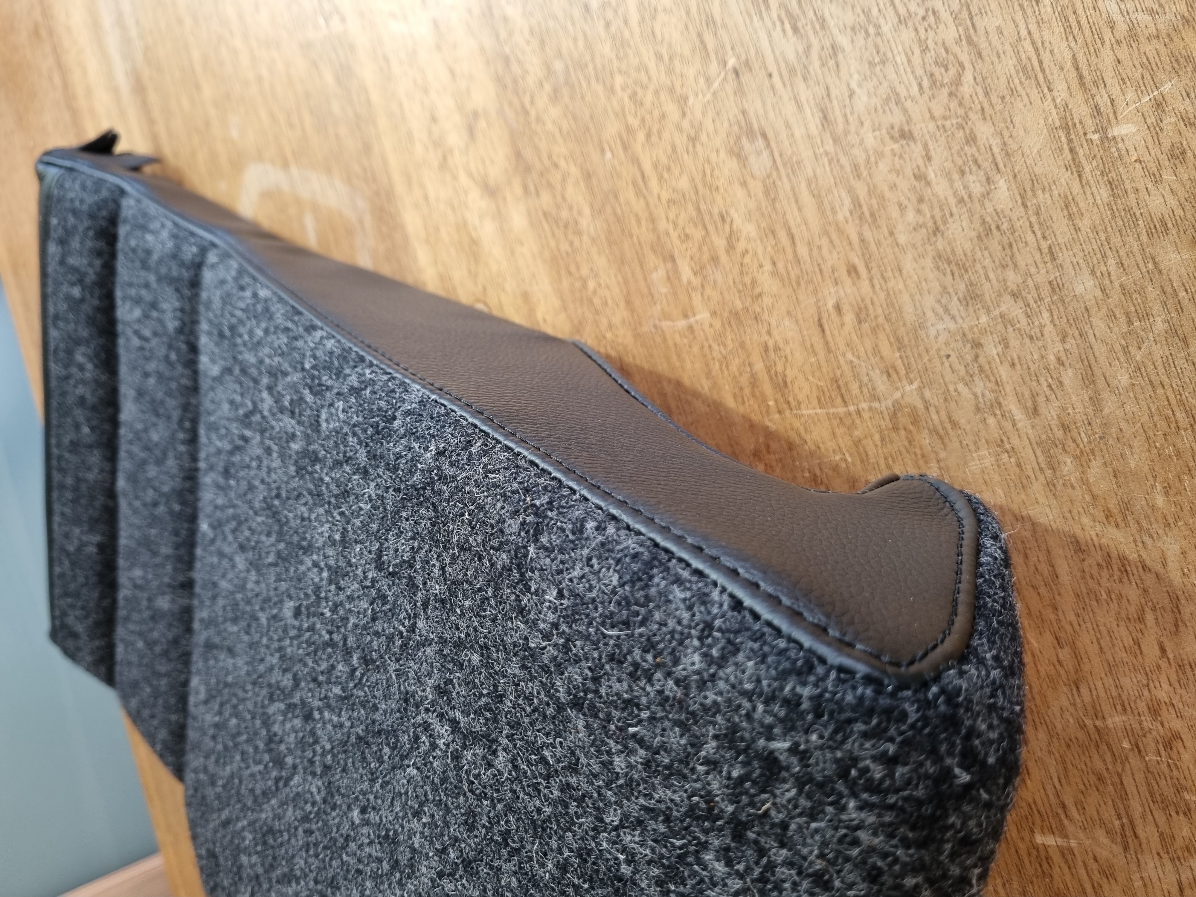

Leather lower bolsters are done. Harder than it seems to do but I'm happy with the results. There's so much curves to deal with plus the thickness of the upholstery leather and the 1/4 scrim. And there's 4 to make! I used a 3/16" foot for the top stitching with Serabond 135.

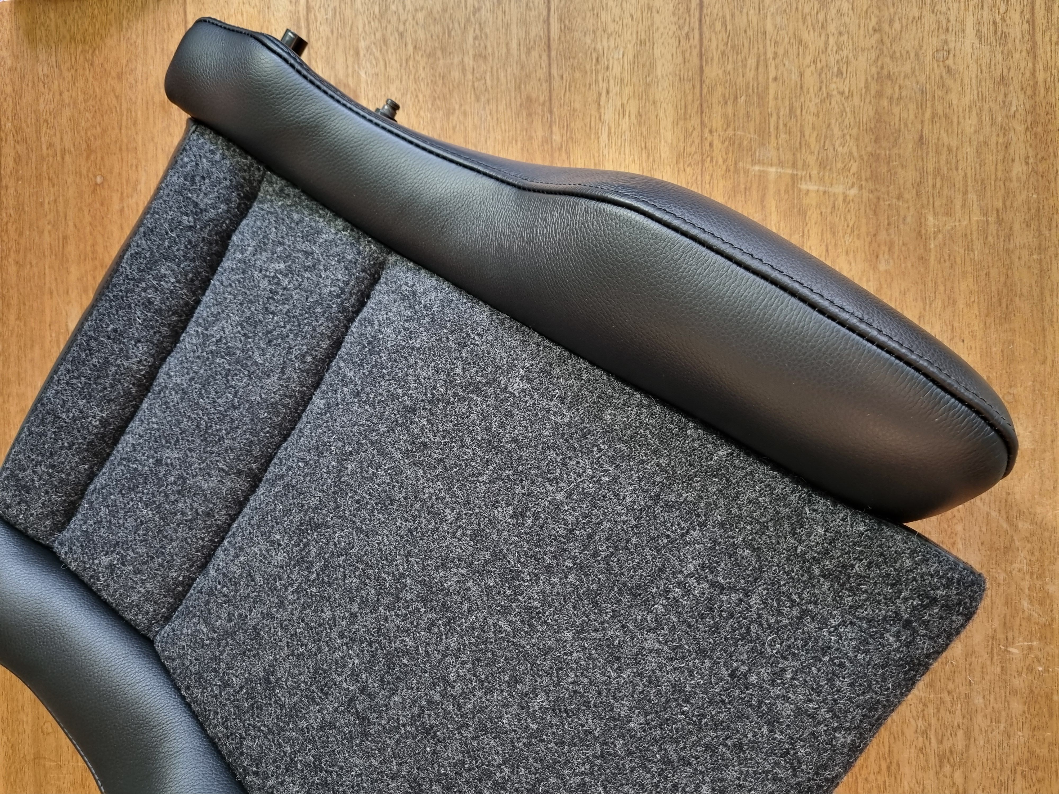

#17558

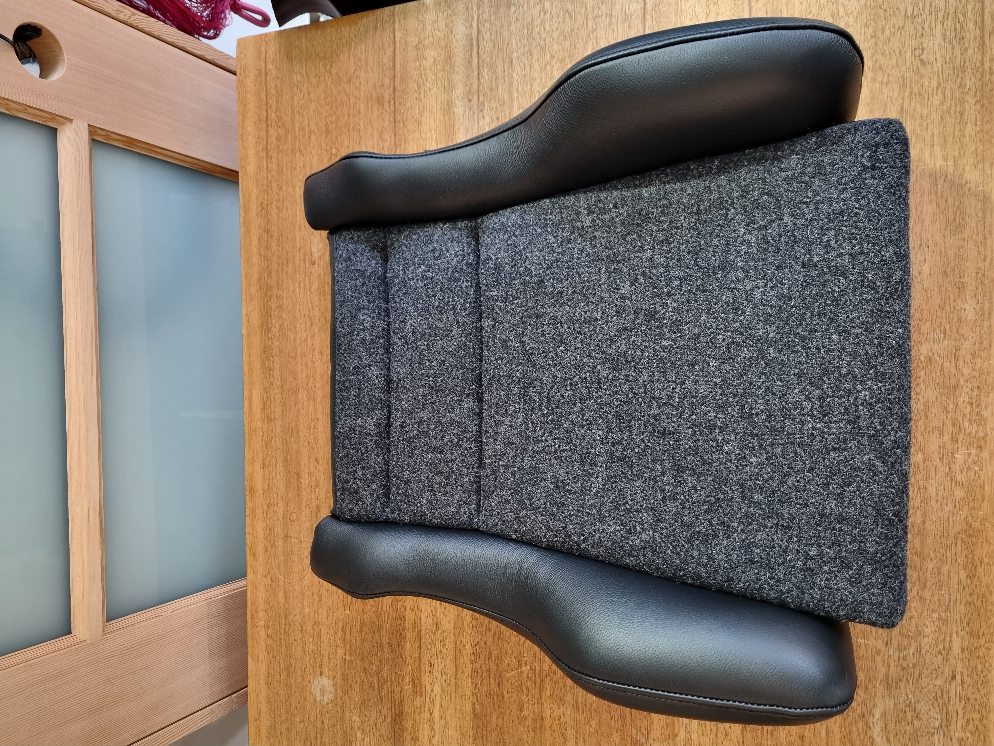

Alright, I've done the bottom seat part. All went well and I really love the look of it. The leather mixed with the Tweed is right up my alley for my 90's euro sports car.

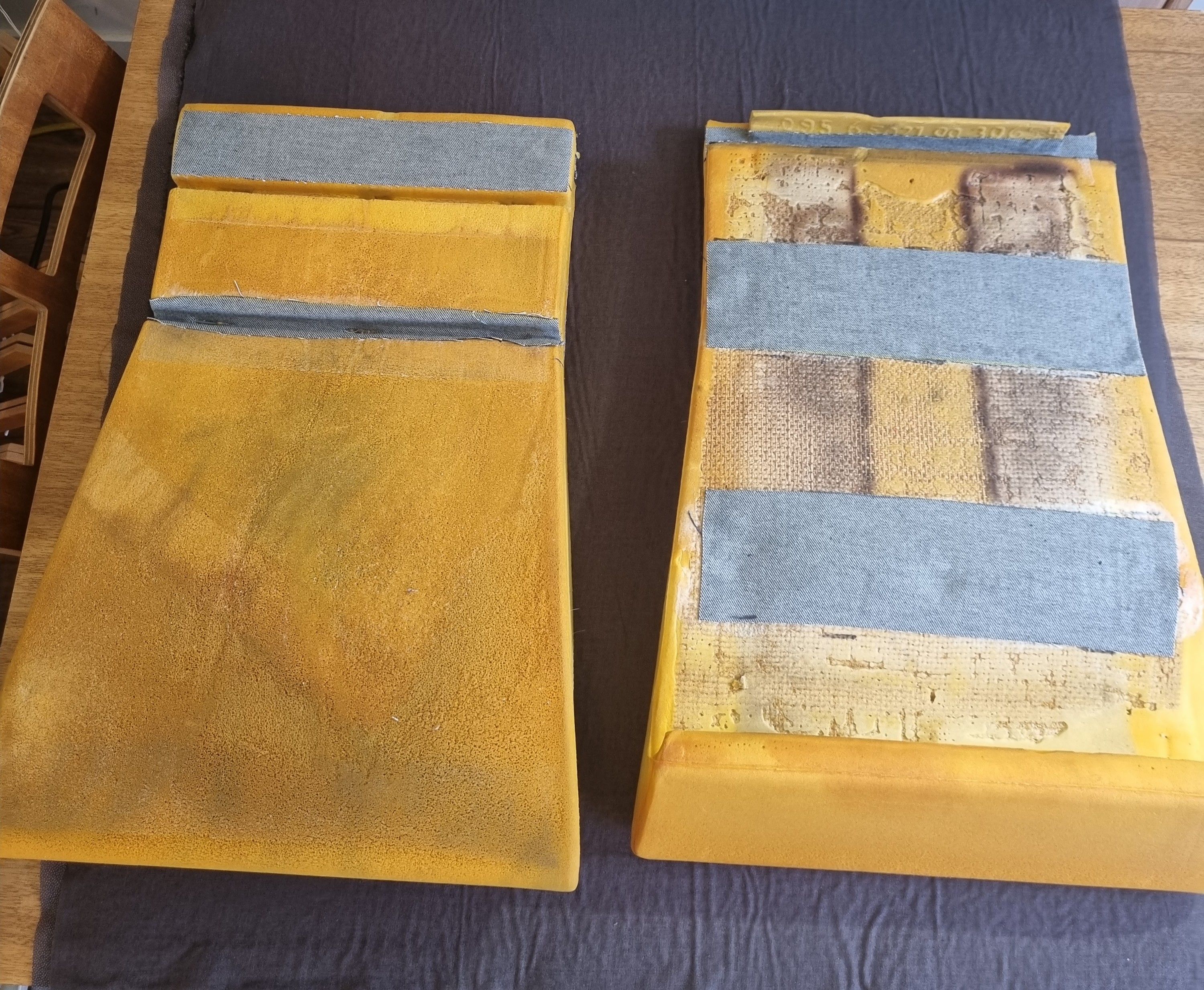

I've fixed the foam the same way I've learn watching videos on YouTube, super solid feeling.

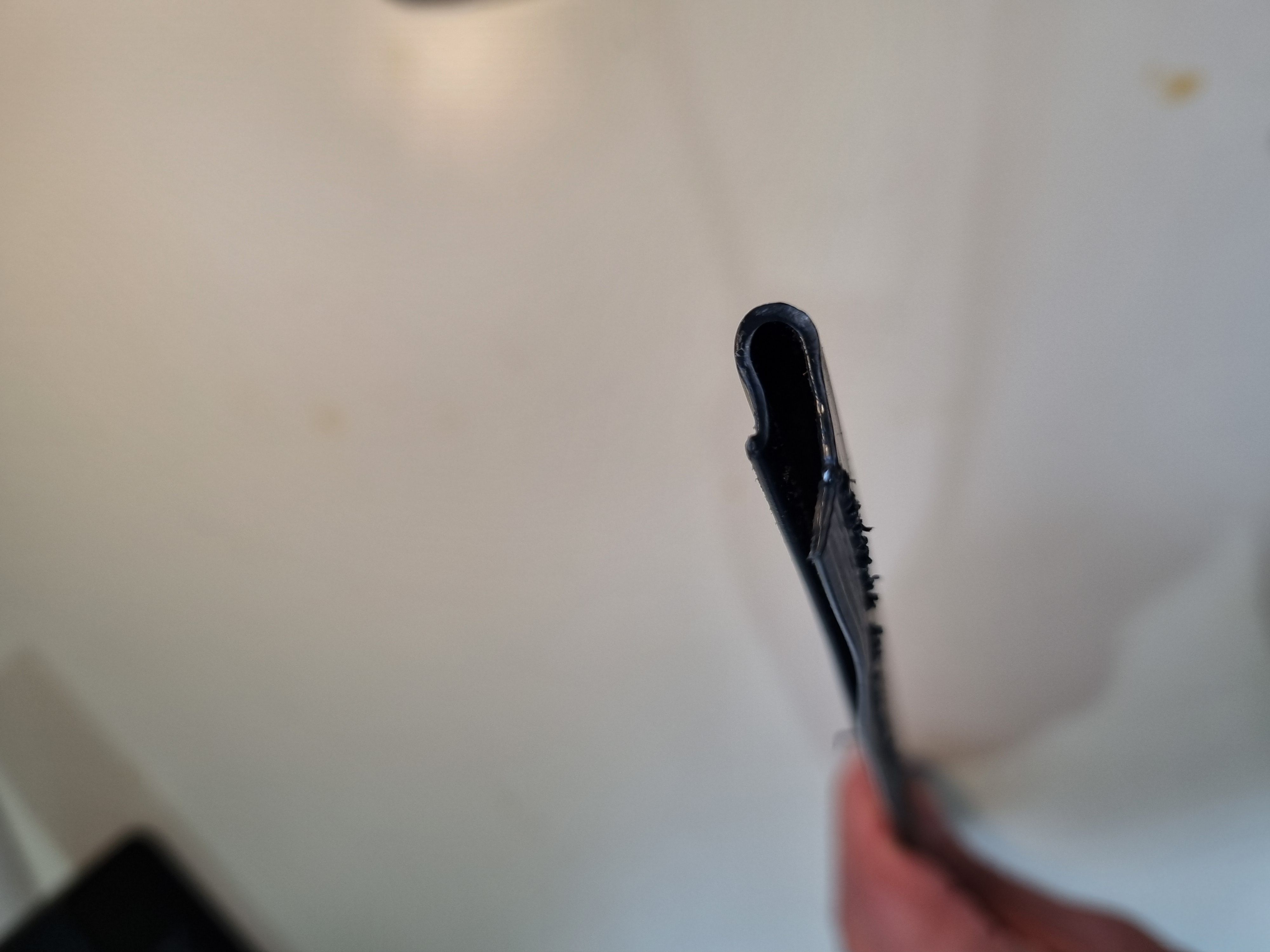

My only small disappointment is that "J" trim I think it's called (the one in the picture) I could not find it anywhere and I had to reuse the same one.

And the final product...
