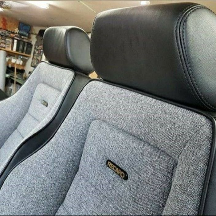

Anyways, to come back to the main subject. I have this vision of using a tweed fabric for the center inserts. Usually tweed is 100% wool and I'm thinking that it's most likely not a good idea for a summer car... To you that's a professional, what would you use? I'll be layering it with 1/4" scrim foam. I annexed a picture of what I'm looking for. Cheers!

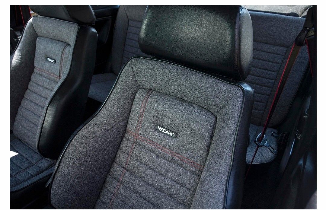

These guys have done exactly what I have in mind. But I can't really ask them what they've used right? I totally agree with their description, it's period correct for an older European car. They also say that tweed is a nice soft material and I've read its pretty thick and easy to wash.
Is it a polyester that mimics tweed or its actually wool tweed? That's what I would like to find out! Anyone here ever used or made something like on the picture?

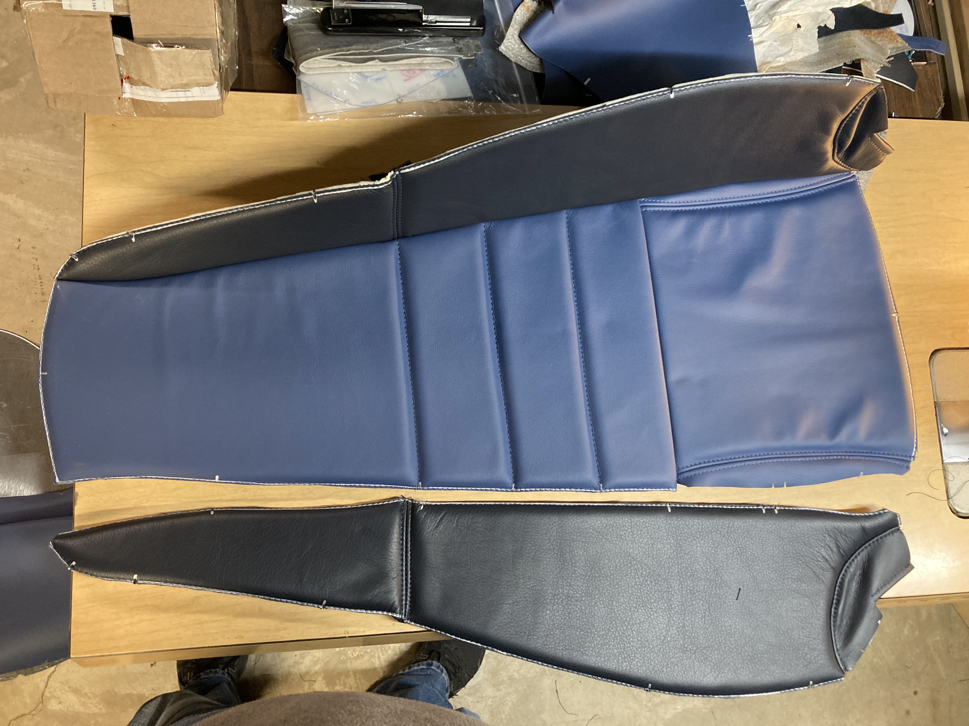

Here is a picture of my center insert with the bolsters, one sewn and the other not, both have 1/2" scrim. Honestly I would not even consider 1/4" unless it was for door cards, there just isn't enough definition.

Thanks for the compliment, the loose areas should tighten up when I install them. I'm not following when you say you're covering your repair with skrim. Are you planning on leaving the original material and adding new on top? On mine, I took the original covers apart and a friend made me patterns. the 1/2" skrim was glued to the leather and the pattern traced onto it, then it was sewn on the line and cut out. As I said it is leather, what do you mean by interfacing?

The seats are going into a Jeep CJ7, when done they will be the nicest thing on the whole vehicle! I now understand what you were saying about the 1/4". So you are repairing the foam and then covering the whole seat foam with the 1/4". My friend who has years of experience in upoholstery work suggested I do someting similar as my foam needs some repairs as well. His suggestion was again 1/2" plus the 1/2" that's already attached to the leather. His comments were that it's 40 year old foam and it has really lost its shape. With 1/4", you could always keep building it up to see how you like the look of it in varying thicknesses.
