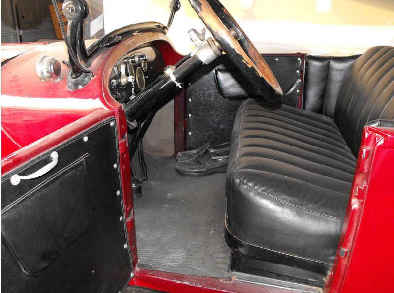

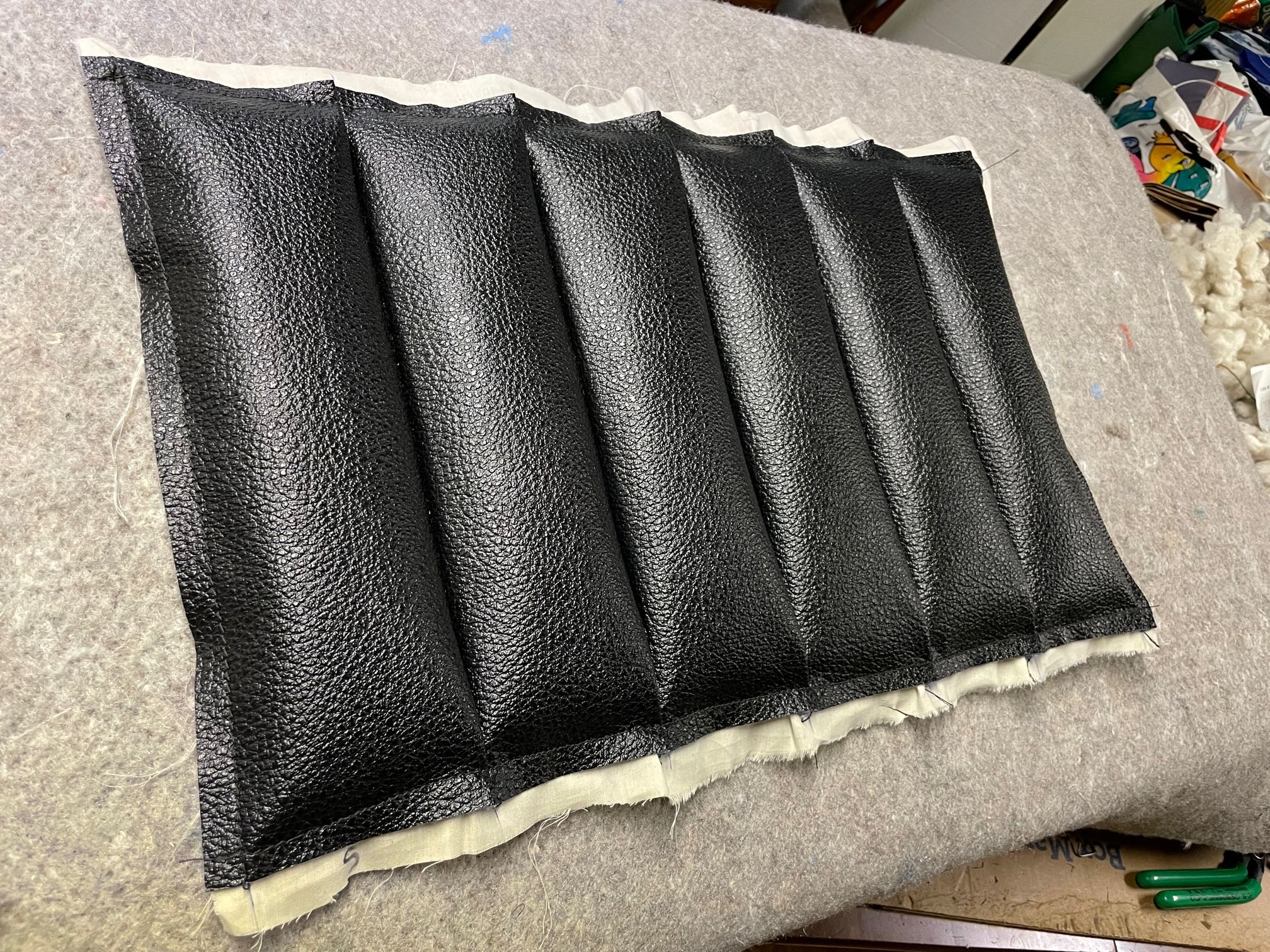

New here. I posted this in the general forum but no response. I thought I would try here since it is automotive uphostery. I discovered John's Youtube videos on doing old-fasioned stuffed pleats and have been practicing with my SInger 111. Many thanks to John for creating a great resource! I have made several practice panels with some vinyl material and am trying to match the look of the original seats in an antique car I'm restoring (1925 Dodge Brothers). The pleats are 3.5" and I've settled on RA of 3/4", BS of 3/8. I'm pretty comfortable sewing up the pleats and am now ready to experiment with making the corners on the front seat cushion (see photo of example). The corner radius is around 4 - 4.5 " and the forward half of seat is trapezoidal. My question, is it better to cut the radius before stuffing or after? It seems like doing it after will give a more accurate result but then you do have to deal with the 1" thick cotton.

Hi Lee,
