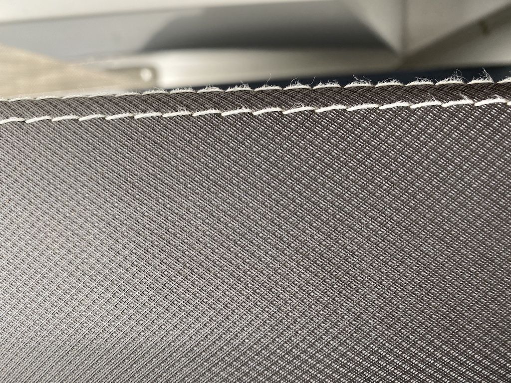

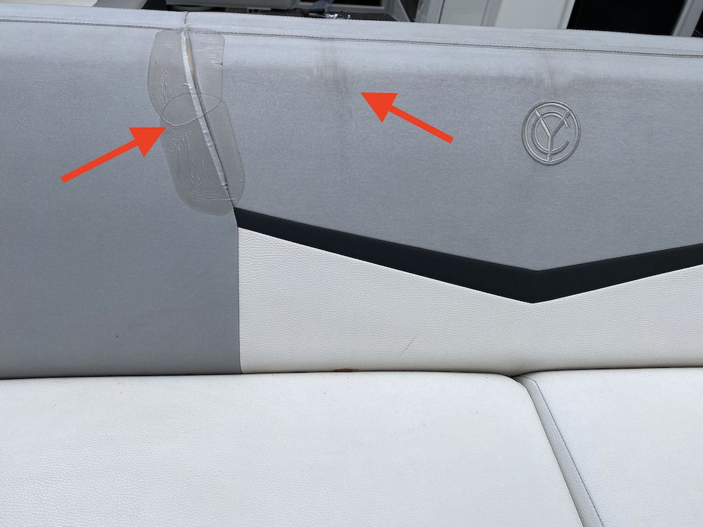

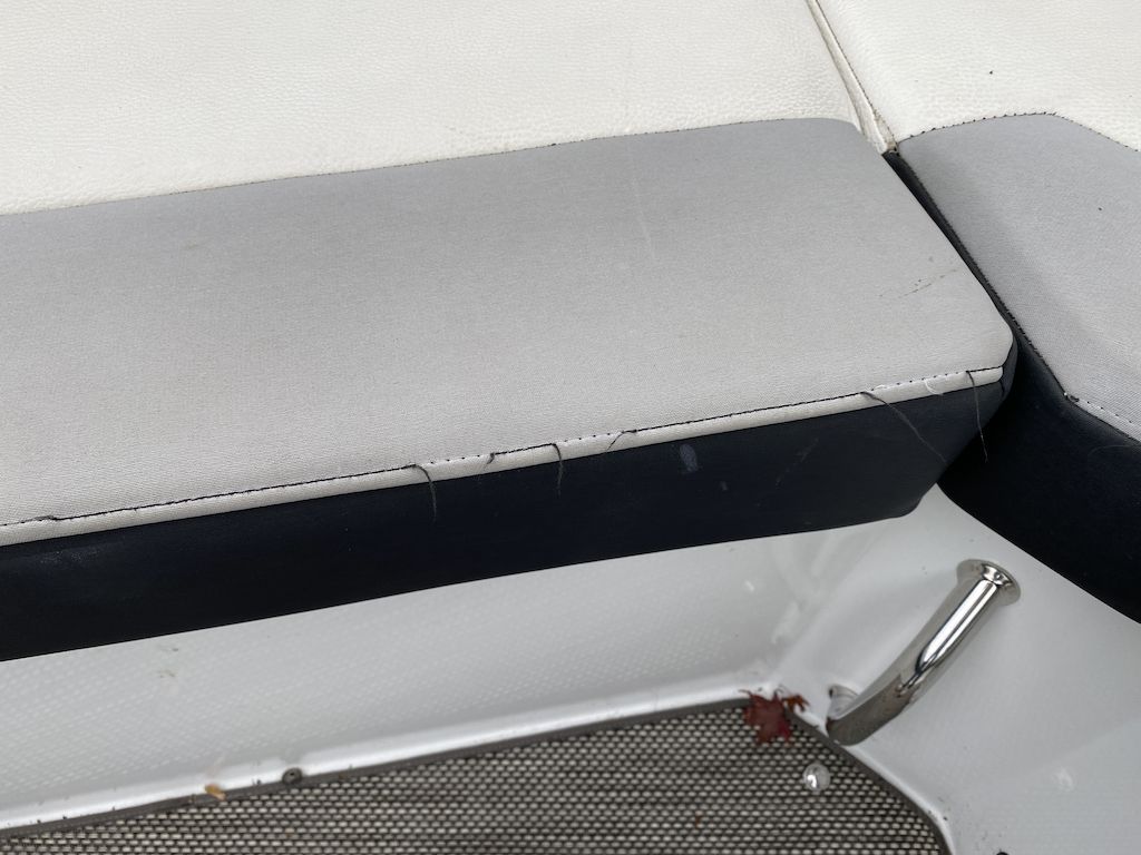

Here I go again . . . I have a new (to me) boat that is in need of some upholstery work. One interesting aspects is that the boat is only 5 years old (2016 model) and the seating is already in rough shape. Not sure if this is a case of "they don't make them like they used to" or if there was something wrong with the fabrication & materials themselves. (I suspect the thread was not a lifetime thread, because sun exposure areas are the worse of the bunch).
It doesn't really matter the cause, as I plan on re-upholstering the entire set of seating and trim, since it is all suspect.
Here are a few pictures of the issues. Mostly thread disintegration and premature wear, along with some discoloration due to abrasion.

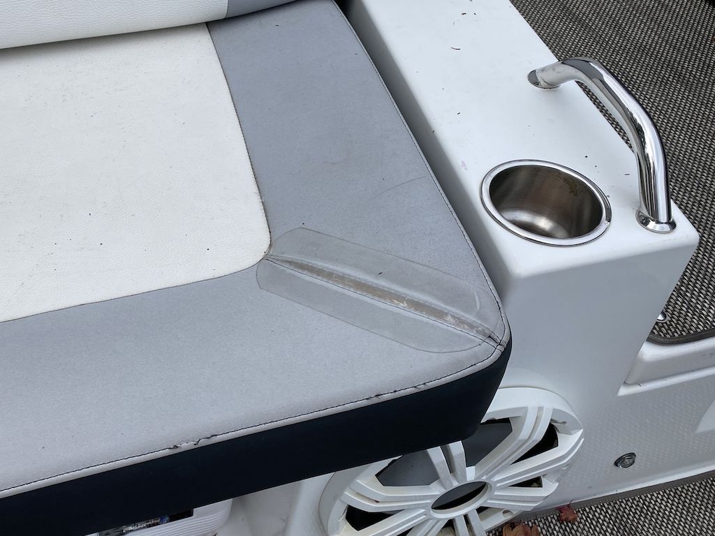

Here are a couple more pictures . . .
The previous owner (PO) placed some patches on the seams in the worst areas to prevent them from coming apart further.
There is also some discoloration in the vinyl, apparently from abrasion.
My hopes are to address the issues in a re-upholster job, getting something that will hold up better/longer.

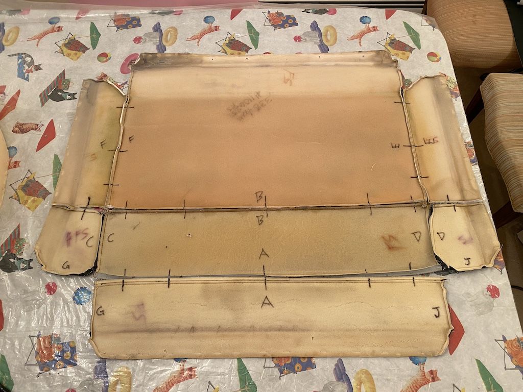

Seat Disassembly

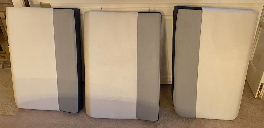

I started with the rear seat, which is one of the seats with the most issues, lots of seam separation on the backrests.
The seat is a front/back double seat made up of 6 individual pieces. 4 base pieces and 2 backrest pieces.
Here are a few of the base pieces.
IMG_2566 2.JPG (40.54 KiB) Viewed 16120 times

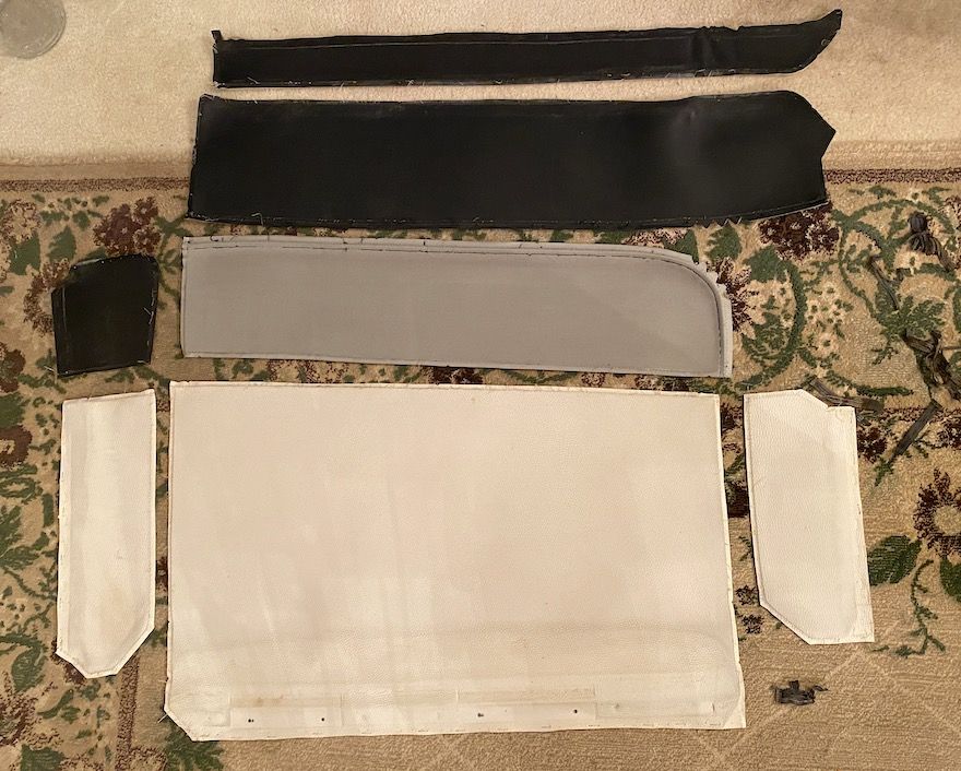

I took one of the base pieces for the rear-facing portion of the seat apart. So these panels should be good to use as templates for the new base skins, as they look to be in decent shape.
IMG_2569 2.JPG (126.28 KiB) Viewed 16120 times
The bases for the rear portion of the seat are slightly different than the bases for the forward-facing part of the seat. So I will need to disassemble one of the forward bases in order to get both patterns.
I'll have to see if the 2 backrest pieces are the same, because it would be nice to have to disassemble only one of those in order to get 2 sets of patterns.

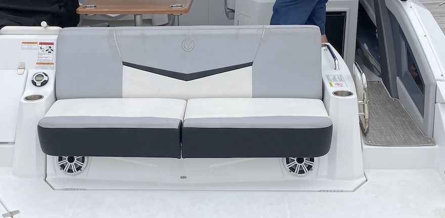

The original material was Spradling brand and the patterns used were Beluga (white), Simtex, (lt. gray and black) . The side and helm trim is Diamante (Dk. Gray), which has been discontinued.
I plan on adding a bit of color to the new skins, with a red panel in some of the backrests, as shown below.

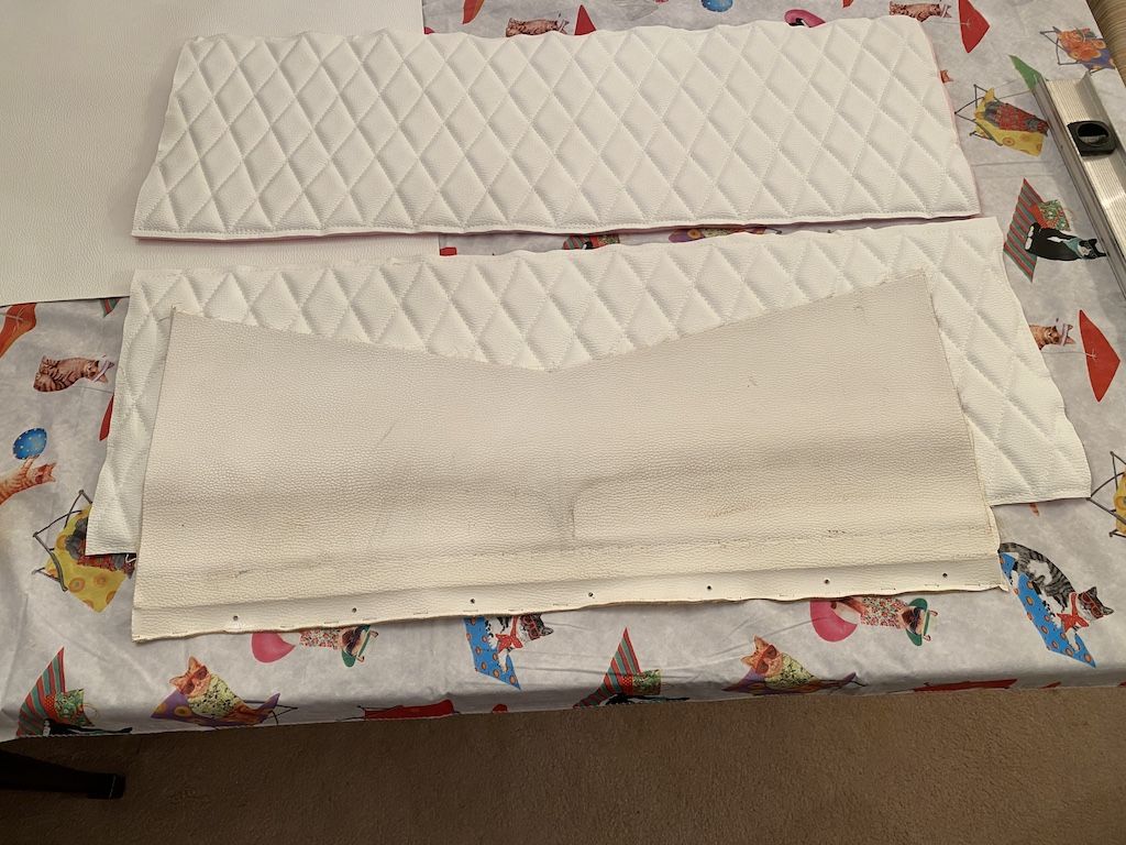

#14190

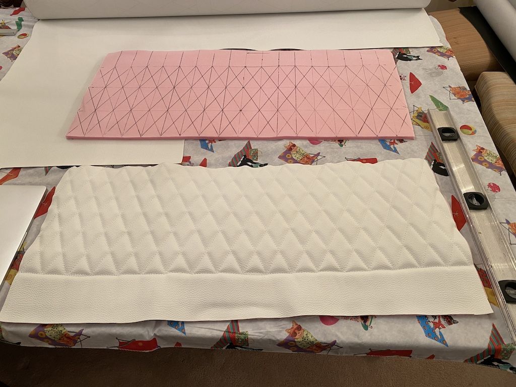

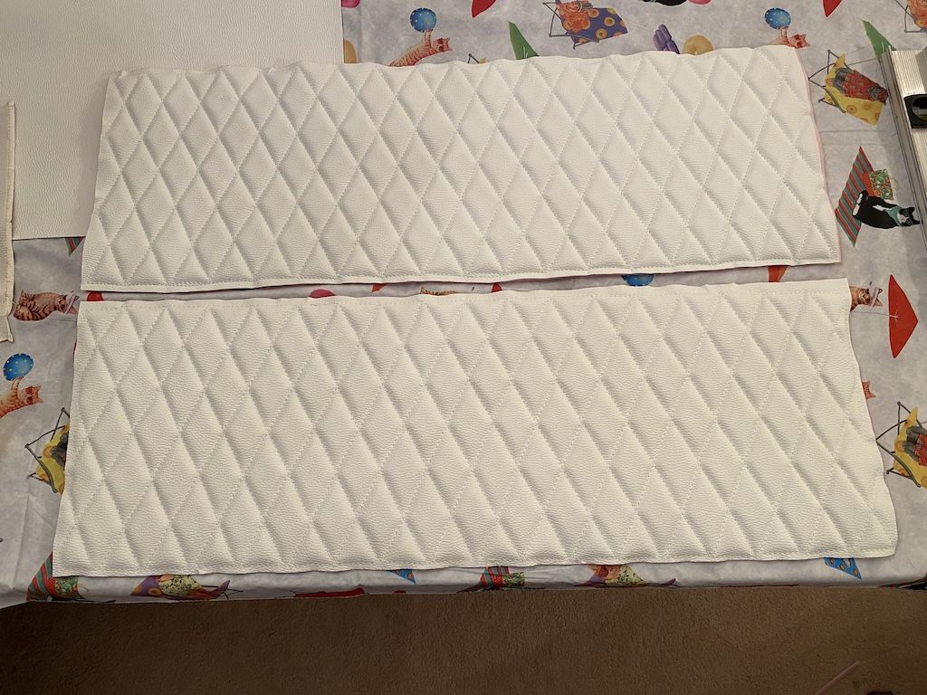

Here is my first attempt at diamond quilting a panel . . .
This panel is going to be the center section of one of the backrests of the rear seat. I had intended that the lower part of the panel would be not quilted, as it is where the upholstery will attach to the base board of the seat. However, it looks like I should go with a separate panel for the lower part sewn to the quilted panel, because of the distortion of the quilting.
The bottom of the panel is 36" across and the top (after quilting) is 34.5" across.
Question: Should I be always be making the quilted section of the overall vinyl skin as a separate panel? I'm thinking yes, because of the distortion quilting adds.
#14191
Here is my second attempt (lower one in the photo below). . .
I cut the lower (non-quilted) section off of the first panel (top in photo) and the dimensions have corrected somewhat.
Here is the piece from the backrest skin that the Diamond quilt will be replacing. I made the quilted piece big enough to allow for some alignment.

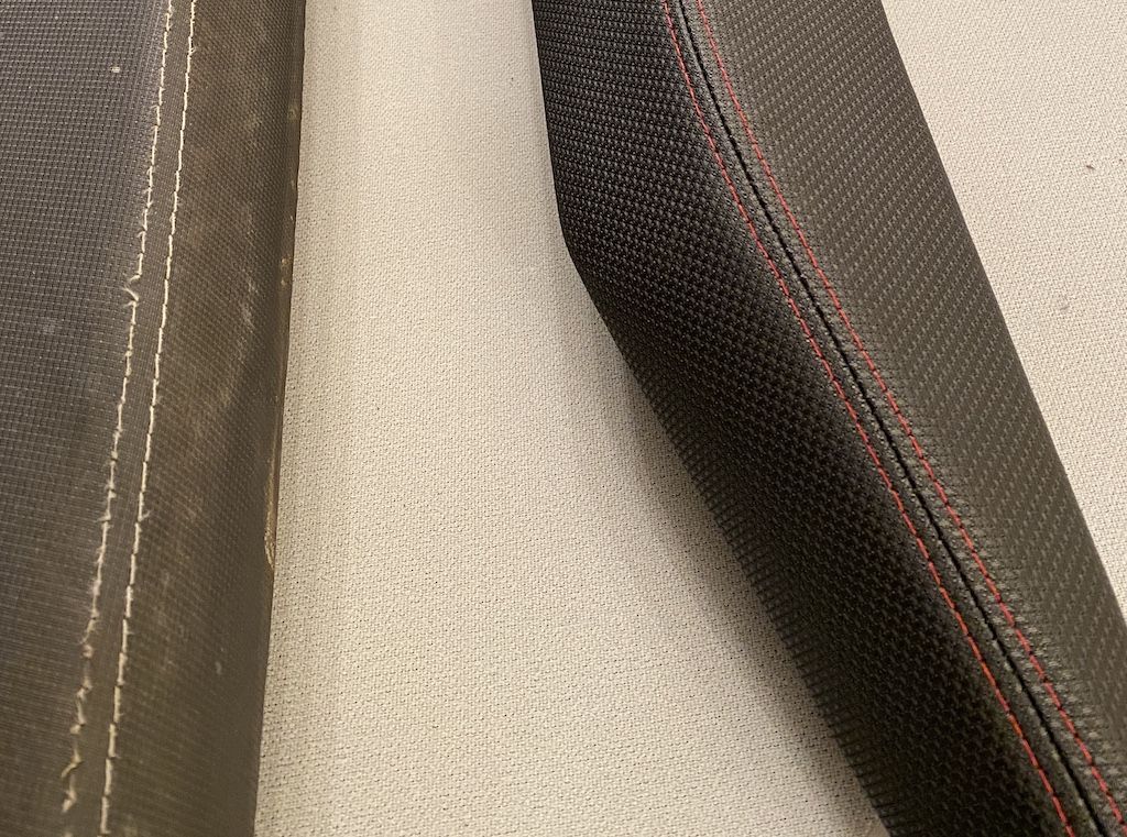

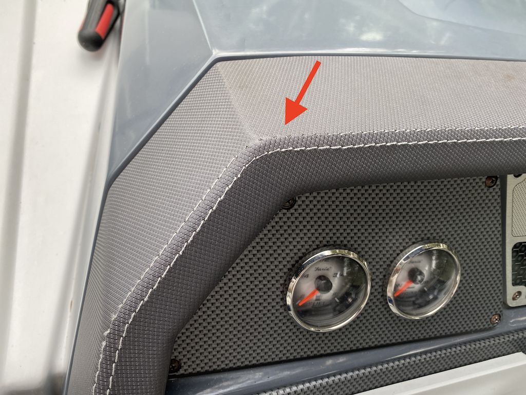

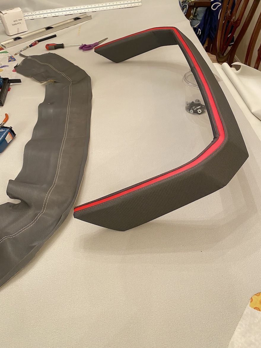

I made my first piece, which is part of the instrument panel trim. The original skin had a 'faux' french seam, and I decided to add a bit of color to the re-make of it with real top-stiching instead of a faux seam. The original skin is to the left in the picture.
I've noticed that a fair amount of the sidewall trim in the boat has 'faux' french seams (i.e. double stitch rows where a seam would typically be). Then the material is stretched to fit the shape of the trim.
I'm planning on going with an actual french seam instead of the faux seam. Stretching the material for a precise fit in a 'one-off' fashion is a bit of trial and error. I think an actual seam will make for an easier (and better) fit to the trim piece.

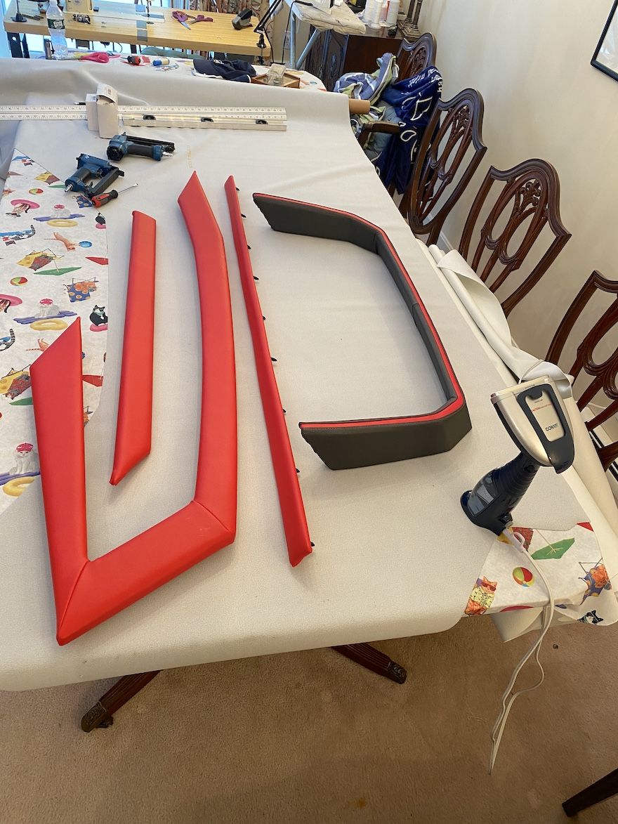

Update . . .
More sidewall trim pieces. These were originally gray and now will be red.
The vinyl is Nautolex/Boltaflex Colorguard in 'Tomato'
Interestingly enough, they use a similar type of 'push-in' fastener as many automotive interior trim pieces.

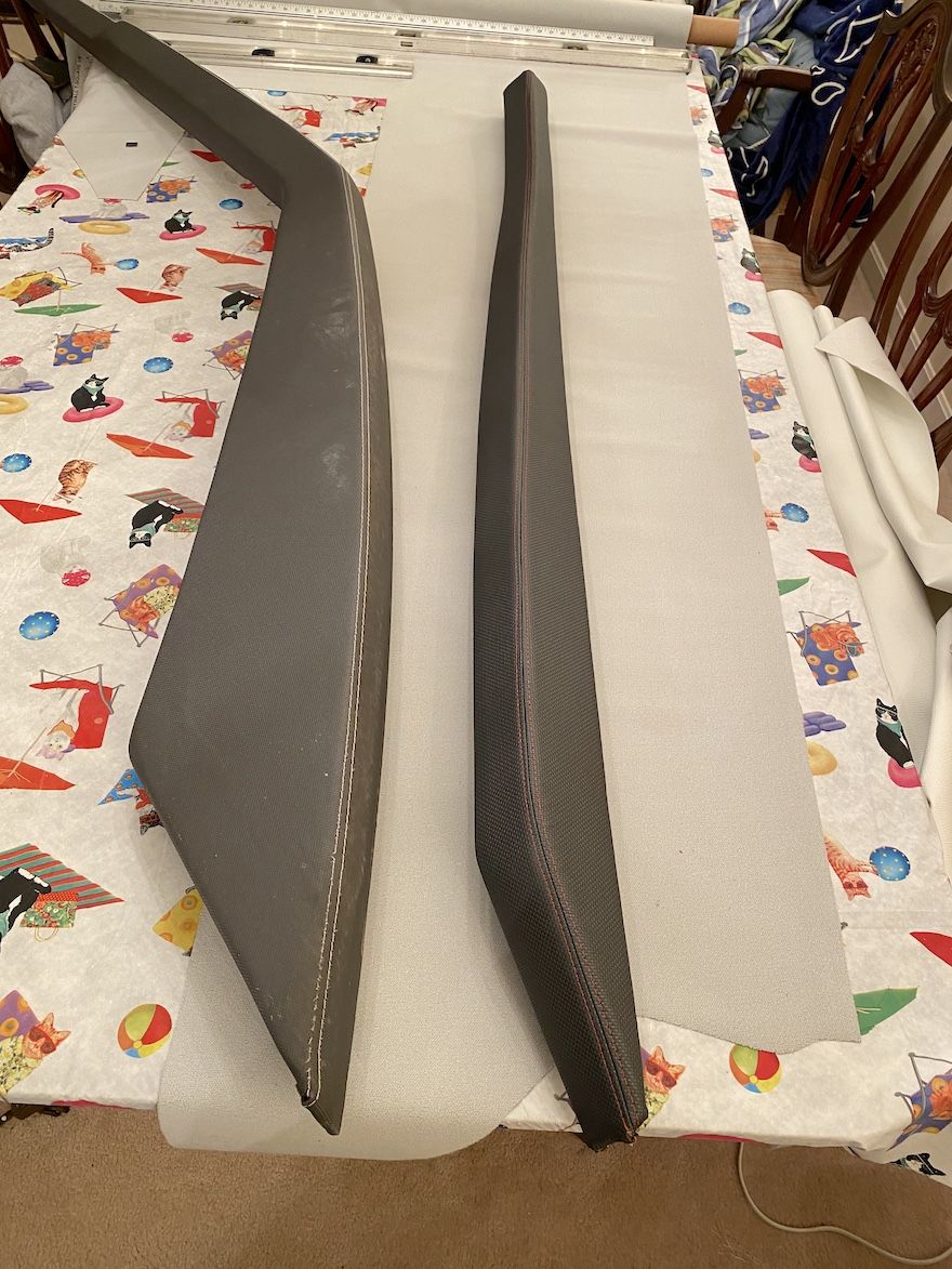

Here is my first attempt at a french seam. The boat originally had 'faux' french seams, which looked cheap and the thread has not held up well.
Here is an original piece (left) and a re-make of a similar piece (right) with a true french seam (or double stitch seam)
Here is a close-up of the seams.
IMG_2678 2.JPG (223.37 KiB) Viewed 15153 times
I have the skin made for the larger piece in the picture. Just got to install it to the foam & backing.
there are a few other places on the seats themselves that have french seams. So, I'll be doing those as well.

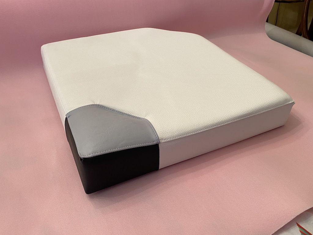

#14285

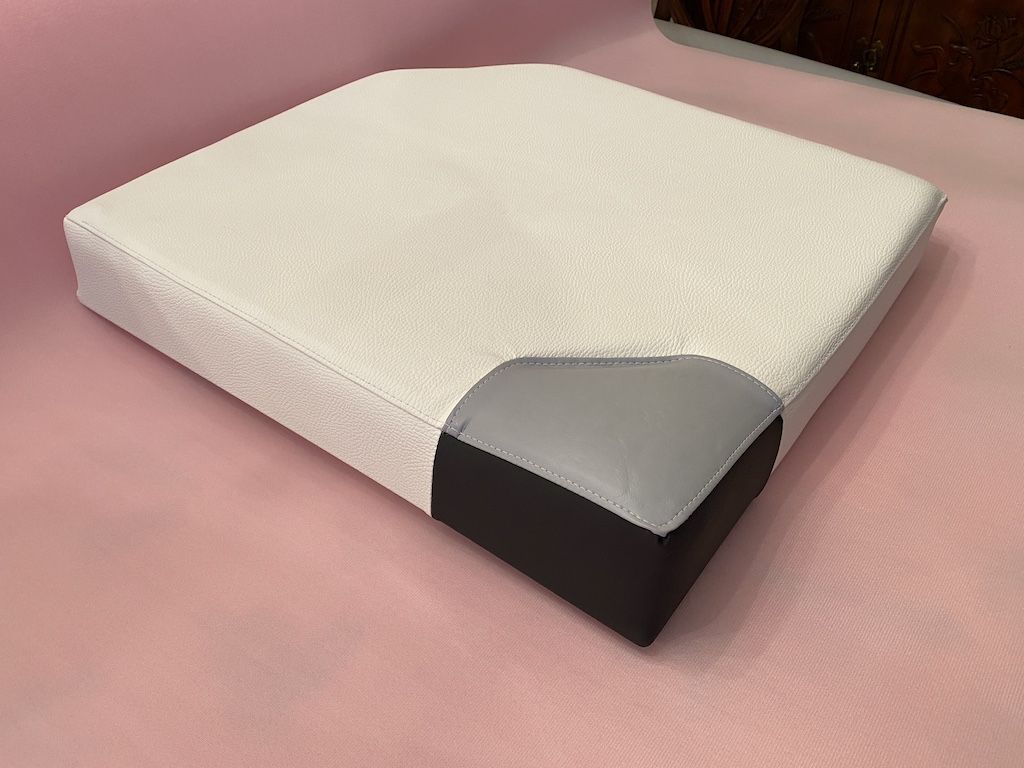

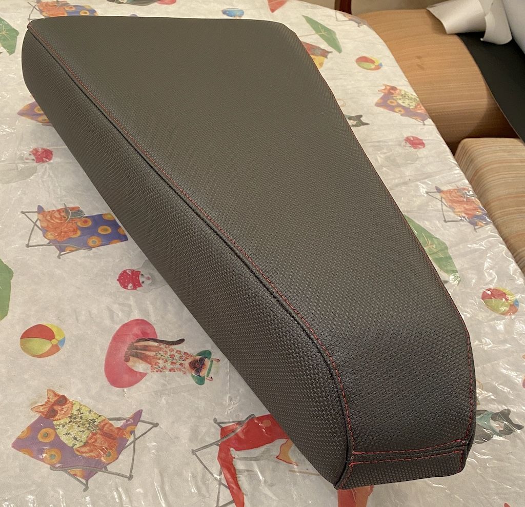

First of the seat cushions is done!!!
This is the corner piece of the aft seat base (port side). It is one of the smaller pieces, and I am finding the smaller pieces can be the most challenging :grinning:

So on the square cushion you have torn apart in the picture above. I would probably estimate around 3 hours start to finish but I have done 100s of boat cushions and parts. This also varies based on the complexity of the cover, how much top stitching, condition of the original cover to use as a pattern, custom changes, ect
As for ways to save time... practice and more practice is the most important but other tips that come to mind are:
- learning to trace out you patterns seam allowance by eye and not use a guide.
- Instead of un-stitching each piece many times you can take your scissors and cut down the stitch line removing the seam allowance. This is really easy on single reinforced and french seams. This takes practice to not cut in to you pattern on accident and you have to use best judgment on when you can do that. But this can save a lot of time
- Working on all of the cushions at the same time. When I do boats I remove all the covers in one step, Disassemble and pattern everything in one step, cutout all in one step, Back with foam, then sew , then install all in one step. This saves massive amounts of time in cleaning, switching tools, ect... Just be careful to keep everything is designated piles to not mix up the patterns.
- What staple puller are you using? I find that the CS Osborne ones dont work near as fast as a tack removal tool sanded down to a knife edge.
- Depending on the quality required of the project you can use a multi tool to cut the staples flush with the board instead of pulling the staples. This can save a huge amount of time.
