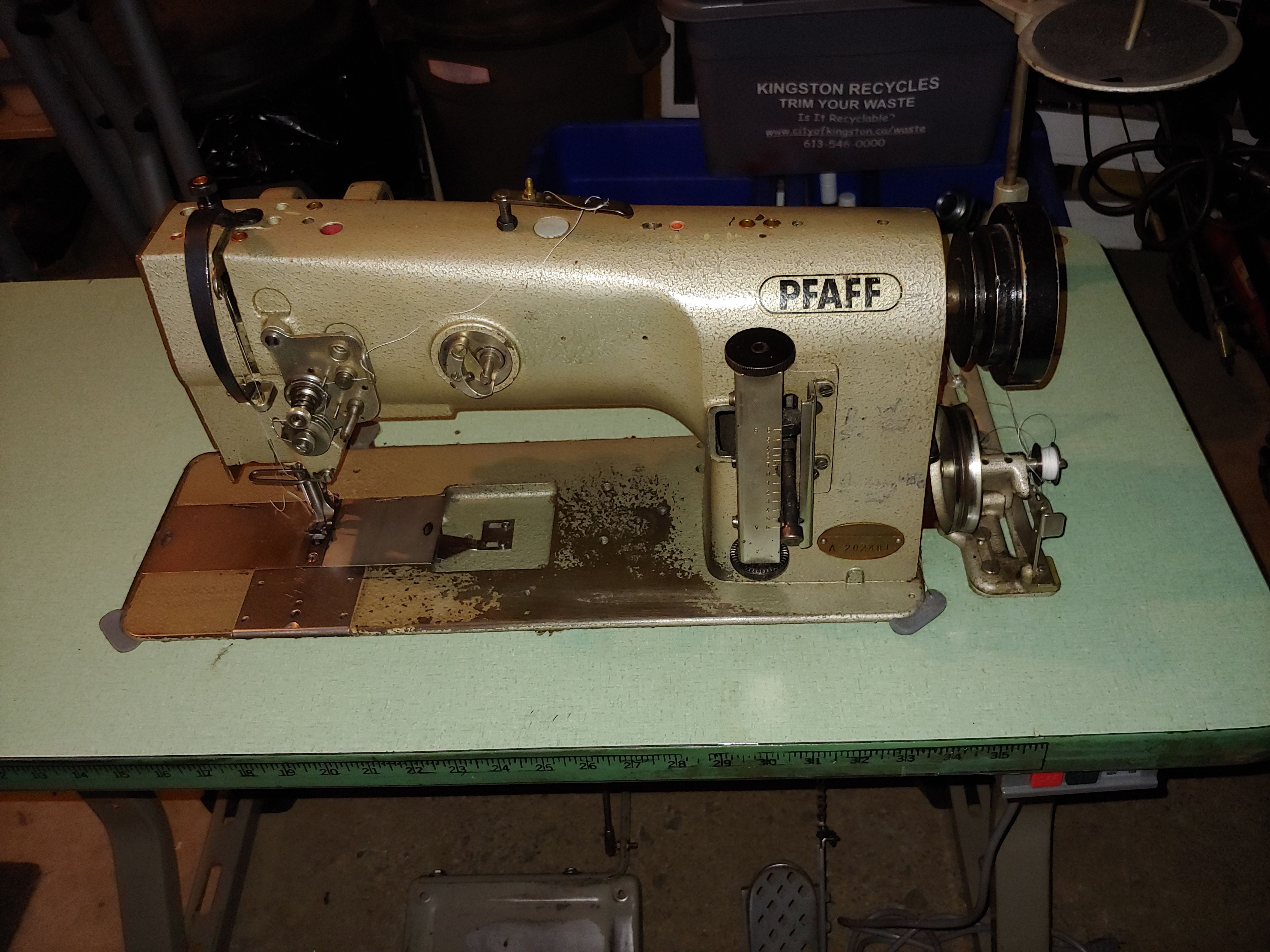

#12363
Wow, I've already switched out both pulleys on this turbine to change it into something that doesn't feel like its going to suck the material thru and launch it like a ballistic missile. You guys weren't kidding when you said that you need to feather the pedal on these old machines to slow them down. I can now at least manage to make it work. I plan to extend the clutch motors (activation?) bar to give me a little more control. I'll eventually either change it to a servo motor or like the idea of devising a system with reduction pulleys to keep the torque at a maximum level even at super low speeds. It'll eliminate any low speed stalling.
