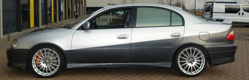

I have started on the upholstery of my Toyota Avensis. This car has been swapped from 1.6 to a 2.0 turbo engine. Drivetrain is swapped from FWD to AWD. MoTeC standalone ECU, Garrett dual ball bearing turbo upgrade, W/A top mount intercooler swapped to A/A FMIC. 356 mm 8 pot front brakes, Fidanza flywheel, Mishimoto radiator. Painted inside and out in 2 tone with House of Kolor Rainbow flakes through the clear coat. RPM gauge changed from 8 to 9k. Mocal oil cooler and filter relocation. Dolby 5.1 and DTS audio. Sparco seats.

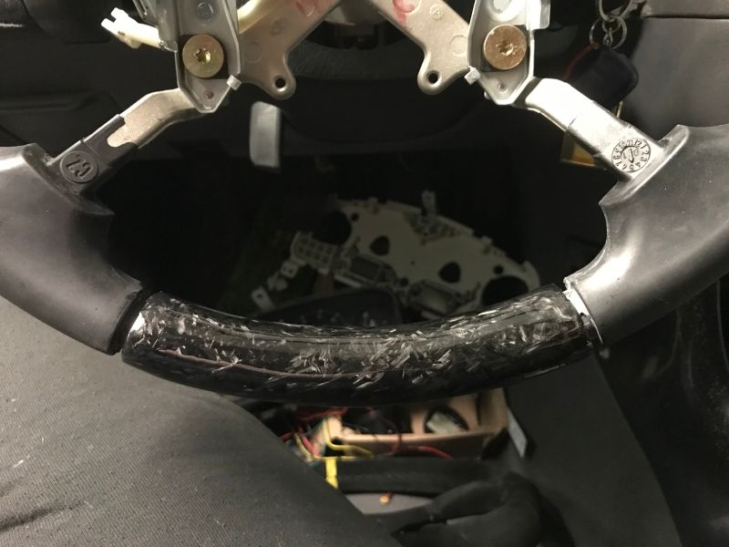

I am working on the steering wheel at the moment, made the bottom of the steering wheel in forged carbon

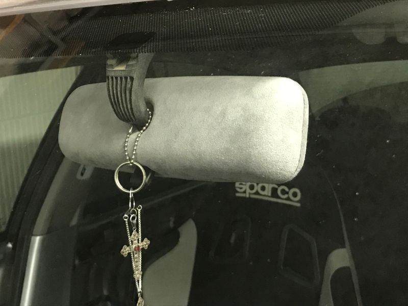

I wrapped the Rear view mirror in Alcantara.
I am thinking of doing the A, B and C pillar, and headliner in Alcantara as well.
I want to flock the dash in black to remove sun reflection in the window.

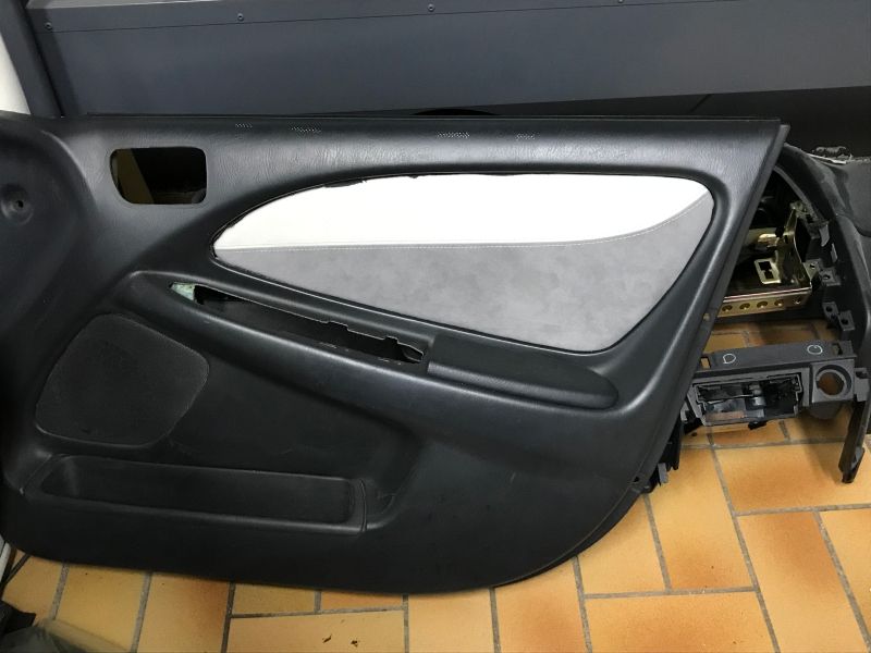

The line on the side of the car is used on the insert of the doorcard. (insert is not glued in place yet).
I will post some more pictures later this evening.

The bottom of the steering wheel in forged carbon

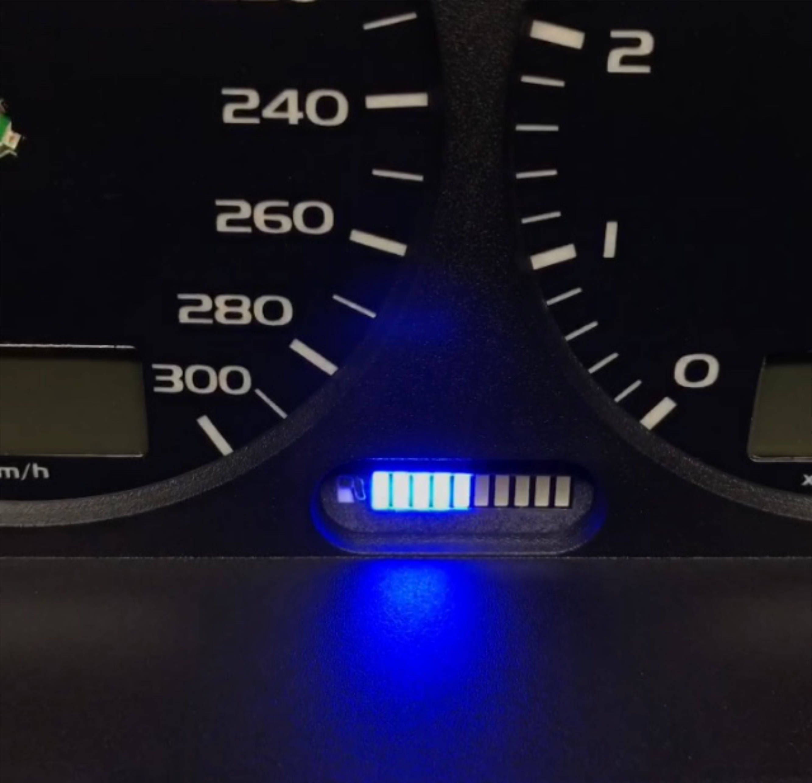

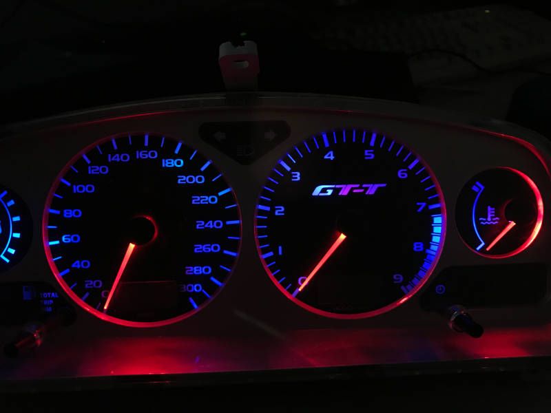

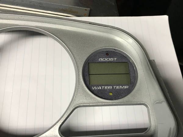

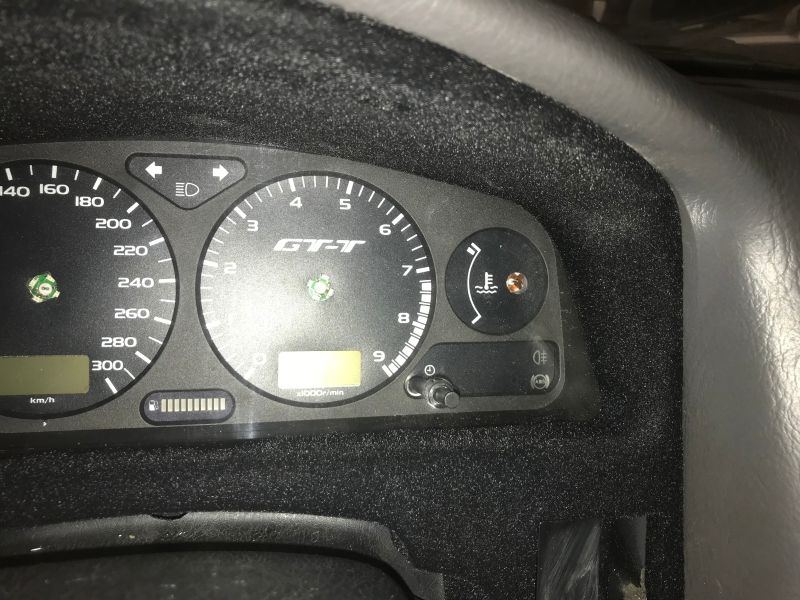

The dials with 9000 rpm tacho, fuel gauge is deleted and a digital one installed in the bottom of the cluster, engine temp gauge is removed. At the fuel and temp gauge i am now installing SPA dual digital gauges.
avensis gauge cluster lit up.jpg (34.35 KiB) Viewed 44363 times

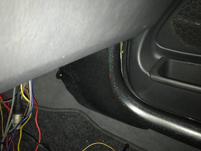

Flocked the kickpanels black

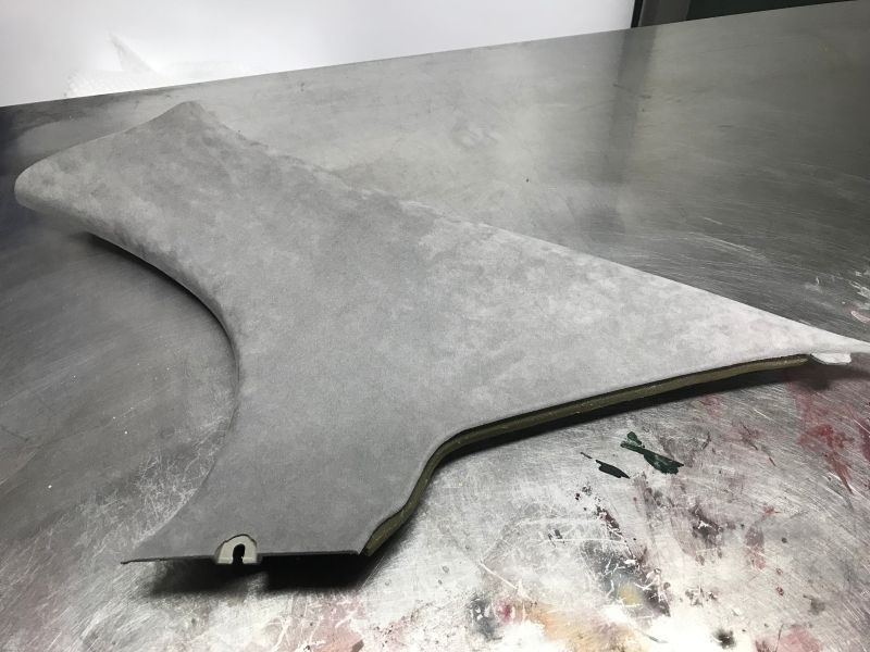

Today i took out the C pillars and the rear deck to see how the rear speakers can be installed. Normally the woofers go in the doors below, but since i am running DTS i want them in the rear deck so the time alignment for the speaker will be much better when the tweeter and woofer are on axis and i do not have to do a ton of work on the doors to get them to sound OK.
The speakers which will be mounted are Boston Acoustics Z6, and a Pro60 for centre channel.
The normal 3rd brake light was disconnected a while ago because a 3rd brakelight is also in my rear wing and i am not allowed to use both at the same time by law.
The hole for the 3rd brake light on the rear deck will be closed and reupholstered as if it was never there. I am going to reupholster the A B and C pannels with a light grey alcantara.

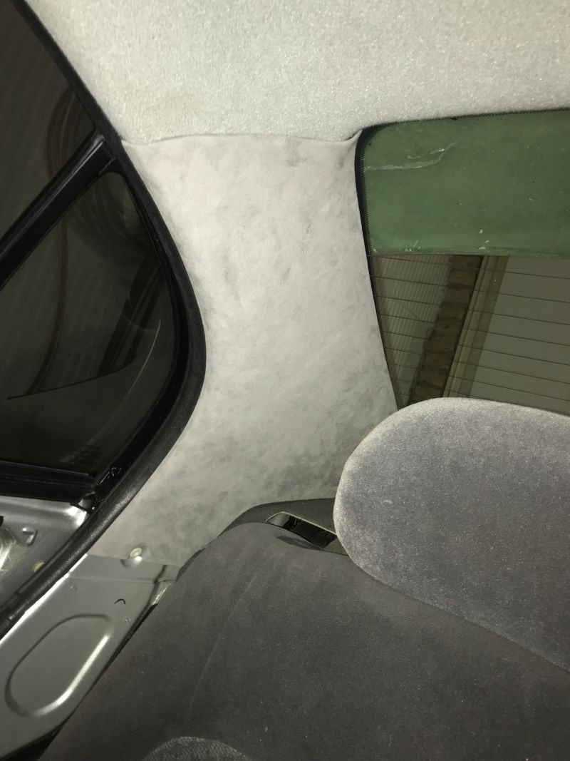

Wrapped the C pillar in Alcantara

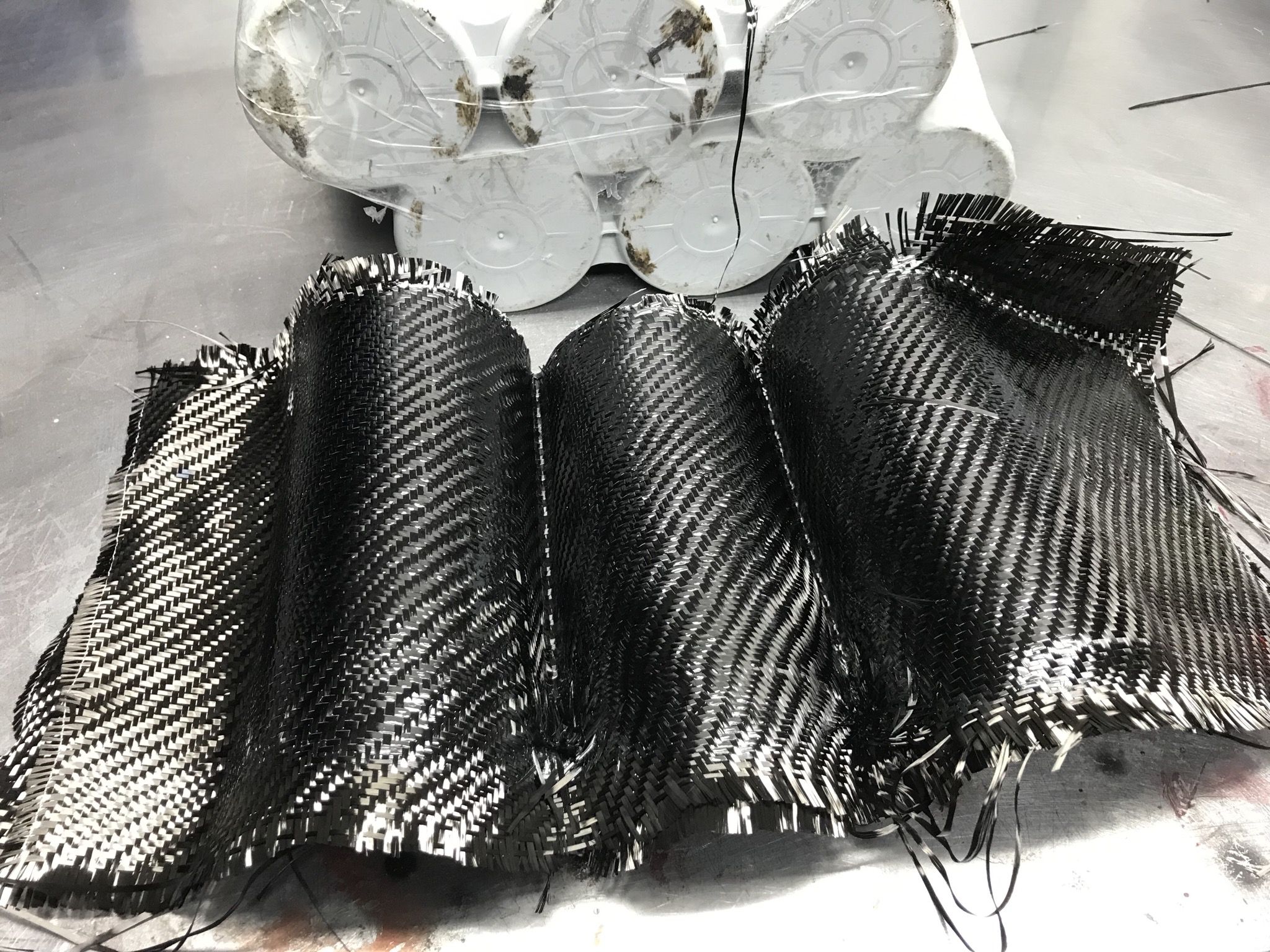

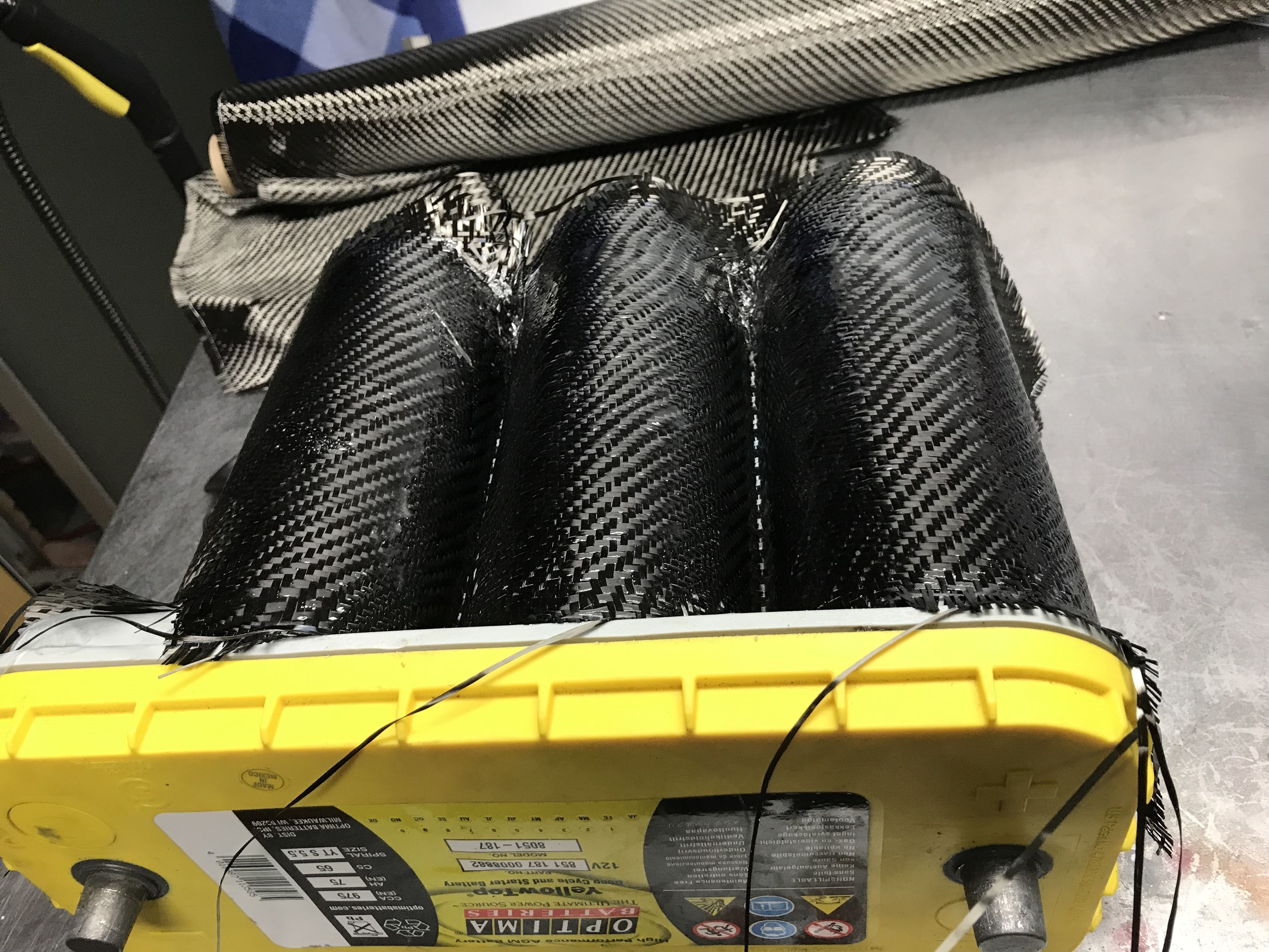

Making carbon fibre bracket for the battery.

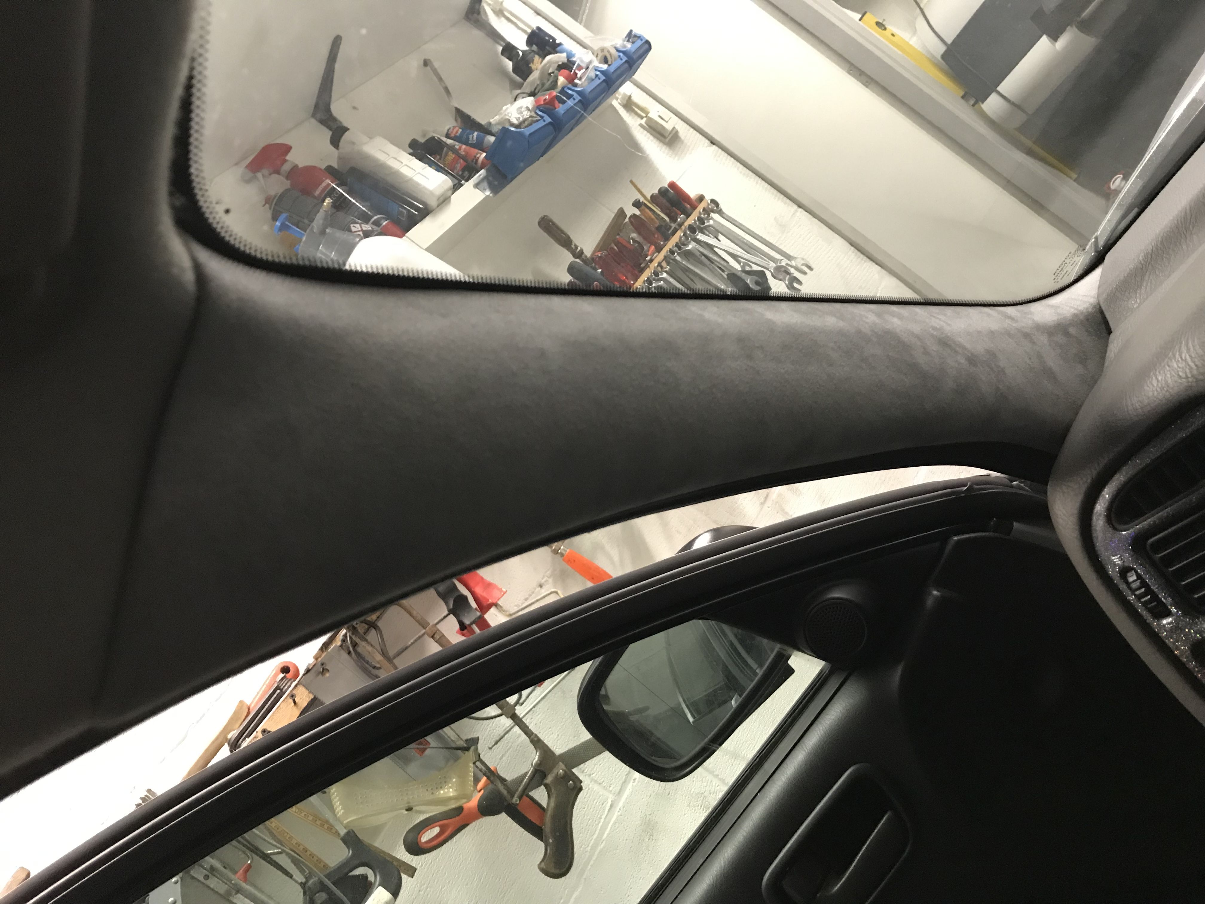

Wrapped the a pillar with alcantara

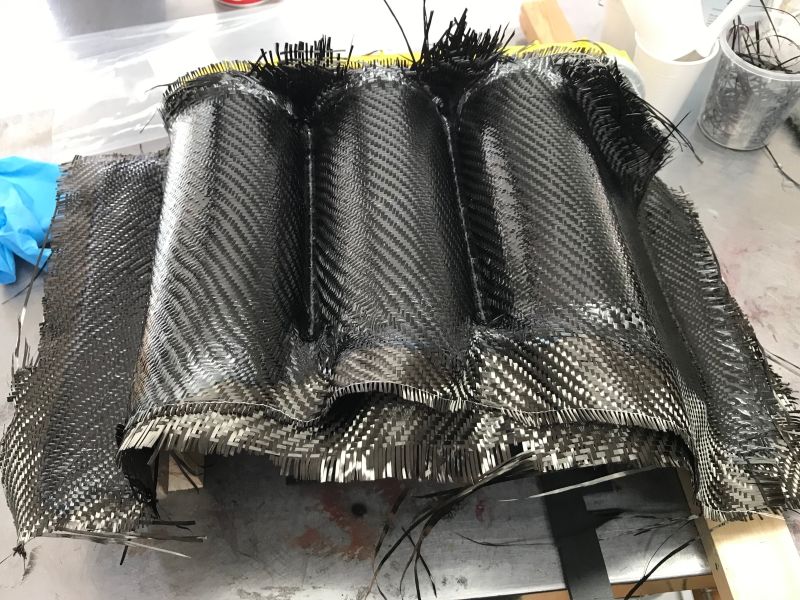

First 2 layers of carbon are almost dry.

#10093
Added layers of Carbon to the battery bracket and made a flange at both sides where the bottom carbon piece can bolt on to.
When it is fully dry i can cut it to the desired shape.
