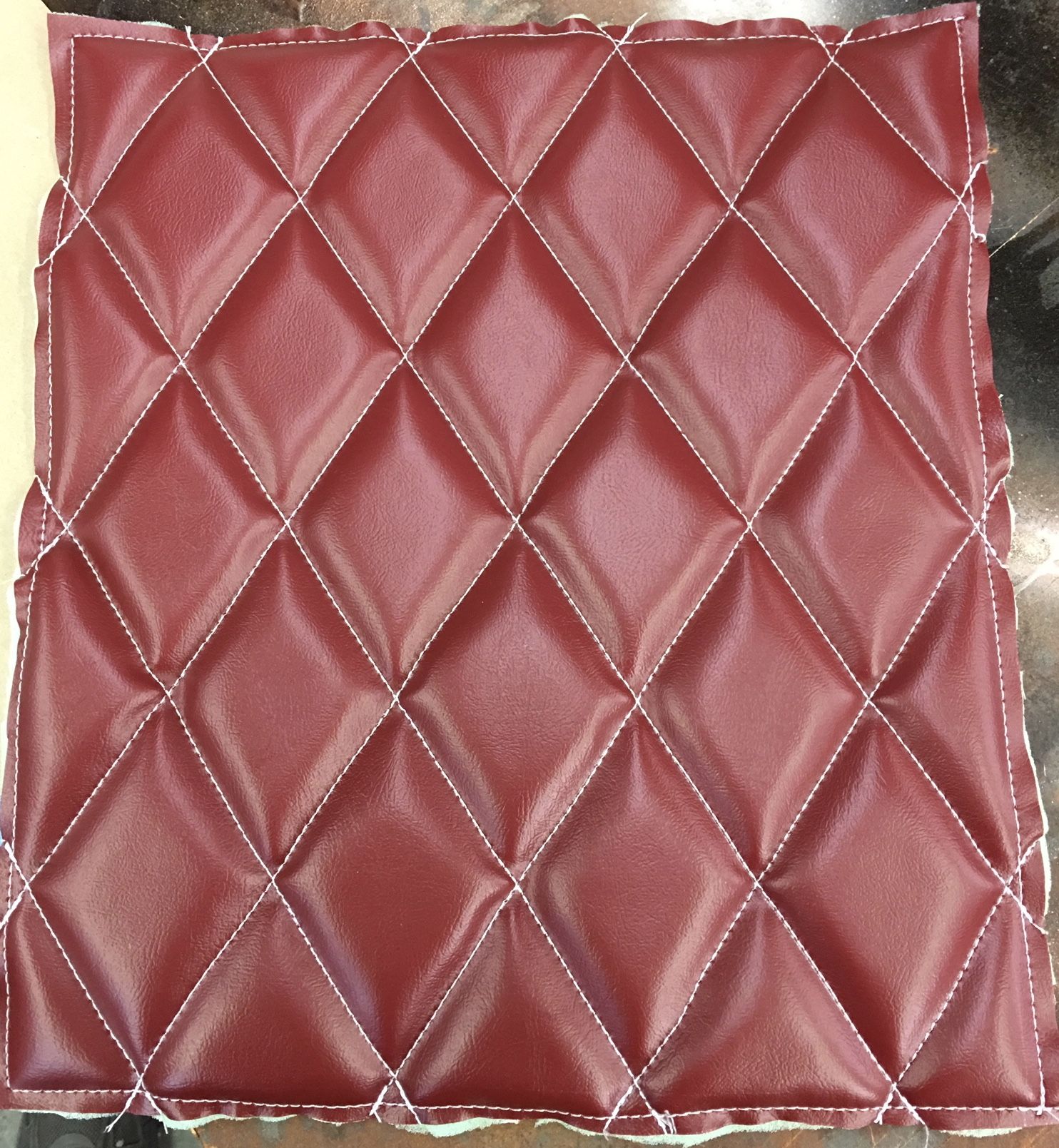

I just did a practice piece. Not perfect, but it came out ok. I laid it out wrong once, and had to think about how @john showed doing the layout in the videos. I had forgotten to start from the middle on the sides (longer dimension) but once I figured out what I had to do it was not hard. I used a silver space pencil for the layout, that’s my new favorite tool. Crisp lines and wipes off easily once I’m done sewing.

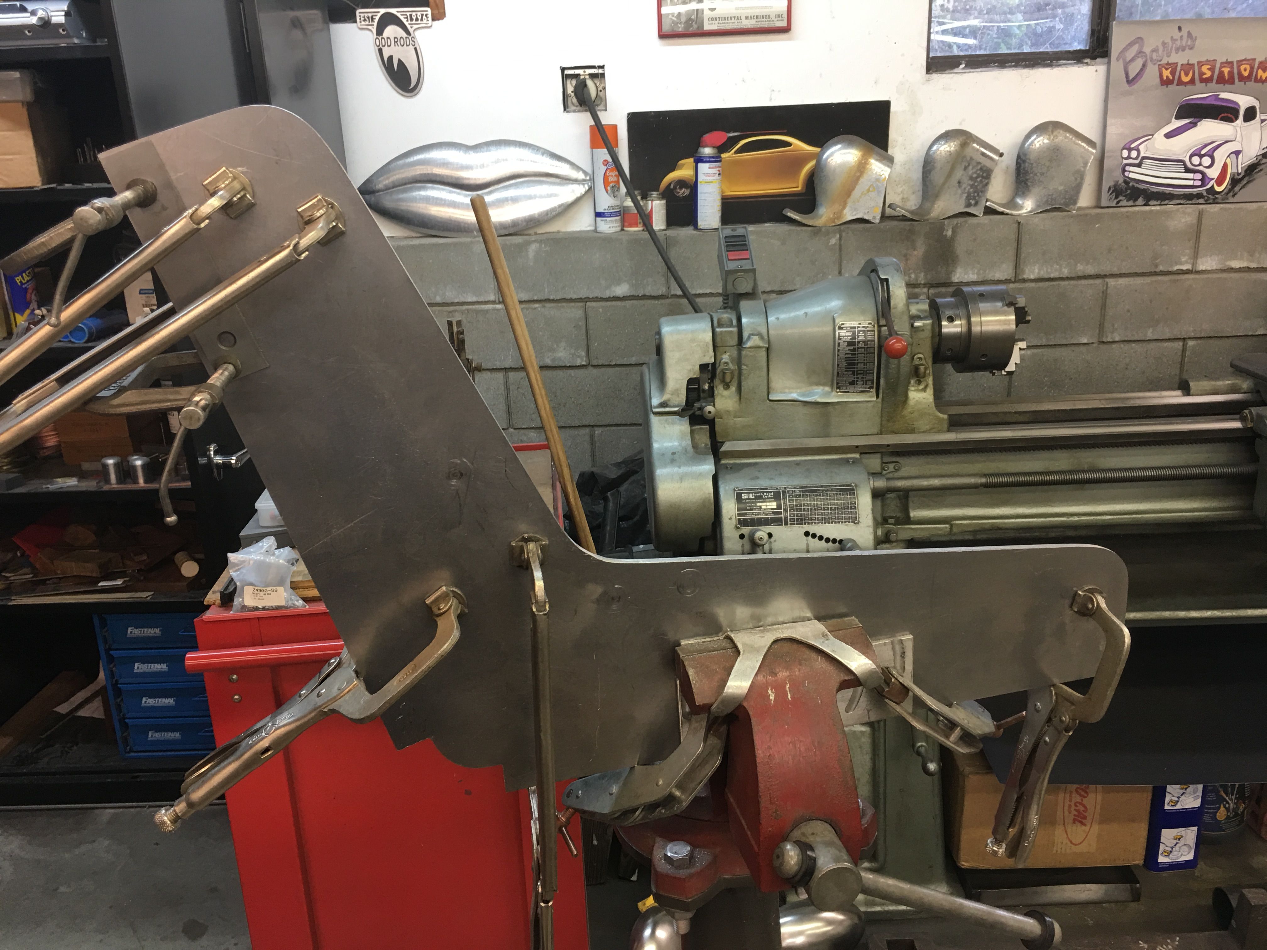

More practice panels to do, but I\I am working toward making a pair of “low rent bomber seats” for a hot rod. It is just a practice project. I learn more making real things than just random sample panels. I have the four sides (for two seats) cut out of 16 gauge steel. I need to figure out how to make the edge that will be exposed “not sharp”. My preference would be to have the edge “wired”, rolled around a 1/8” steel rod, to give it a finished edge detail. So I’m off to play with metal for a while to figure out that operation, then I can lay out the details for the seat sides.

Thanks John. A few wobbles on the stitching, and I can see that I need to pay more attention to how the material is gathering into the pleats because there is some weird bunching in places. Good learning experience though.

I did a couple of experiments on wiring the edge yesterday. That 16 gauge is stiff stuff. I didn’t quite get a successful edge, more experimentation required. I was able to turn a small flange neatly, which is the first step in wiring an edge, but rolling it over the wire by hand was a struggle. I’ll post some pics next time if anyone is interested (and it doesn’t look like a two year old did it).

Ok, I know this sucks, but it was good sewing practice. It was also hard.
I started at the top. First stitches were too short. Then too long. I finally set it to 6mm, which should be 12 stitches on the short side and 16 on the long, but every segment seemed to be slightly different. I know if I wasn’t exactly on the layout lines that would be an issue, but the amount of tension on the fabric as I feed it seems to influence it too. And I think the foam and how much it’s compressed may affect it.
Anyway, kind of fussy work, and certainly not ready for prime time.
I also lowered my seating position at the end, that helped me follow the layout lines. Next time it will be better. I think I will use 1/4” foam since it ends up so compressed anyway and the thickness with 1/2” foam makes it harder to follow he line.

#3728
I tried another panel. Still not good enough, but I felt a lot more in control on this one. Good practice. I want to try this with bigger thread, maybe 207.

#3735
@Joemcglynn
Those are pretty fancy stitches. Are you drawing the template out by hand?
#3741
Compare to sample above I think it’s just wow. I wouldn’t even try it yet. Seriously, first try is horrible, this one took me a minute to find mistakes. Looks very good
