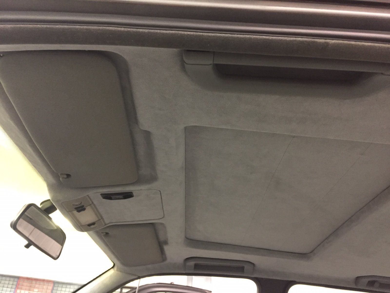

Did anybody use this on seats? If so, I have couple questions:
1. What is your go to brand?
2. Does it hold pretty good? I know they use it in cars, but.. Better then leather/vinyl? Worse?
3. How easy is that to sew compare to leather/vinyl?

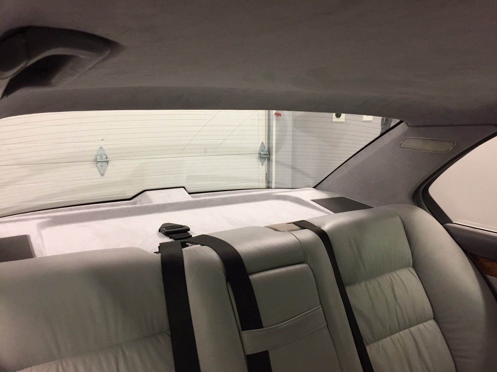

4. In what direction to put it on seats? On A-B-C pillars I put it grain "down" and on headliner/back shelf grain "back"
I bought some Ultrasuede(R) Toray on eBay at very good price, my research shows that it's just as good as Alcantara (R)

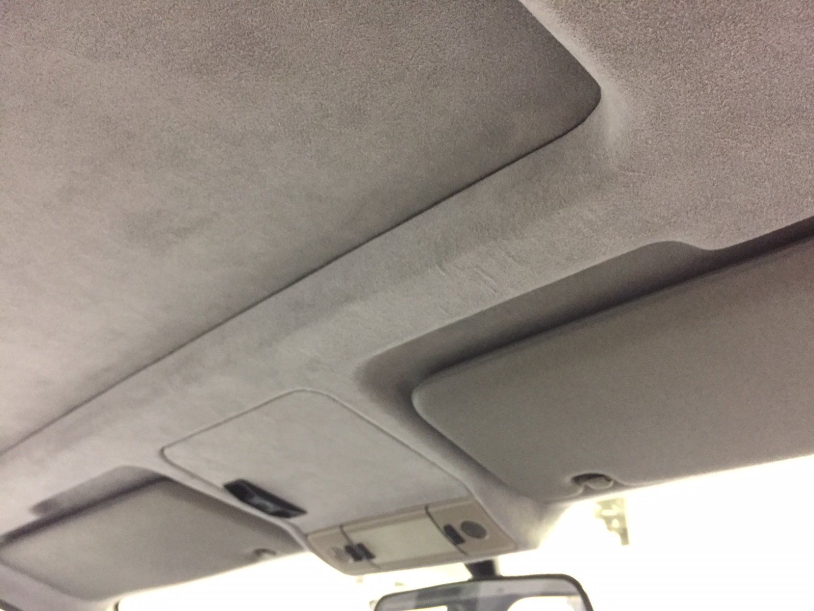

I recovered headliner (pain) and all pillars with this material. Now I want to use it as seat centers but hesitating...
I like how it feels though. PITA to stretch on headliner(you see some wrinkles on sunroof edge)..
#2962
I wouldn’t be worried about those little wrinkles esp for just starting out. I still struggle with headliners lol. I think for seat isn’t it from Back to front on the lower cushion and top down on the back cushion? As far as longevity I have no clue. I had it in a truck once and it didn’t last as long as the material it was sewn to, but it was also on a high impact area of the seat.

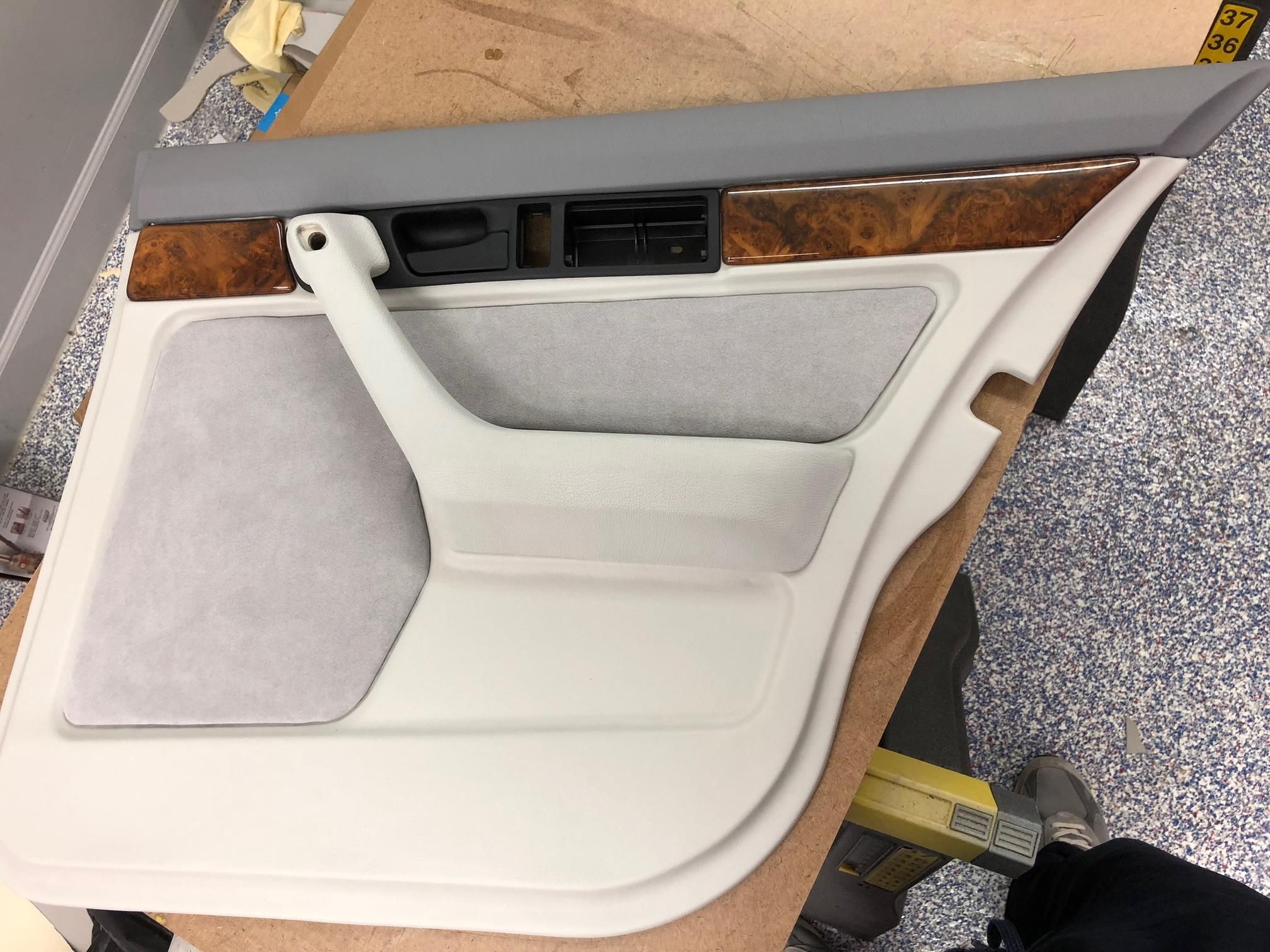

Yes, this is exactly why I think about doing it:
1. I got this material for very good price
2. It get's hot here in STL, I hate leather seats. Middle inserts make sense.
3. All doors/top already have it.
Now that I'm getting sewing machine I kind of think about doing centers in diamond pattern. Then, I will have to redo door inserts to match :)
Completely recovered door panels (vinyl/insert). Not without issues, but came out great!
