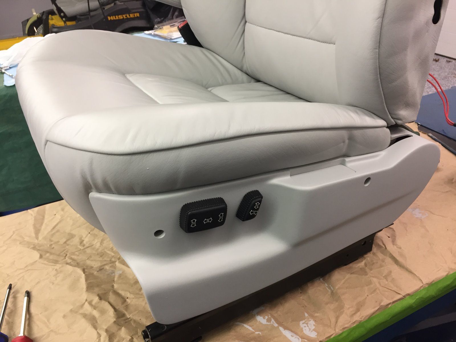

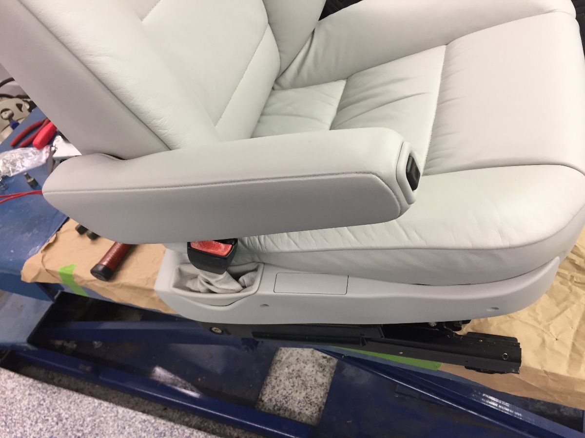

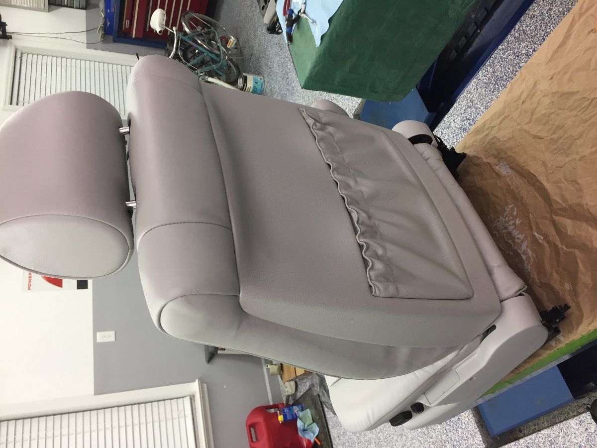

Seats which in my car now. Rebuilt, exchanged L/R leather so driver got good pieces. Repaint all with special paint.
#2970
@IvanD ,
Those seats really look great! We are working on a 1947 Willies right now and the seats were painted, sometimes may be the only way to get your colour match.
#2973
Painting not bad. I already have 3k miles on driver's seat and paint holds pretty good. But you can still tell if you look close.
Seats I want to restore have really bad leather (picture in first post is not my seats, just the same seat). It's completely dry and cracked. Even if I paint - it's still really hard and will crack/rip.
I was thinking about finding good deal on automotive gray hide and then just paid whole hide. This way paint won't be in seams/etc and I can lay it perfectly. Afterall they paint this leather just the same, right?

Ok, another example. Those carseats in my picture. You take acetone on a rug and it wipes color right off. So it IS just a paint, but special one. This is exactly what I did. I first wiped of all old color, then fixed cracks, used special primer, then color, then clear. But it's all special paint.
