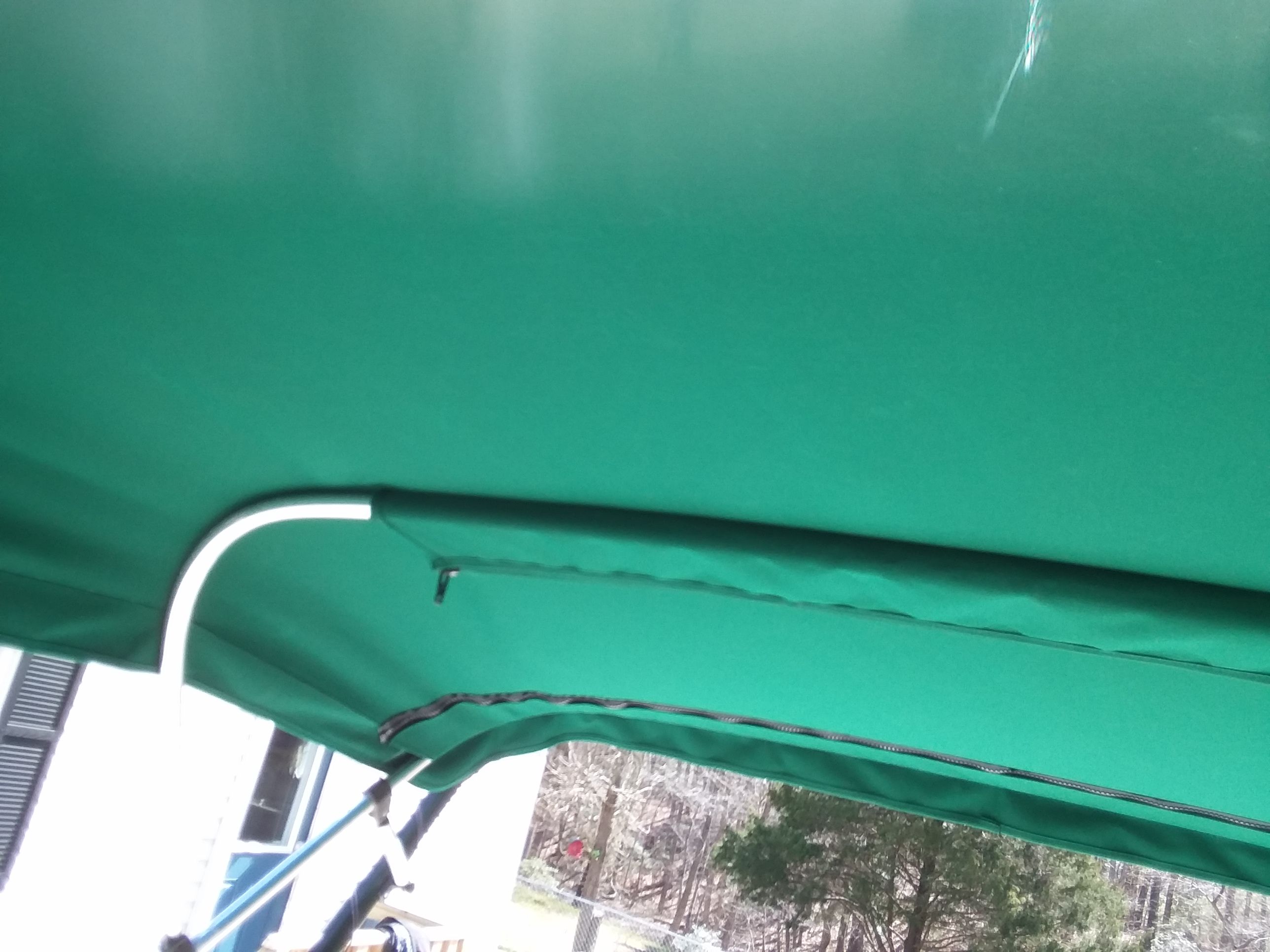

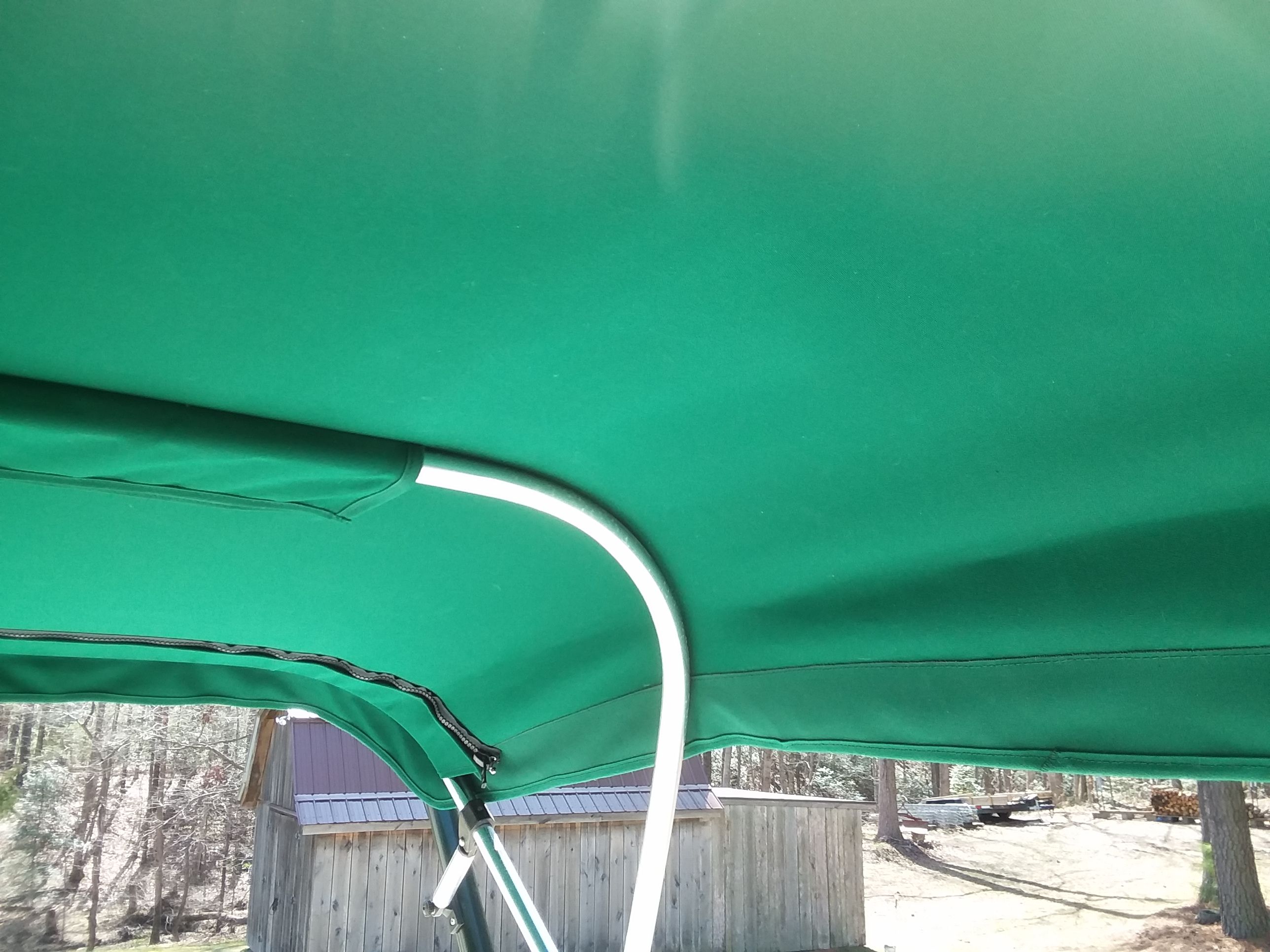

So I tried the method shown in the 2nd video and was not pleased with my results.
The inside pockets were nice and tight most of the way but the very ends had some slack material. You can see it in the 1st pic at the bottom corner. Not too bad but one of my measurements is obviously off.

I couldn't get a good pic of the inside because it was too dark but it basically starts half way down the bend and gets wider as it goes down. If that makes sense.
There was close to an inch of extra material at all four corners.
I pulled the pocket corner an inch further in and readjusted the whole bend area and that made the middle loose. Looking back if I had only adjusted the pocket halfway up the bend it may have worked.

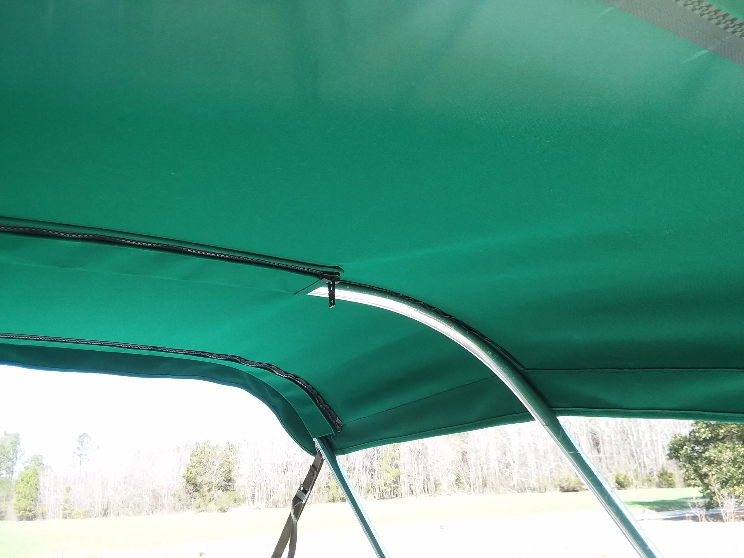

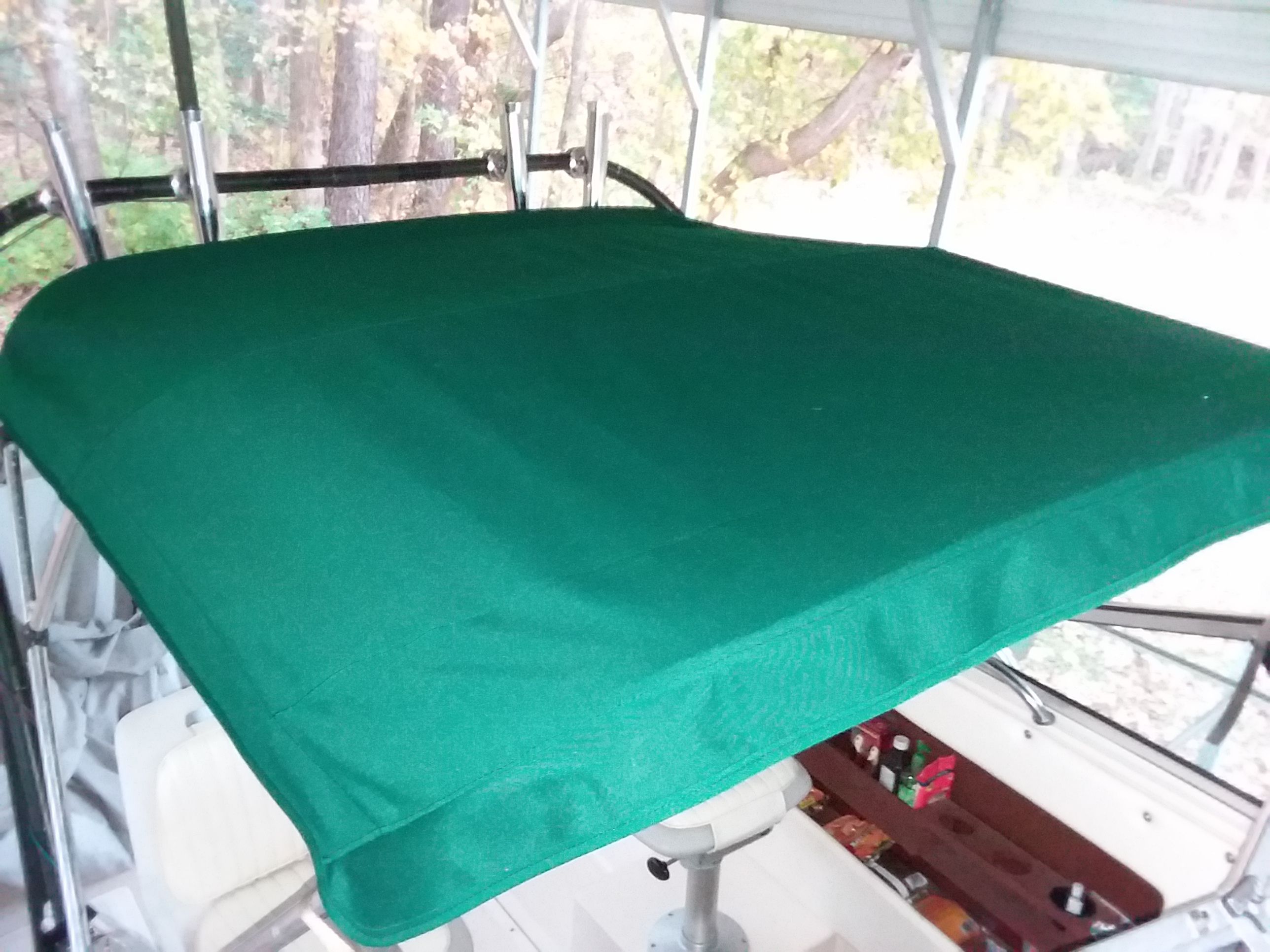

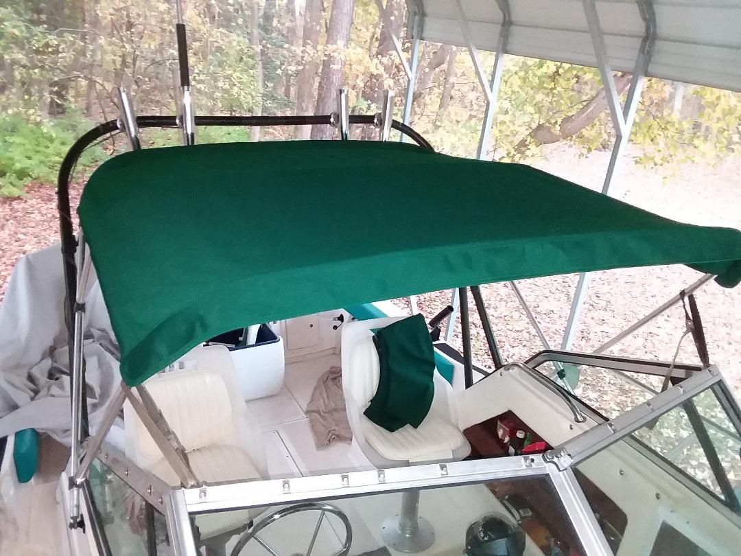

Been a while since I had the time to see but I'm back at it now.
Here is my 2nd attempt. This time I used John's method from BCU.
Much easier and nicer result.
I still need to practice but it is getting there.
By miket
#4676
I'm pretty sure the wrinkles going down the side was a patterning error. I brought the seam line around to the side on the radius, instead of in the front like the rest of the bow.
