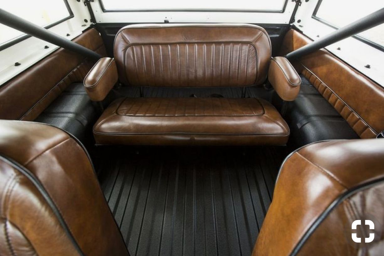

Hello, I'm trying to match the leather or vinyl from this interior photograph of an old Ford Bronco interior. I like the dark worn leather look but I'm not sure if this would be leather or vinyl and which one would be better to use for automotive interior. Also, what color thread would be ideal, black or beaver (assume beaver is brown shade). I need some guidance on my first purchase of materials and ultimately how much I will need in thread and leather/vinyl.

If this is your first time ordering materials I’m going to assume that you haven’t seen much. If this is the case I would recommend vinyl. The cost of leather to experiment with would get costly. Try getting ahold of Albright or a supplier and ask for swatches. They’ll send you them you can look through. I’m sure they’ll be a brown in there you might like. Also ask for a thread color guide and you can compare material and thread colors. I wouldn’t use black. It would look odd and stick out. This would be a good place to start.

Vinyl and leather are both good for automotive use. You just need to make sure its rated for automotive use otherwise it wont hold up to the UV. @Cody is right. Its much cheaper to make mistakes on vinyl if your just starting out.

There should be plenty of options in the brown distressed look in both leather and vinyl. @torriec Do you have any material suggestions that you carry?
For thread there are lots of color options you can choose what ever you think looks good. Bever i think will be too light for that color fabric. Black might look nice or you can find a closer color match. Hope this helps!
