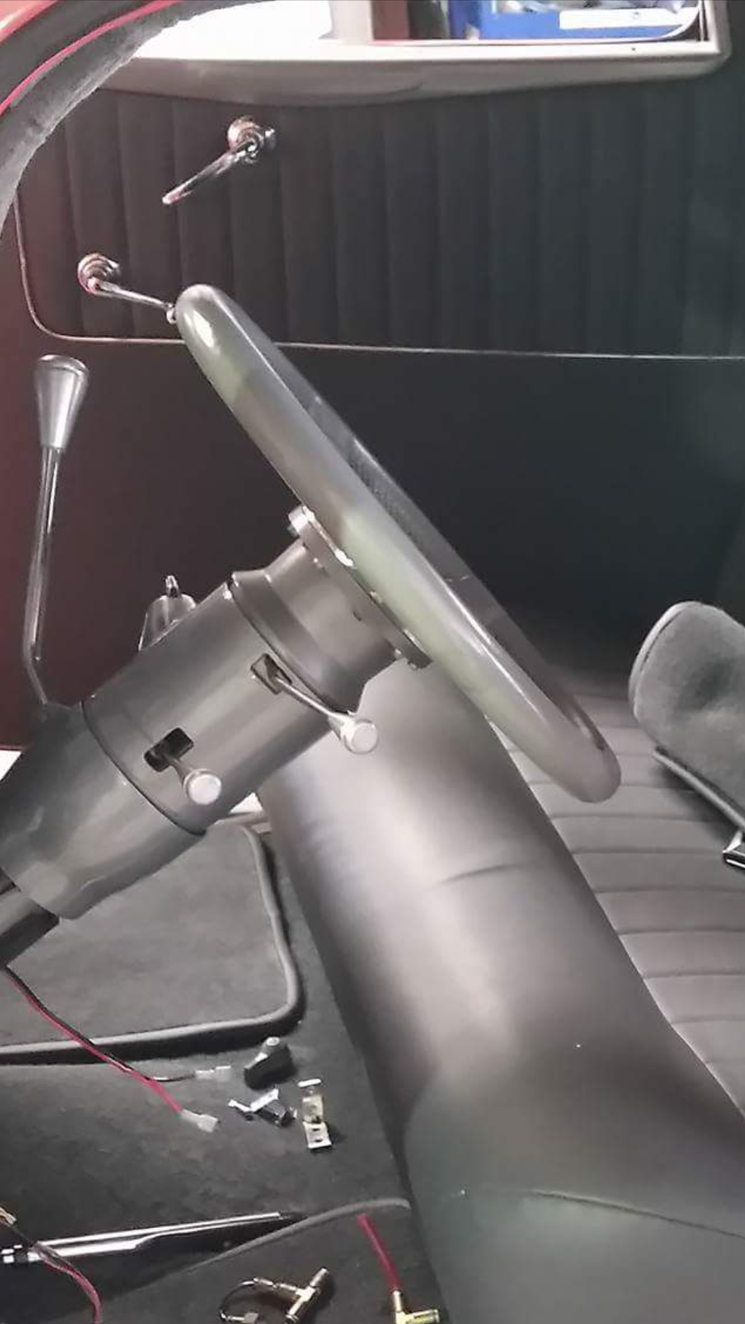

By kl4bidn
#1703
Here it is, my first door panel...ever! I'm so happy with the way it turned out.
By LeatherJohnny
#1713
Wow! All the sew lines are perfect!!! :wink: Congratulations and you can be proud of what you have accomplished!
