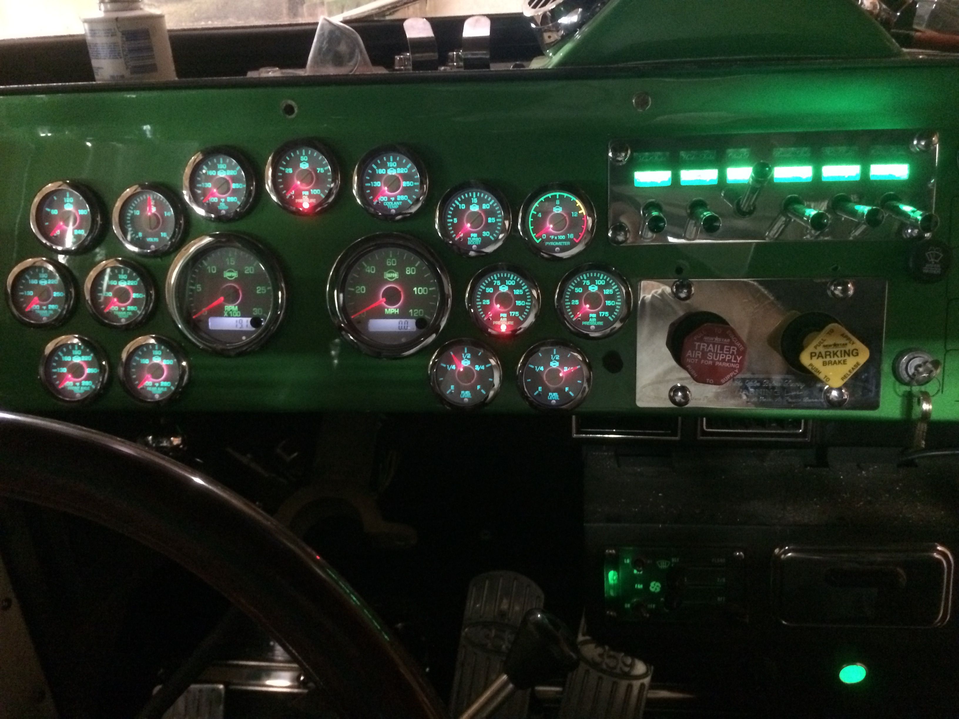

Wrapping dashes is defiantly something I will be doing videos on in the feature. Basically what you do is make all your patterns like you would a seat cover. I like to use transfer tape to make the patterns. Its like a 6" wide roll of half sticky painters tape used for vinyl stickers. Sew your cover up and glue it on. With a metal dash you dont have to worry about much just scuff it up and glue it on. This is one of my favorite videos on youtube. you can learn a lot from it .
As far as material goes. There are so many options. As long as you use automotive grade leather or vinyl you should be fine.
@SmokinSCustoms WOW :drooling_face: It looks like a damn airplane dash! good thing hole are pretty easy to trim around. You would have to remove all the gauges first though.
