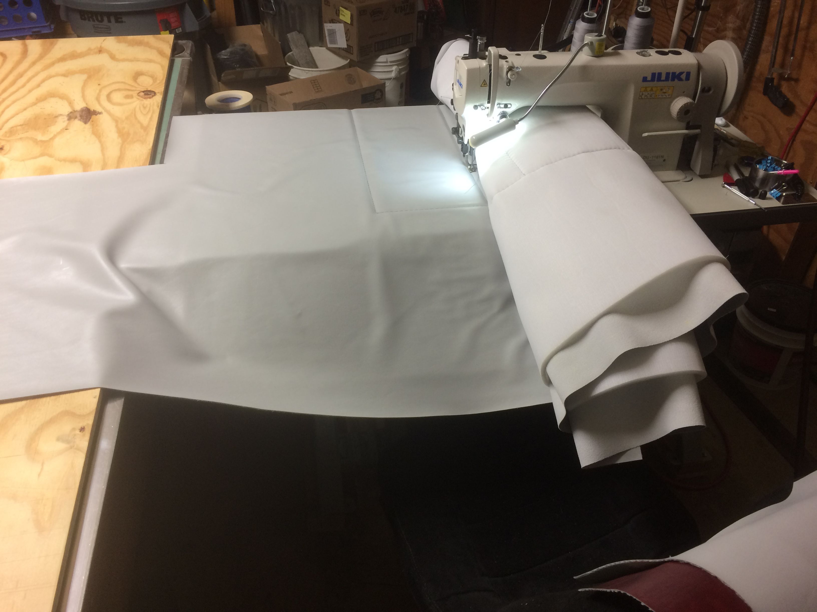

Yeah, fighting with this motor is costing me time and time is $$. Dealing with these big panels you've got a lot of material in your face and in the machine and not being able to control it like I want is a major hindrance.

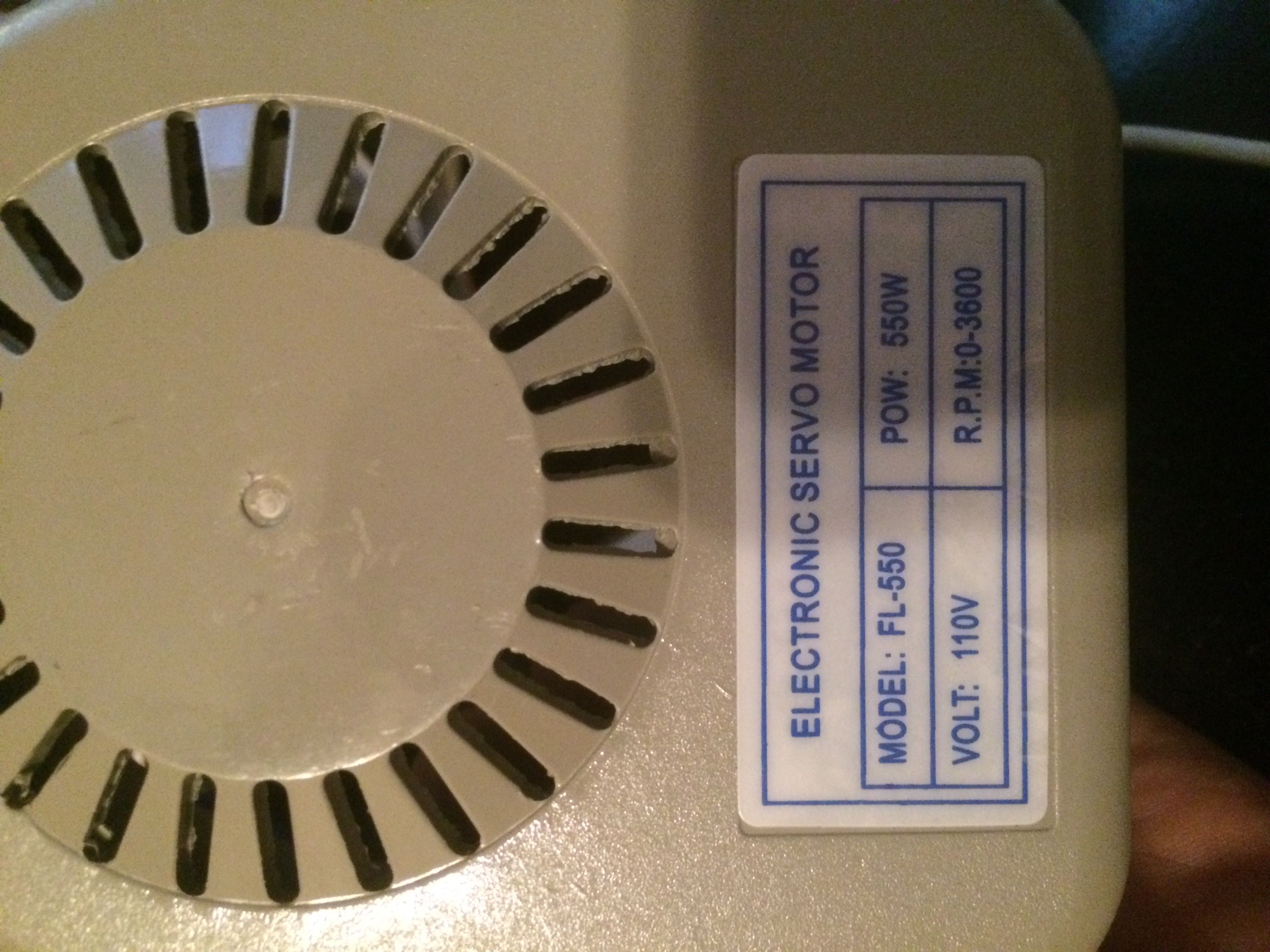

BigRig wrote: ↑Sun May 27, 2018 6:25 am @SMokin your motor is Kobe Japan right?
Here's all I know about it. I hit up the ol google with the model# and it brought up Consew motors. I'm guessing they are pretty much the same motor.

@SmokinSCustoms
That casing looks like it is Kobe Japan.
My motor is DC 550, Yours is FL 550
My RPM goes from 0-3450, Your 0-3600
I would ask for a motor exchange, mine is amazing really.
