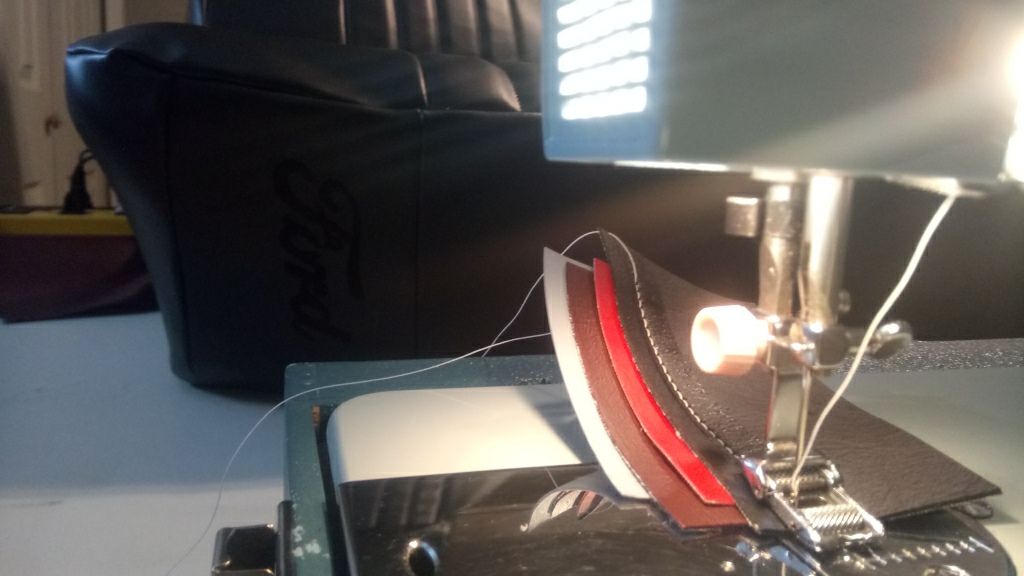

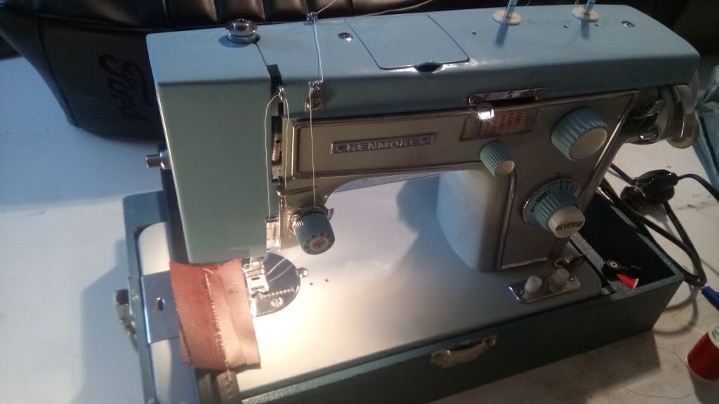

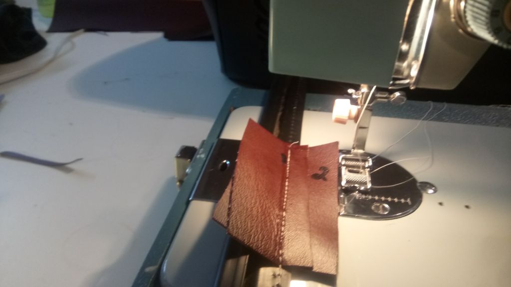

My Kenmore sewing through the plastic J Hook and two layers of vinyl thread #90.
Sewing through 40 oz, 30 oz, 28 oz and 28 oz (4 layers of vinyl with ease!
kl4bidn, LeatherJohnny liked this

@BigRig
I had no idea those machines were capable of that! That is almost the same Kenmore I bought my wife. She doesn't know it yet but she's about to start sewing upholstery. Haha

I have every foot attachment known to man for this machine. I can make any dress and darn any sock on earth!
The foot lift is not impressive but that is four layers of vinyl and it would sew through 06 no problem. The top layer is 40oz Artic grade as you can see it is thick .
It is a miserable unit to control though talk about speed but I am sure hooked up to a modern foot pedal it would be better.
I sewed two layers of vinyl over the JHook to demonstrate that this machine can sew through. Impressive eh!
