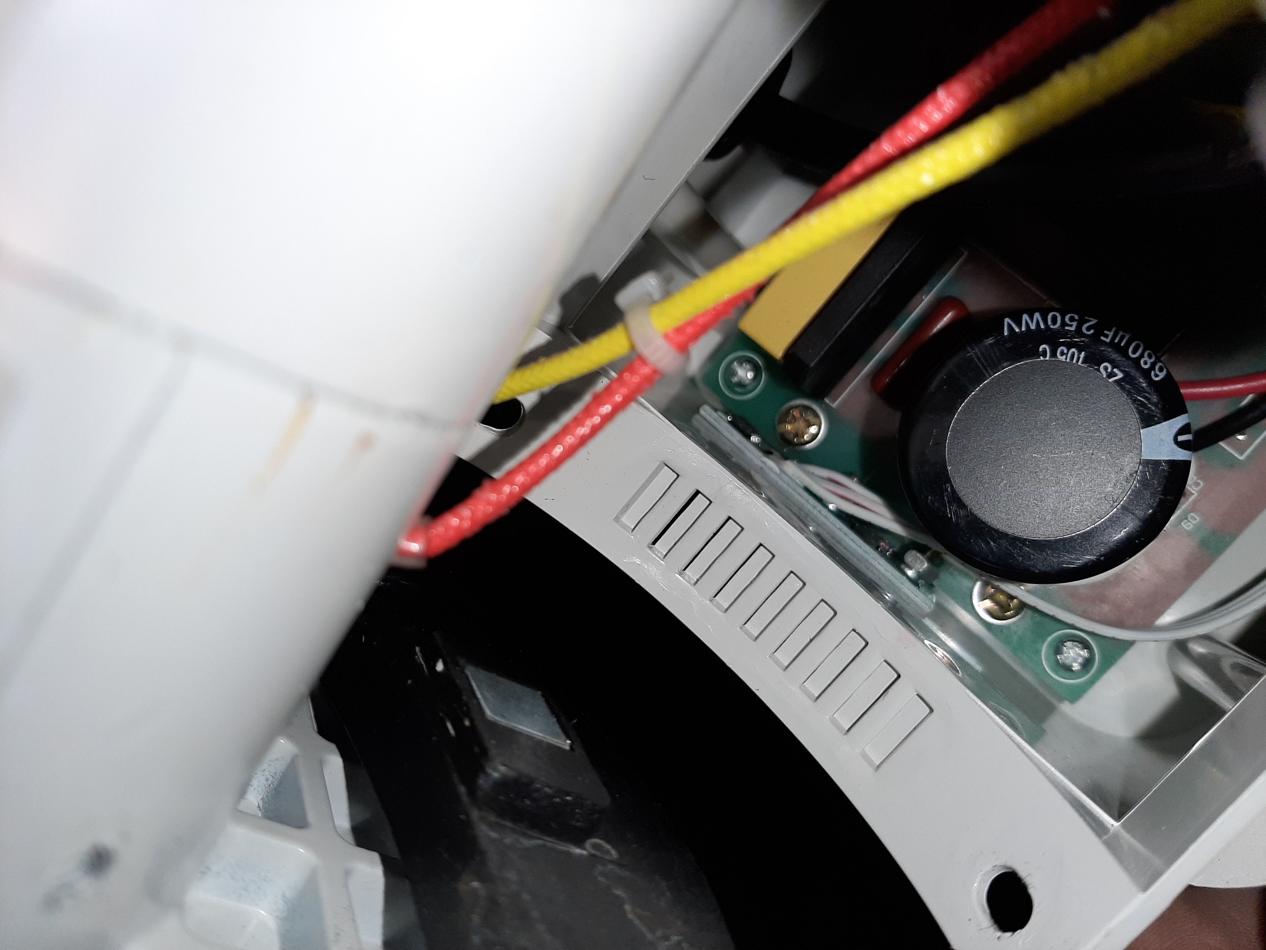

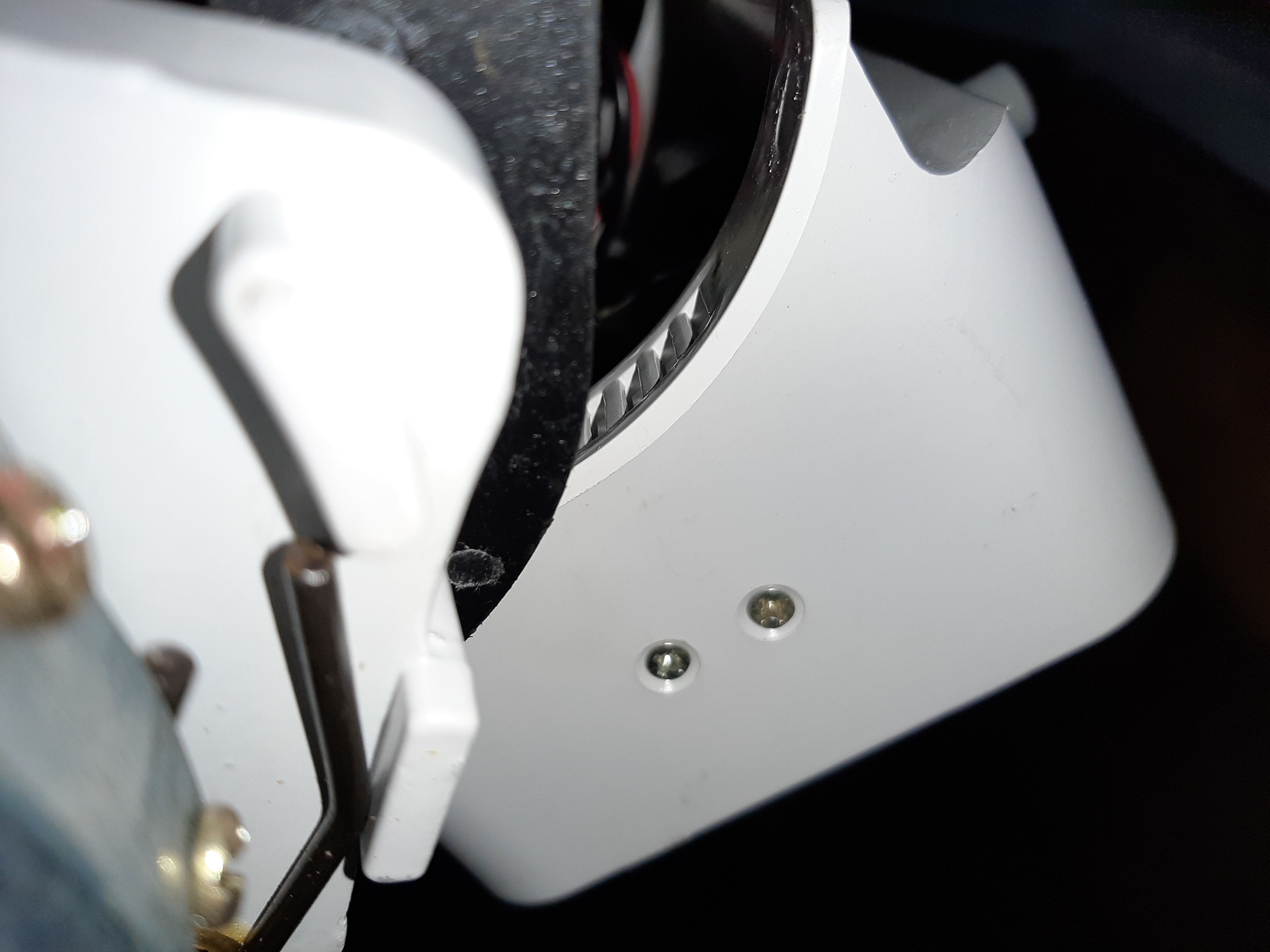

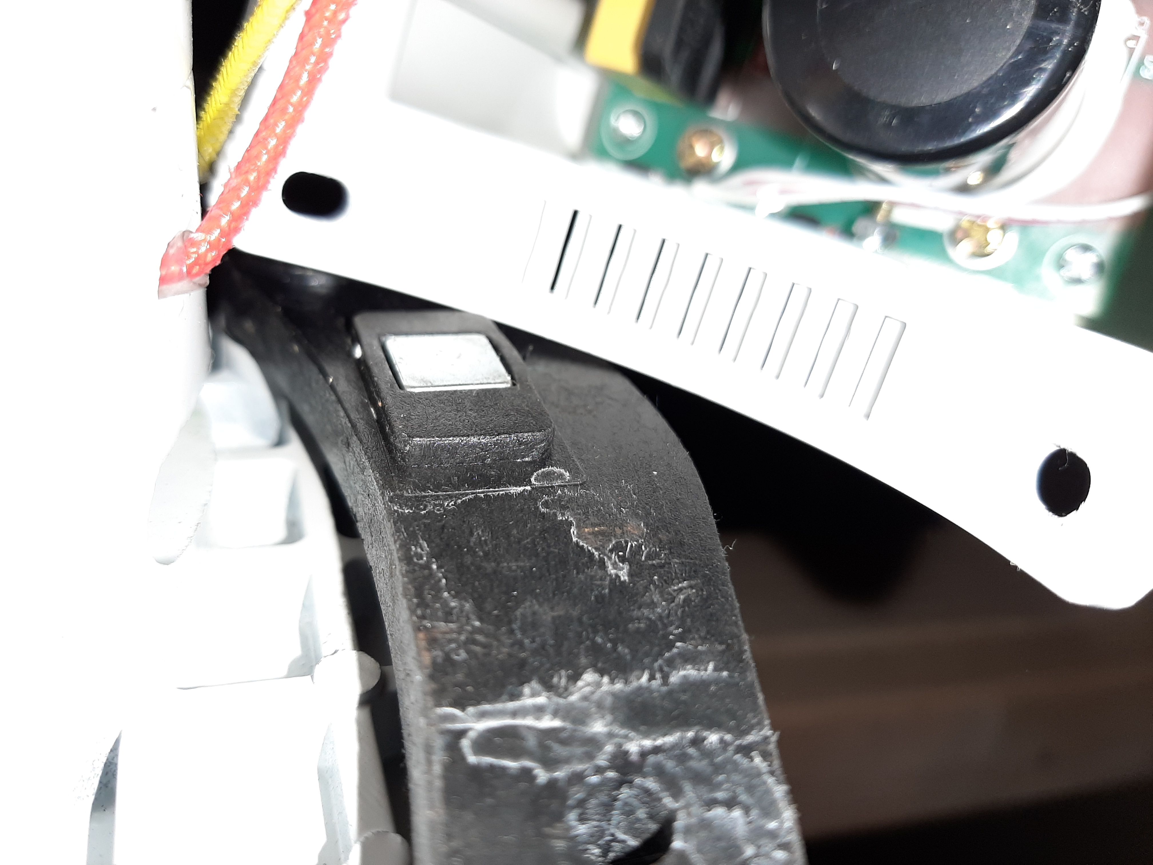

#6307
John Long wrote: Sun Nov 03, 2019 12:23 am @miket, I'm not sure if that is true or not. It will be a simple thing to take out four screws and look inside. If there is a light and interrupter vein, it should work.
This is what I found.
Looks to be a magnet
Last pic is arm, 2nd pic is the 2 screws that hols the sensor next to arm, 3rd pic is sensor and arm
By miket

This motor has the magnet sensor for the speed control. The trick is to take the arm off, pop the magnet out, and then remove some material behind the magnet. The idea is to have the magnet laying at an increasing angle bottom to top. That way, as the arm moves to start the motor, the magnet does not just all of a sudden “fully appear” in front of the sensor. Because it is leaned away at the starting point, the magnetic strength is less, so it ramps in slower. I hope that makes sense, cause I’m by no means an electronics guy.
The next thing I did was re drill a new hole in the foot pedal/treadle. I actually drilled a few for testing differences but settled in a hole about 1-1/2” from stock. The hole I’m referring to is the arm/rod linkage hole. It’s probably out near the top end of the treadle now. Drill a new hole moving the pivot closer to the pivot point of the treadle itself. It seemed counter intuitive to me a first, as I thought that would make it act quicker, but it worked great.
