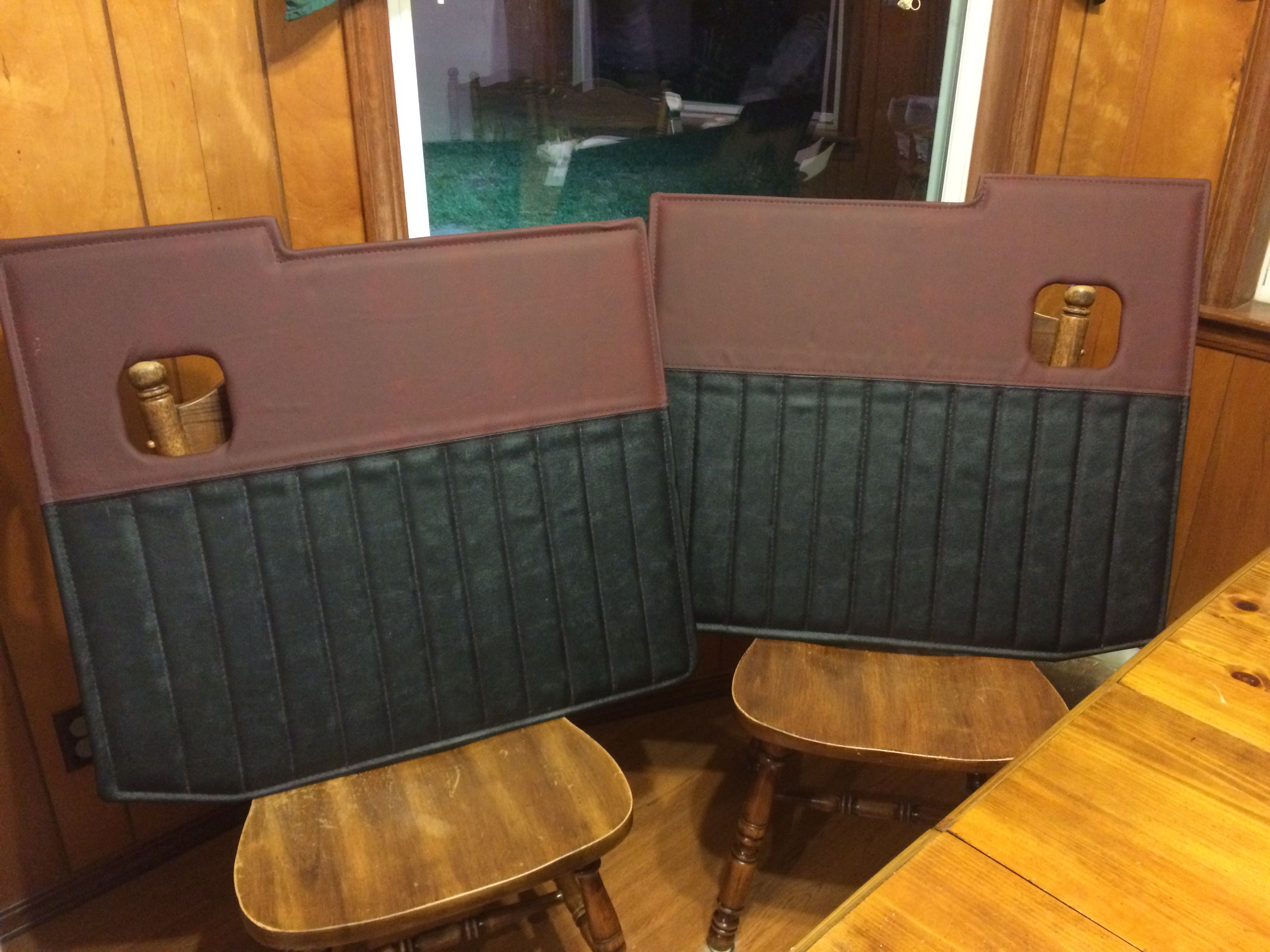

@Bondo497 On the smaller pieces I've been using water resistant panel board like the factory did. On the larger pieces, like the back of the sleeper in this 362 cabover I'm using 1/4 birch plywood. I've never used this thin plywood before so we'll see how it goes. The fun thing about using the panel board is if you want a neat edge on your finished door panel you can stitch through the panel board. That's how I ended up doing these Kenworth door panels.

@John I've never tried steaming. Are you talking about just using a standard clothes iron? I noticed just a bit ago someone earlier in the thread talking about the backing being different. Sure enough it is and this vinyl likes to stretch more one way than the other. Other vinyl's I've used in the past didn't really have a backing and this wasn't an issue. The problem with this is that I can only orientate this vinyl one direction in order to cover my larger pieces. Any thoughts on that?
#312
First off... Those Kensworth panels are sweet!! I really like that marble green with the brown.
A good steamer is a trimmers best friend. I use it nonstop. They solve so many problems. Not a cloths iron but a garment steamer like this. Here is what I use. https://amzn.to/2JYP7dj
They relax everything and make material lay more naturally. The hot steam also makes material much more stretchy so you can wrap and stretch things much easier. I highly recommend a steamer. You can even use the cheaper ones from department stores. They just don't last as long or hold as much water.
For vinyl backing.. there is a few different backing styles but noting that I think would cause that problem. All vinyl stretches more in on direction than the other. I personally have never seen stretch direction cause that problem. Usually I just worry about fitting my pieces most efficiently on the material with the least waste.

@John haha I appreciate it. I think my camera on my phone kinda messes with the pictures because in person they're actually a somewhat shimmery black and a burgundy (Carrara CR508) with burgundy thread. Thanks for the info on the steamer, sounds like I better bite the bullet and pick one up. For no more than they cost, the time and headaches it could save me, it would pay for itself pretty quickly.
