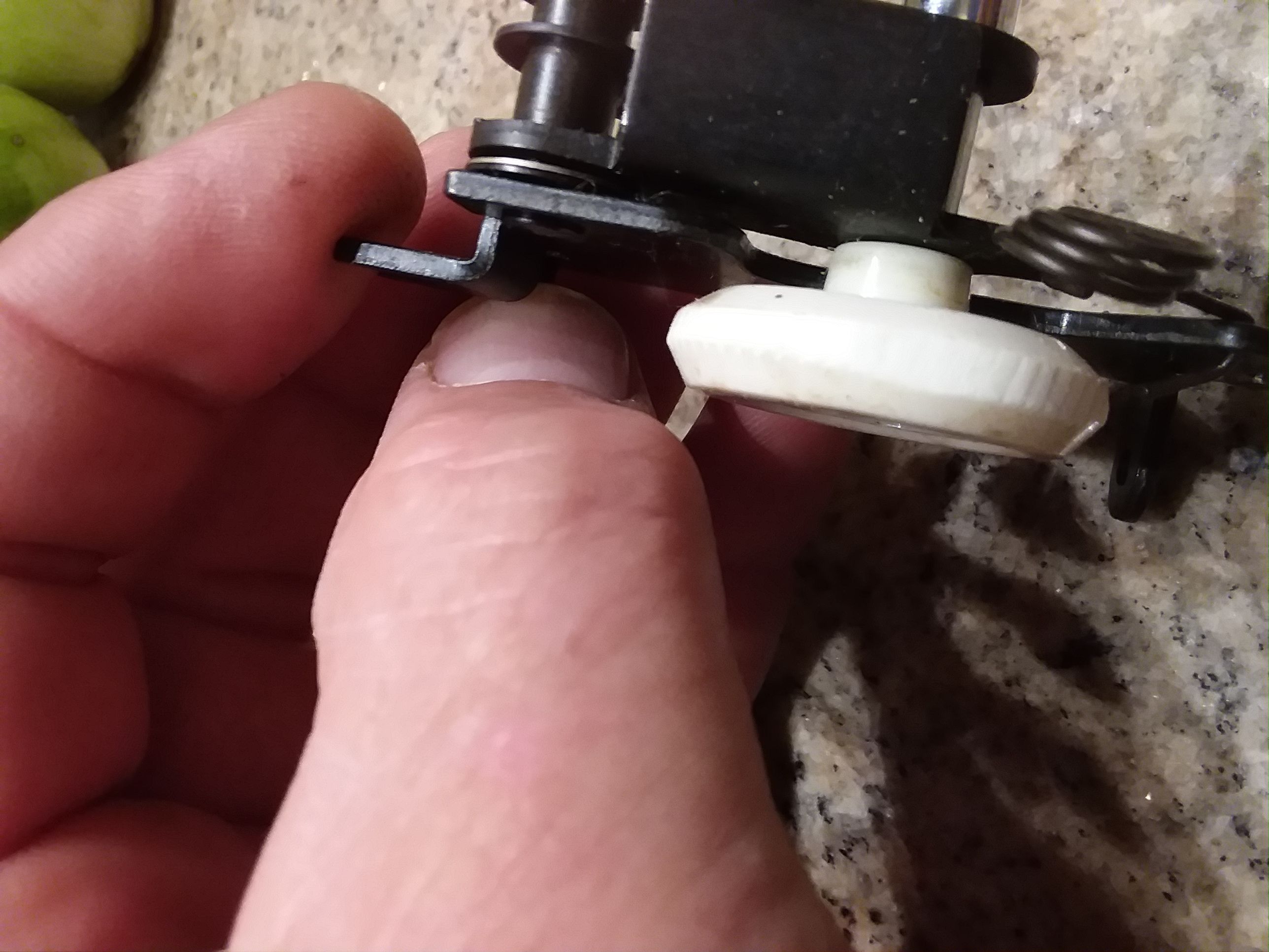

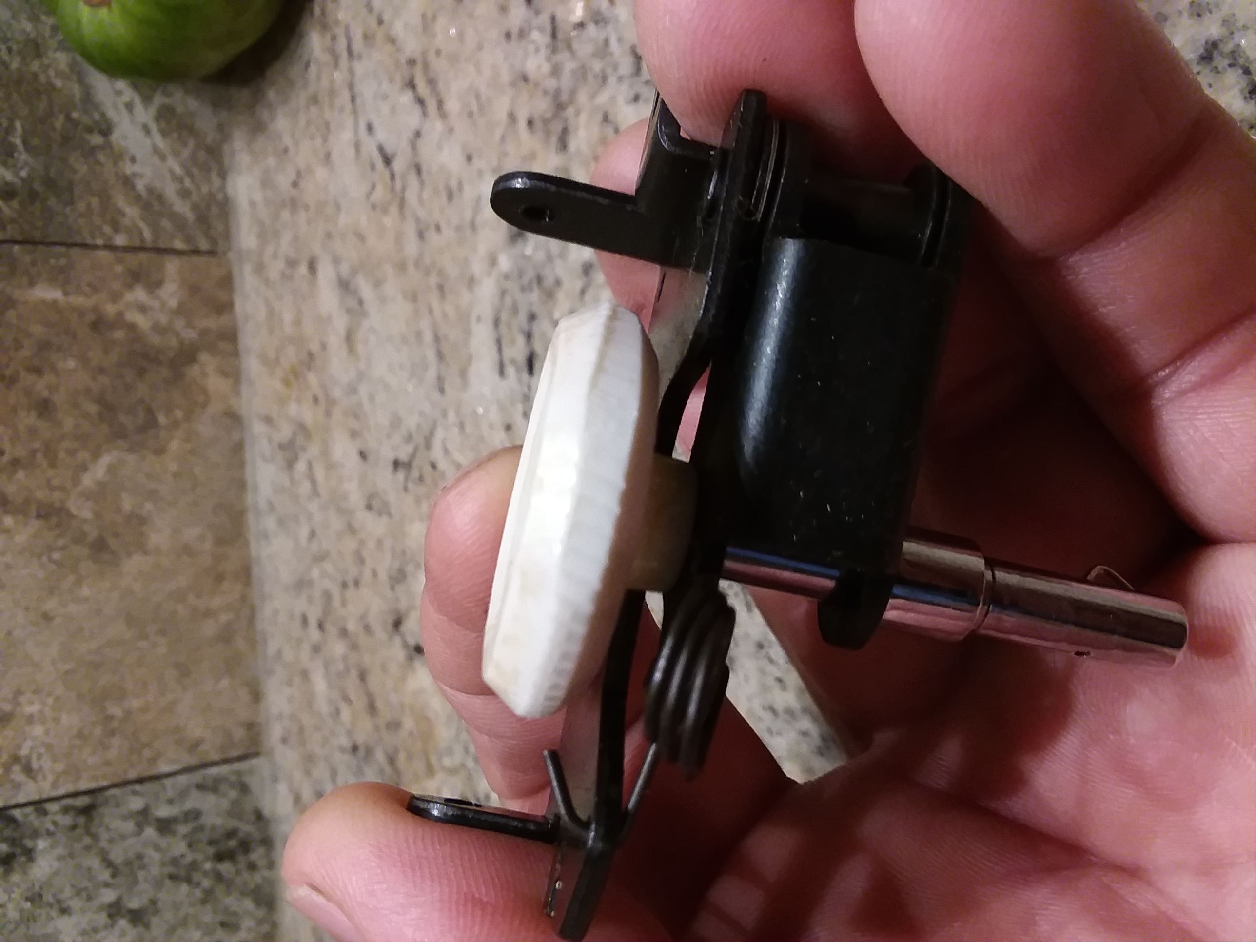

@Bondo497 You should be just fine with the sungaurd you ordered.
Inconsistent thread tension in my experience is caused by bobbins not being wound even and tight. Make sure you bobbin winder is set up properly and you have the tension set fairly tight. Also make sure that the fingers that hold the bobbin on the winder are spread apart so that it holds the bobbin tight and doesn't spin while your winding the bobbin. Inconsistent thread tension could also be caused by The machine not being threaded correctly. Also like @Cody It could be the thread. Not highly likely but possible.
miket liked this
By miket
#2823
Could this maybe possibly cause the bobbins to not wind properly? :grin:
I have never wound a bobbin before but from the start it didn't feel like it was working right. You just couldn't put much tension on it.
Gonna have to wait a couple days for the new one to get here but I think we're on the right track. :thumbsup:
Thanks again!
#2825
Hmmm I’m no sewing tech, but I believe you found the culprit.

Thats very strange. Ive never seen a bobbin winder with a wheel like that. Possibly modified by the previous owner.

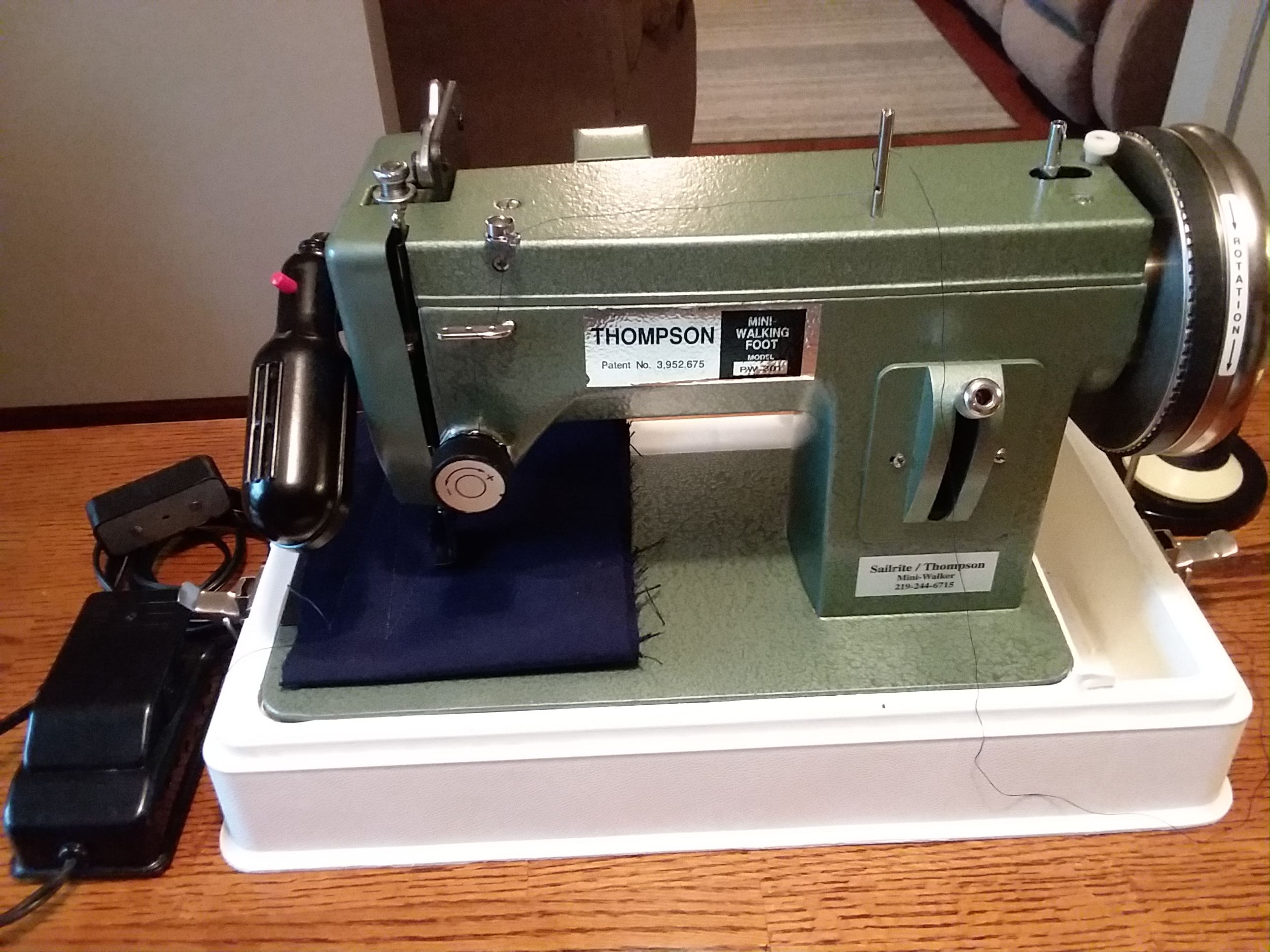

@miket ,
Can you post a picture of that machine? The rubber wheel resembles something I see on older sewing machines called industrial STRENGTH on e-bay. Not real industrials though.
By miket
#2828
It a Sailrite Mini Walker.
This is a stock winder part# W030
#2831
@miket that's cool little machine! Is it truly a walking foot machine? I like. Could you post the model number?

I just zoomed in and got the number, thanks for the pic. My wife has been using my Sailrite Fabricator occasionally but would rather use a smaller machine and this is right up her ally.

#2834
Bondo497 wrote: Tue Sep 25, 2018 5:26 pm I just zoomed in and got the number, thanks for the pic. My wife has been using my Sailrite Fabricator occasionally but would rather use a smaller machine and this is right up her ally.
Good deal
They are made under a couple different names from what I've read. REX I believe is one.
Apparently Sailrite bought the standard Thompson and made some modifications to it, like the big pulley wheel, and called it the Sailrite/ Thompson.
It is a walking foot machine.
I don't think they make them anymore but I just found this one barely used on craigslist.
Check your local yacht club. Apparently they are popular with sail boaters because they have a handle you can crank to work the machine if you are at sea with no juice.

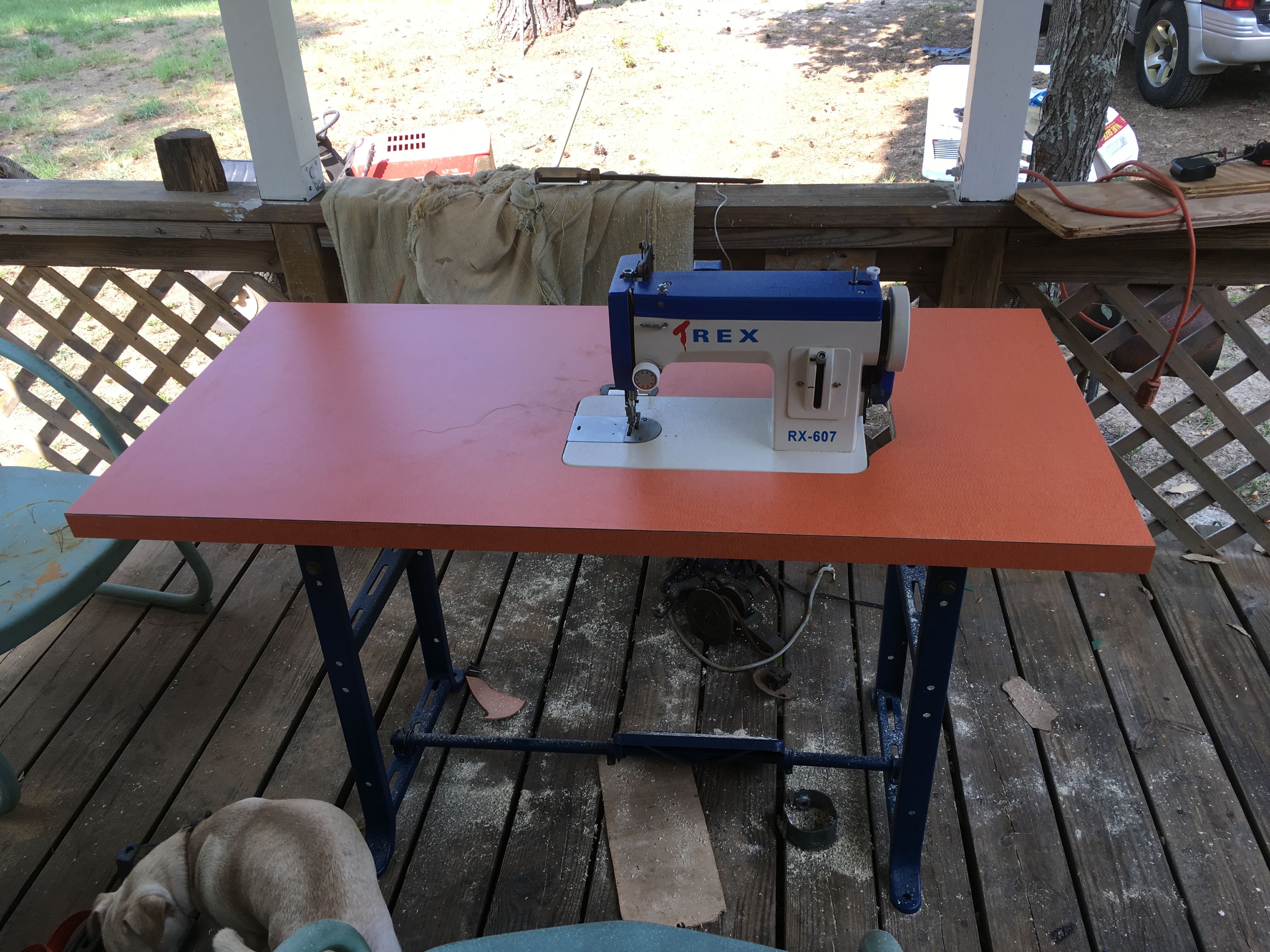

I have the Rex and I love it

I love the outdoor shop setup and the shop dog! :grinning: @Kra z Bill
By Kra z Bill
#2838
John wrote: Tue Sep 25, 2018 9:39 pm I love the outdoor shop setup and the shop dog! :grinning: @Kra z Bill
she supervise's everything i do lol
By Kra z Bill
#2842
I wish that this really was my shop, But in this picture I had just finished making the Table top and was assembling the table. I then moved it into the back bedroom. I have installed a Sailrite Workhorse Motor on it. I am A disabled vet so I have a set budget, so I have to buy a little bit at a time so I still have to buy the belts, monster wheel and the posi pin and a few other items. When I finally get it finished I will start a post and share the pictures. My shop dog and her sister never let me out of their sight. They sit on a cushion near me in my sewing room.
