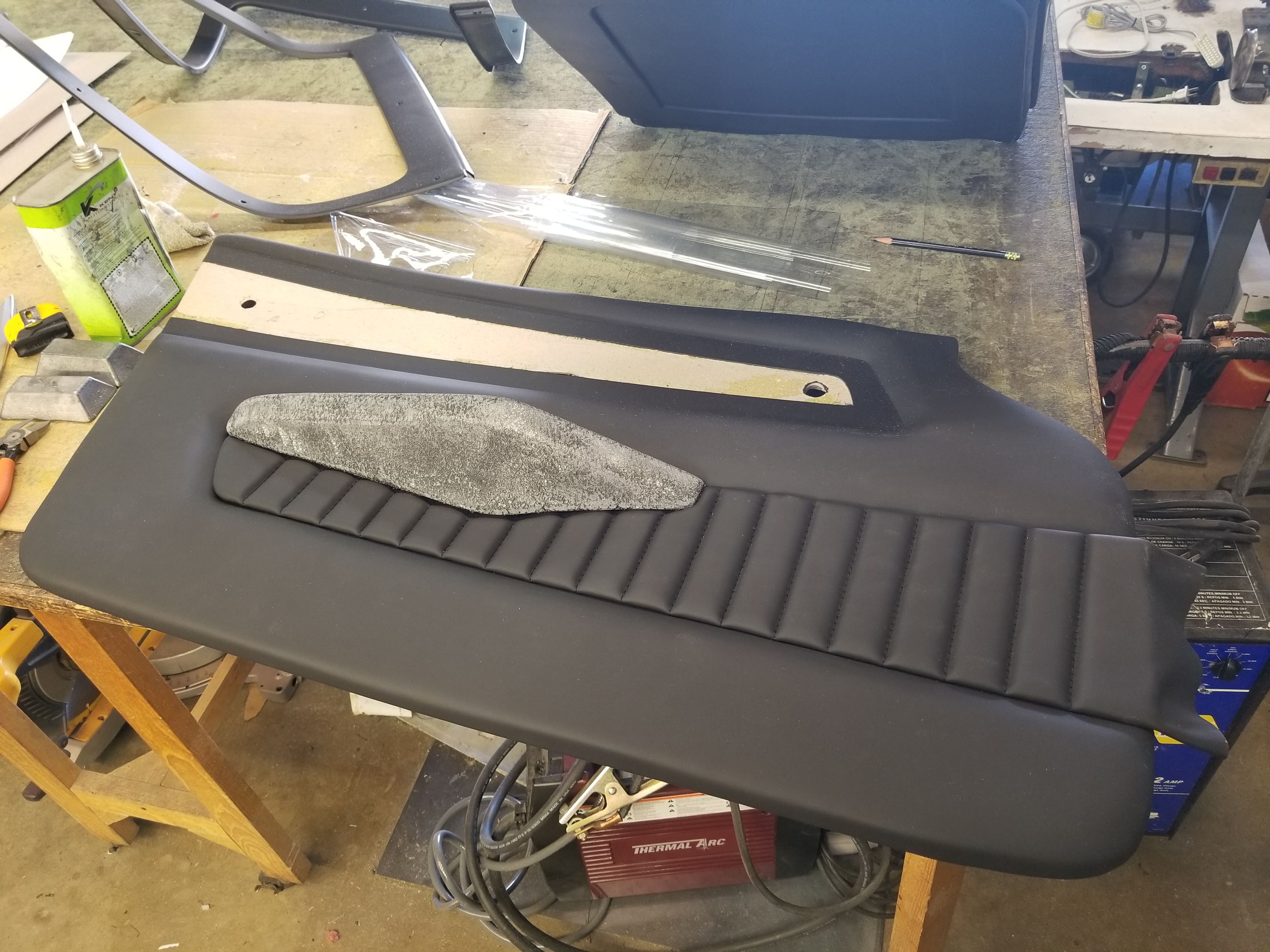

By jdenison89
#2541
@kl4bidn here is a door panel i made for a 64 vette with a similar premise. Beveled closed cell foam and sanded to give a soft edge
Here is a door panel beveled closed cell
kl4bidn liked this
#2544
@kl4bidn thats a classic looking door panel right there. Customer will be thrilled. I’m glad with all the advice given and practice you got it to work out. Sometimes you have to take bits and pieces of advice from different sources and put them together to make your own method. I agree, you’ll be doing a lot of cars here soon.

#2549
@jdenison89 Really nice work on that panel! What type of foam did you use on the rest of the panel to get the taller 3d shape?
