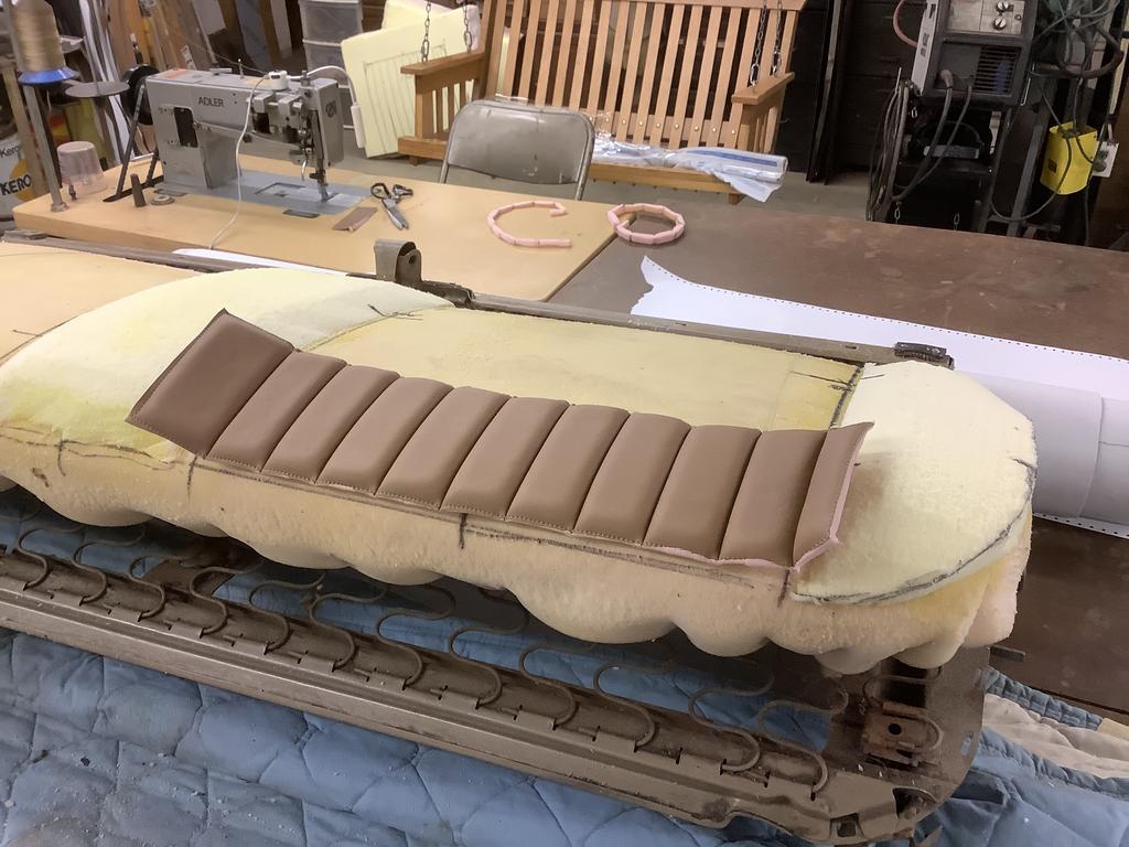

Just today, I ran a test strip of pleats to see what I needed to do to end up with 1 1/2” pleats? I realize my example is a different style than what you will do but bare with me.
I started with 2 1/8 inches of material for each pleat and ended up with just under 1 3/4” after sewing the pleats. That tells me that I can cut back to 2 inches and be pretty close to where I want to be. I will take just a tad more fold allowance to make up the extra fraction of an inch.
You will not loose anything like that with your top stitched pleats but if you sew a small test piece with 10 pleats it will tell you what your loss is. Add that to each pleat as you lay the job out and you can be "right on the money."

Basically what you need to do is sew a sheet of pleats larger than the piece you need to cut out. Then you can lay your pattern on the back of the pleated sheet and cut it out to the size and shape you need.

If you’re using 1/2” sew foam. It’s usually 1/8” added to every stitch. As you loose 1/8” roughly every time you see. For easy figuring and with a 1.2” seam allowance your first pleat would be from the edge 2 5/8” then every other one would be 2 1/8” from there till your last which would be the same as the first.
