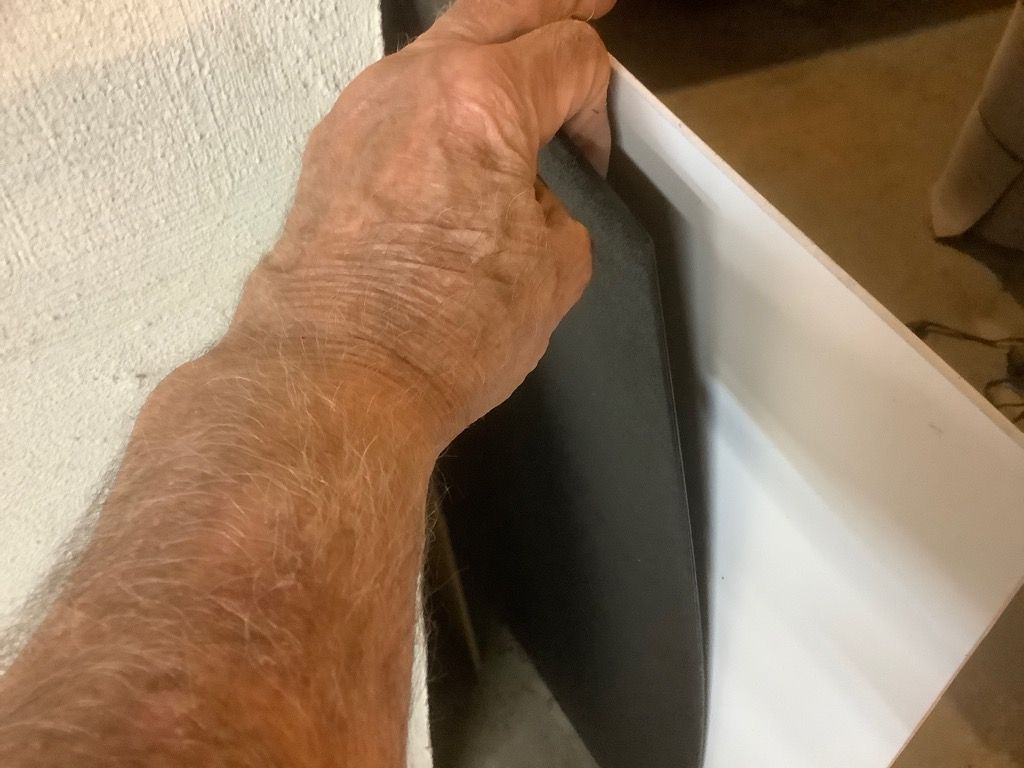

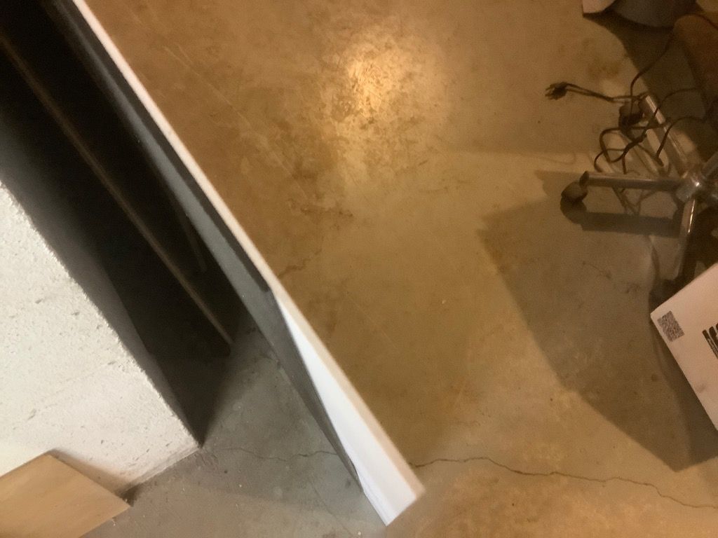

The pictures won't mean much. Both panels are 3 mm thick. The PVC is white and the ABS is black but the only real difference is the ABS is less flexible than the PVC. It is also a bit more brittle and can be broken more easily. That can be good or bad I guess.
