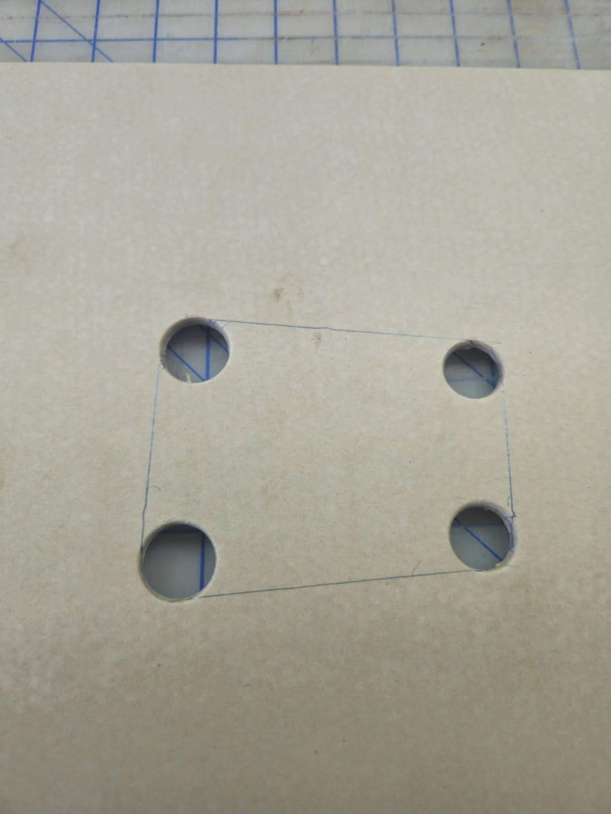

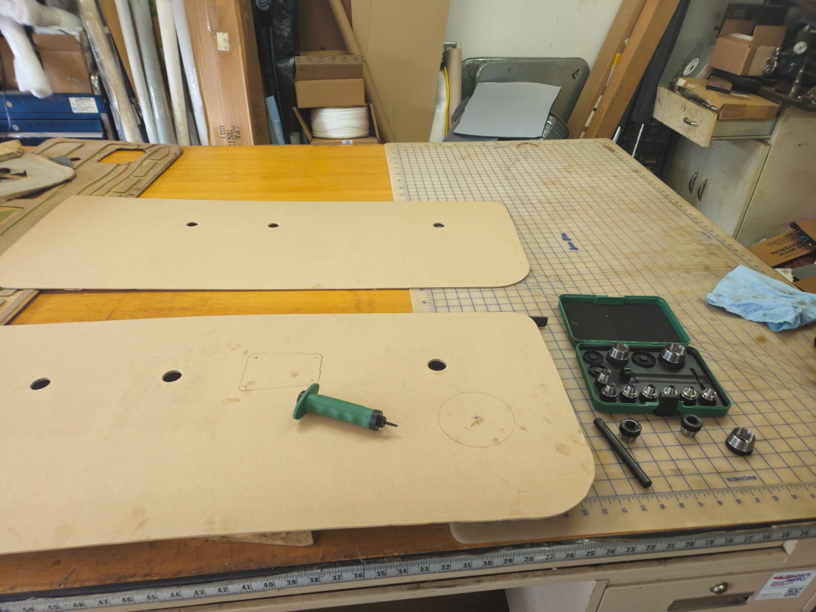

SO I thought I'd expand on this. I had the need to cut some holes in this board so I ordered a leather hole punch kit from Amazon
https://www.amazon.com/Senrog-Gasket-Le ... a_hp_atf_d
It worked a lot better then expected.
To cut the door handle out I simply punched each corner then connected the tangent points of each with a sharp razor blade using a straight edge as a guide.
image000001 (1).jpg (93.82 KiB) Viewed 13411 times
#22379
Same tool but a different name is a gasket hole punch set. Take the leather name off the tool and it seems to cost less. If you didn't figure it out yet the tool works best if you do it over a piece of wood.
