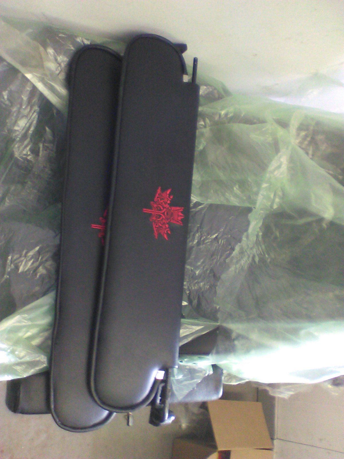

I’m building some sun visors for a 1954 packard with a Masonite core wrapped with chipboard and leather… I cut, skived and glued up the binding that is to be stitched to the visor.
When I go to stitch it all together the needle peels off in one direction, especially in the corners and misses the binding on the back side. If I take a blank needle and push it thru the hole it isn’t perpendicular to the surface.

Need a bigger needle, at least 22 for 135 thread but i'd want a size 23 or 24 for thicker stuff like you're doing. Bigger needle=less deflection. A 1508 with a servo would probably have the same limitations, both are upholstery class machines and servo's lack low speed torque unless you add a speed reducer.
#17165
@ctmk2 , common thinking about the machine and its ability to go through material. I have ran into this exact thing in the past even went to a sail shop and used their long arm. Well the needle just jammed into a dead stop. That is a technical procedure and I do a lot of my visors the packard way.
