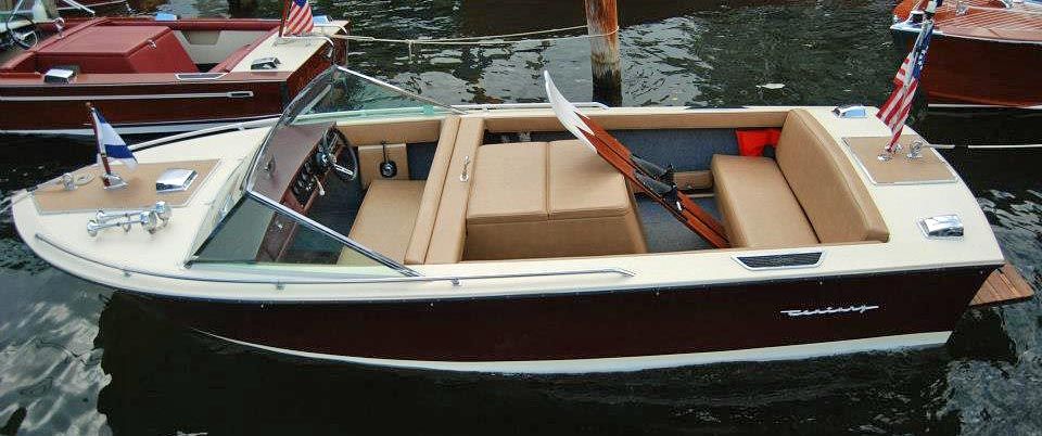

It's my boat so there isn't any more money to be made! I didn't think about the lack of stretch, however the design of the seats is very simple, basically a slab of foam on a piece of plywood. Granted I'm oversimplifying but I know Sunbrella is used on interior seats and cushions as well as outdoor covers and awnings. These are similar to a box cushion that is permanently attached, the patterns can easily be made using the plywood bottoms. I like the fact that Sunbrella (or similar) wears like iron, doesn't fade and doesn't get hot and sticky like vinyl. Attached is a picture of a similar boat (not mine) and the general look of the cushions.
#16636
Ok, i was imagining a bunch of bolsters, pulls and curves. Square cushions will be no problem, i think it will turn out great. Just make good pattrrns and cut with a hot knife or pinking shears. You got this!
