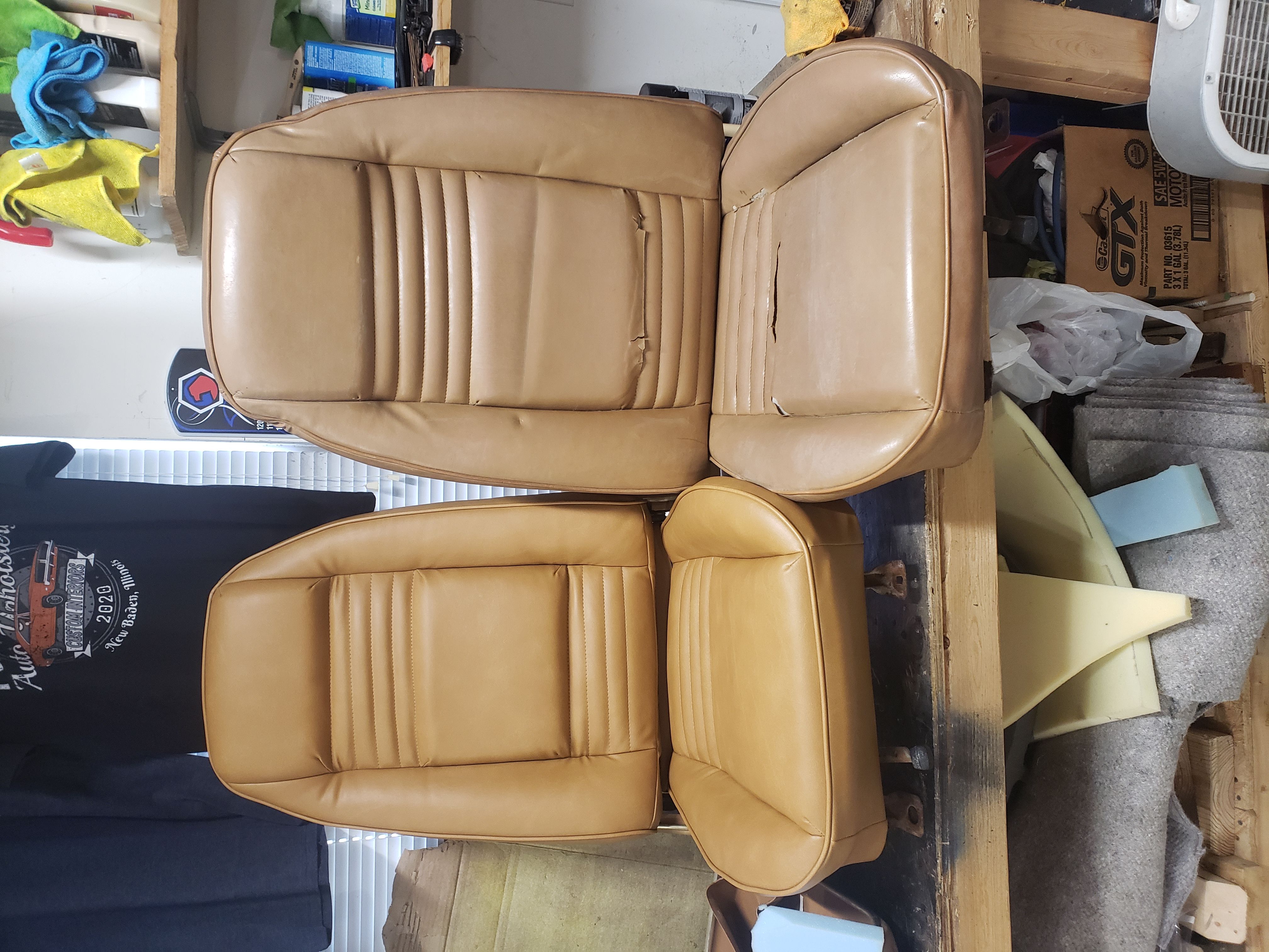

Here is the original appearing one i did a while back. Next to the other seat before that one was done.

@Matt Hamblin That seats looks great Matt.

Almost makes me wonder if the original seat was a redo before judging by the darts.
