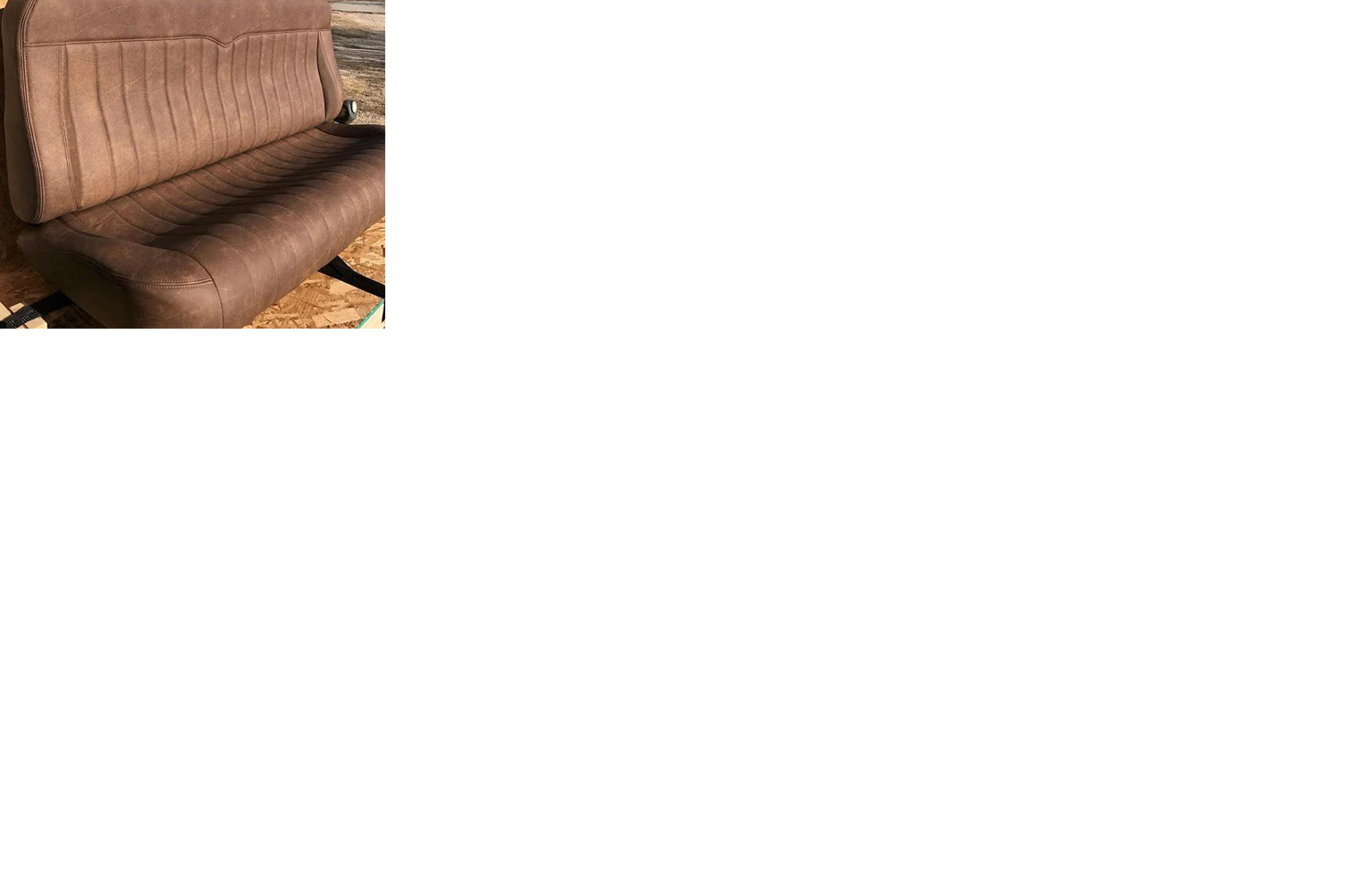

My first project is to replace the seat in my 67 GMC pickup. I am shooting for a more modern look like second pic. Since I will need to contour the foam for the back and seat, could I not just remove the coil spings on the back and replace with webbing of some sort?Image

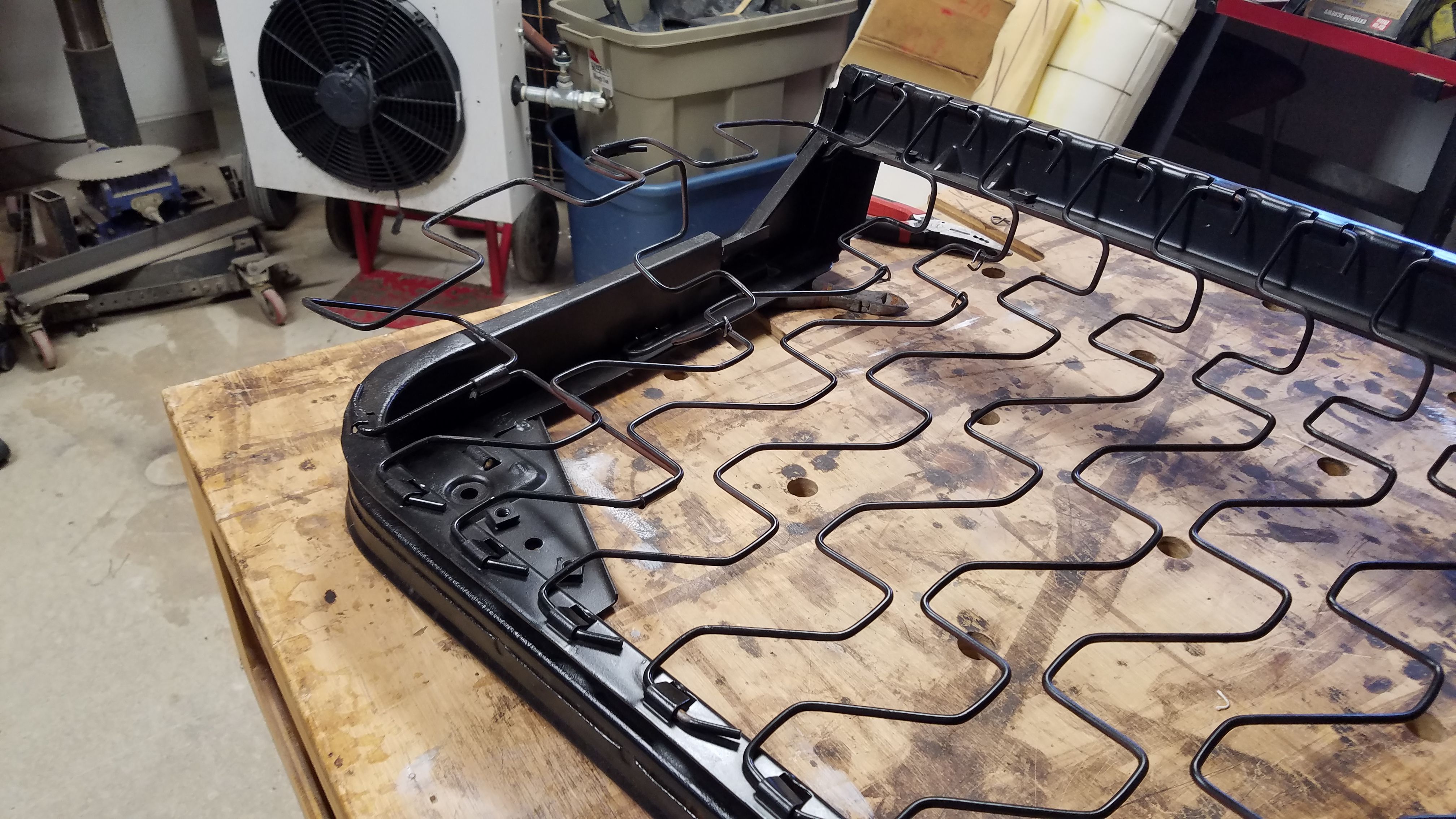

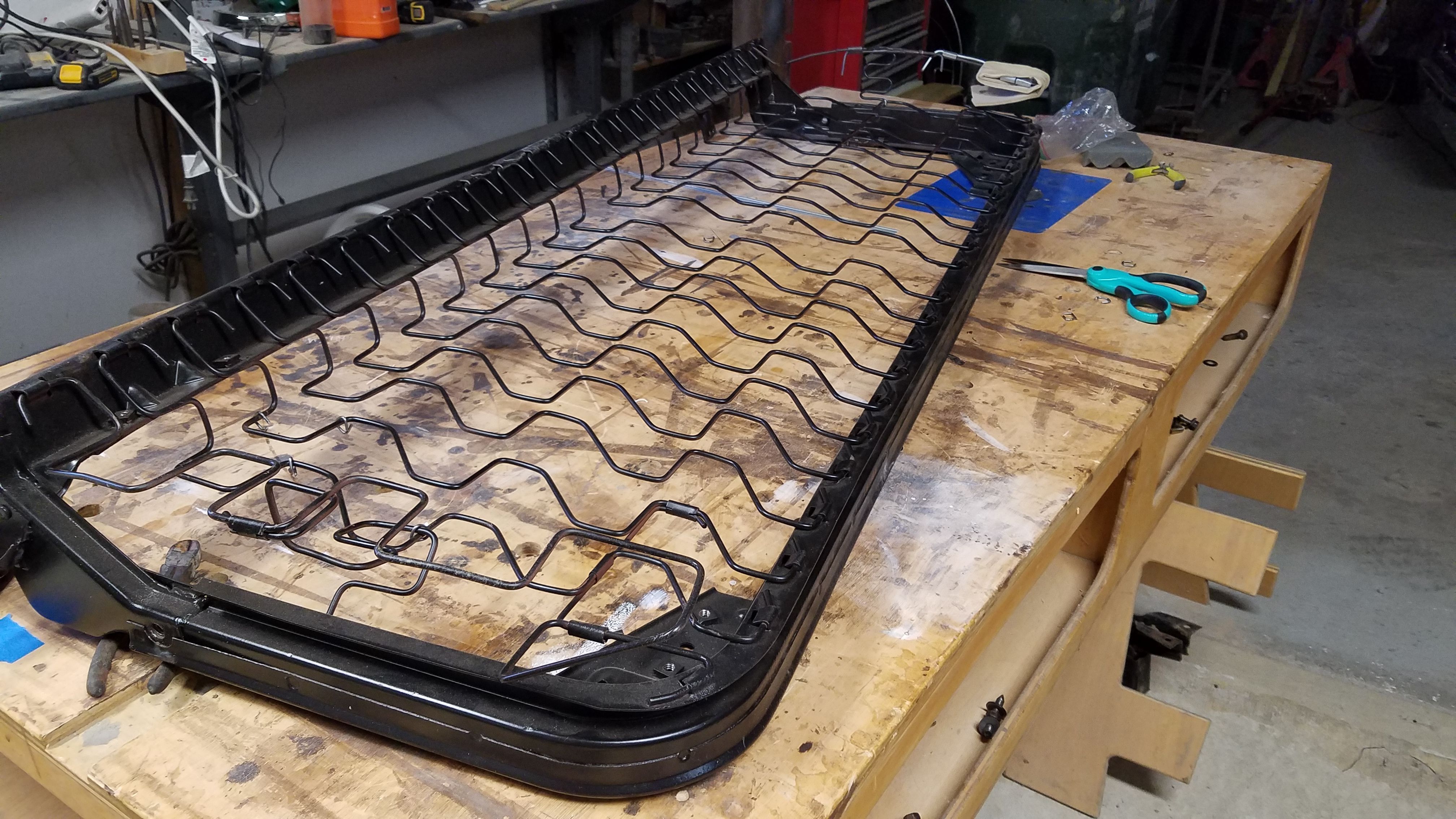

Here is what my bottom frame.
By Mikesimpson
#14757

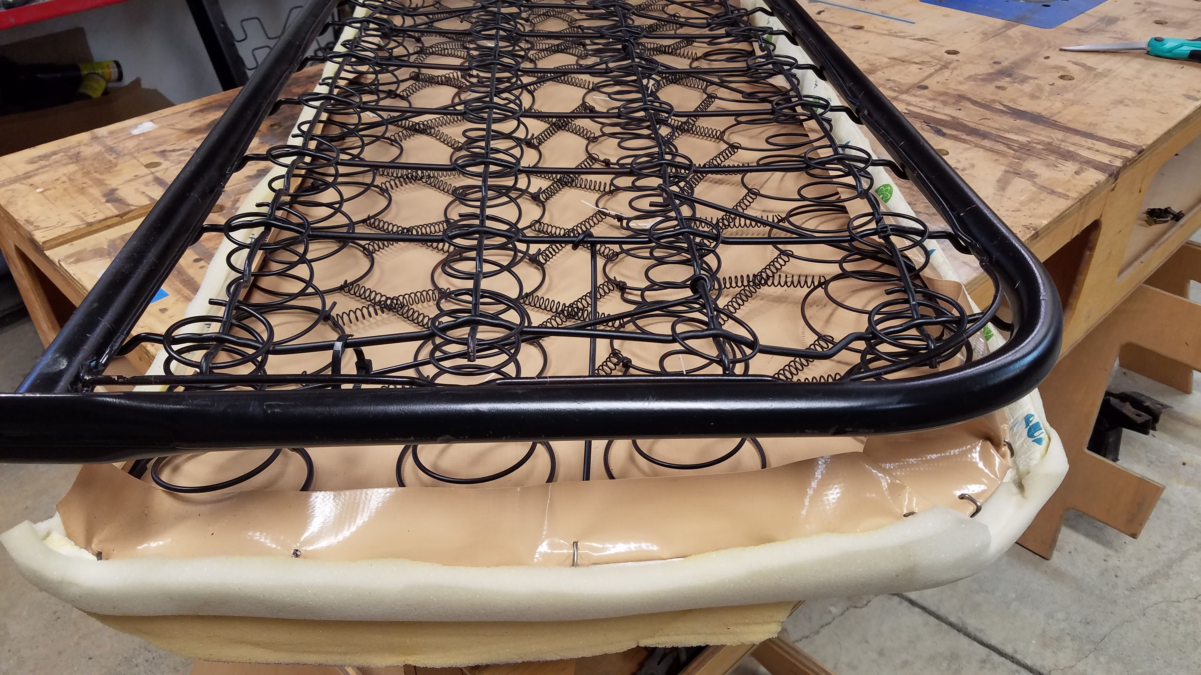

I would do away with those outer springs that stick up higher than the rest. Then you will have a flat surface to start with. Keeping the rest of the stock spring system will make for a nicer ride than using a solid wood base. I run a row or two of jute webbing from side to side to stiffen it up a little bit, that’s just my personal preference. Then I do a layer of upholstery vinyl over the springs, then a layer of jute carpet padding. Then on top of that you can do your foam. I use 2.2 density 50lb compression foam for the bottom cushion. Here’s the bottom of a C10 seat I just finished.
