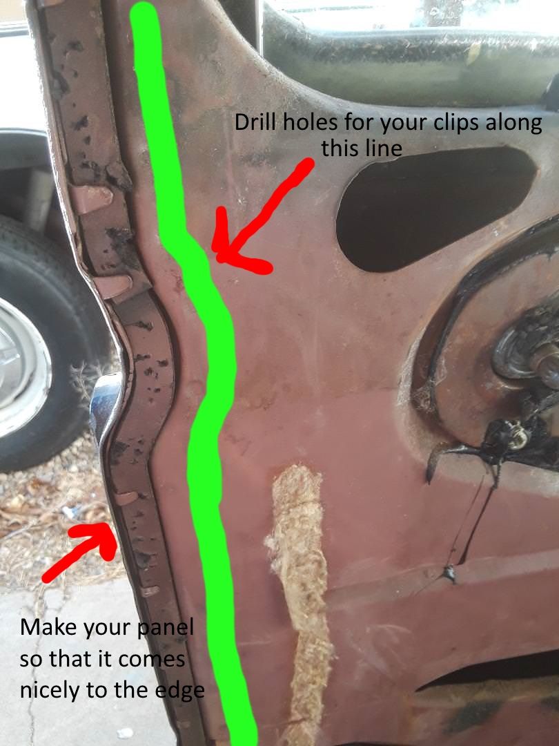

Image I admit, when I purchased the course I skipped around from video to video while working on my '54 Belair 2 door post project. Upon review, I haven't found what fasteners I should use, where the white x's are marked, to fasten the back seat side panel to the car. The old ones were shot, and I did manage to find the ABS tack strip to replace the old crumbly one. But I need to install something there before I glue my panels all together. Thanks.

Image Thanks for the reply, John, and BTW, I'm a big fan. Love to see the next generation of "blue collar types". Ok, this is a pic of the tack strip, still in the Belair. Whoever did the last trim job on the car used a metal strip with sharp nails protruding out, like something they would use on sofas, I think. So the panel was attached on top of the windlace to the tack strip. I like those clips you recommend, used them on the front door panels. So, should I drill new holes for them just to the side of the new tack strip so they don't interfere with the windlace?

Hey @JoeTheRoofer Yes the way I would do it is make you panel so that it finishes nicely with the edge and install your clips about 1.5" in from the edge. Staple the windlace to the tack strip you have there and install your finished panel on top covering all the staples from the windlace.

These are the panel clips I ended up using, which I bought at an upholstery supplier. They are the longer one, as seen on the left, as opposed to the shorter one, which I got at Ace Hardware in bulk. The shorter ones popped out too easily around the concaved contour of the front door (my '54 Belair is nearly the same as the '53 in your instruction video, John. I had to "unglue" the fabric around the panel to add a couple more clips and replace the shorter ones. Bad, pics, I know.
