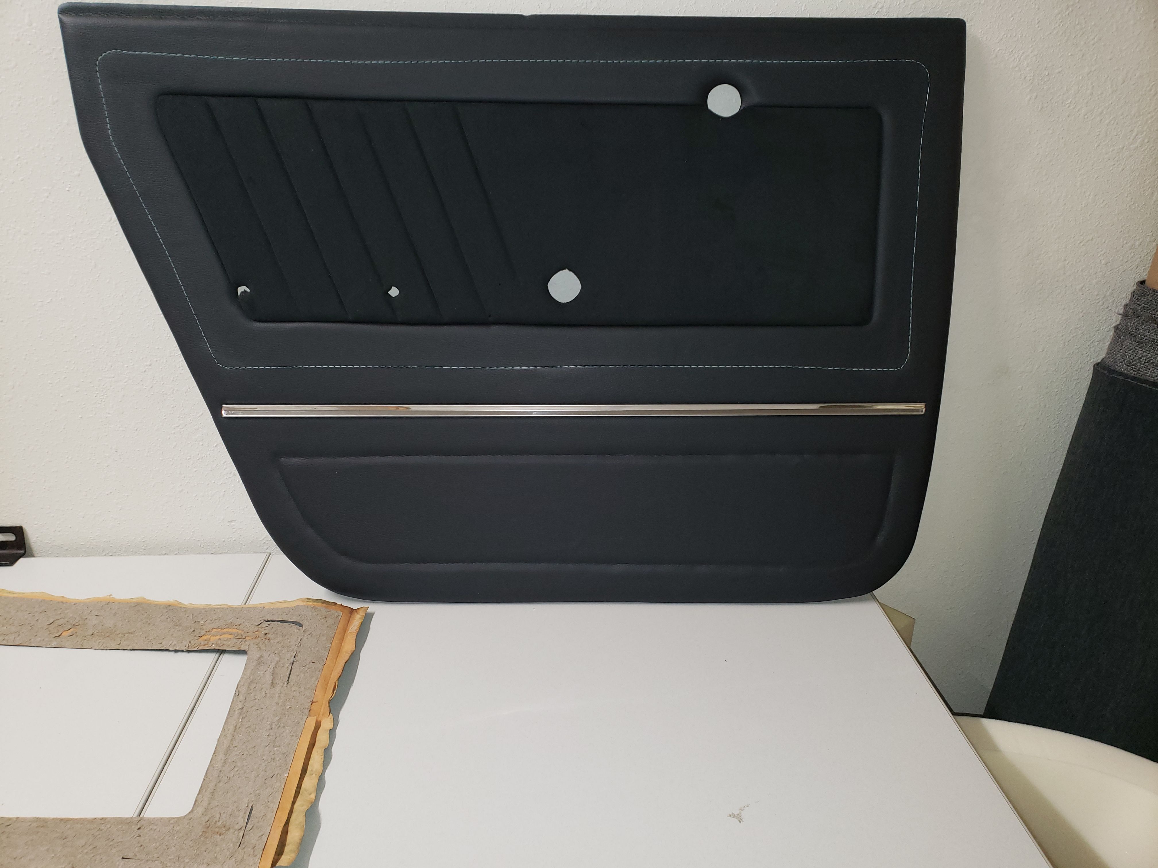

I am currently replacing the interior in a 66 Chevelle for a customer. I am curious if anyone has run into the chrome/stainless door panel trim piece that separates the panels? I made new panels and am trying to secure it to the vinyl but not having much success. I used the landau cement and let it tack up for some time before pressing it on and left clamps on either end for a while and it still is peeling off. It does not have pins on the back.
Any suggestions on how I can install this properly? Double sided 3M?

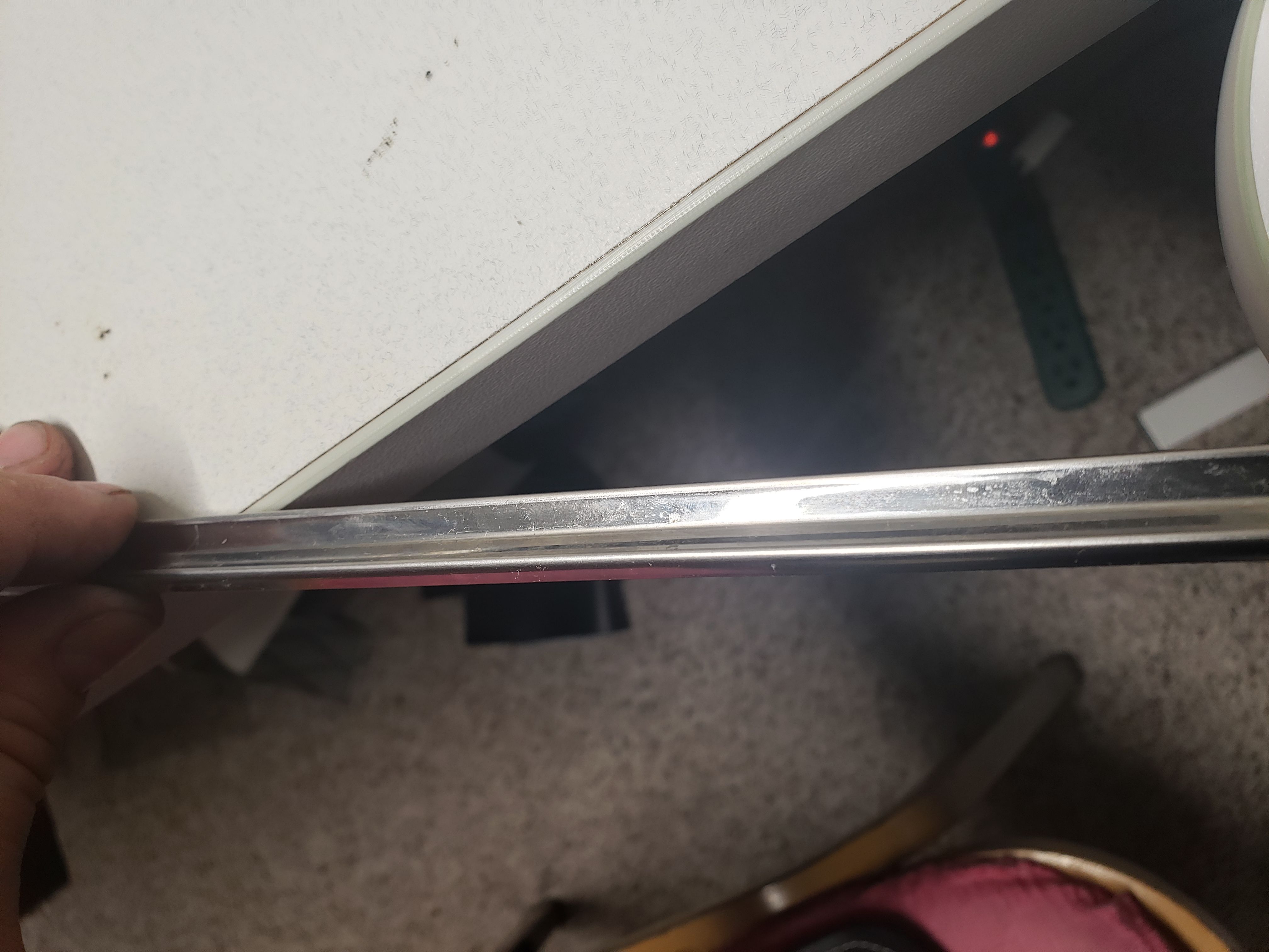

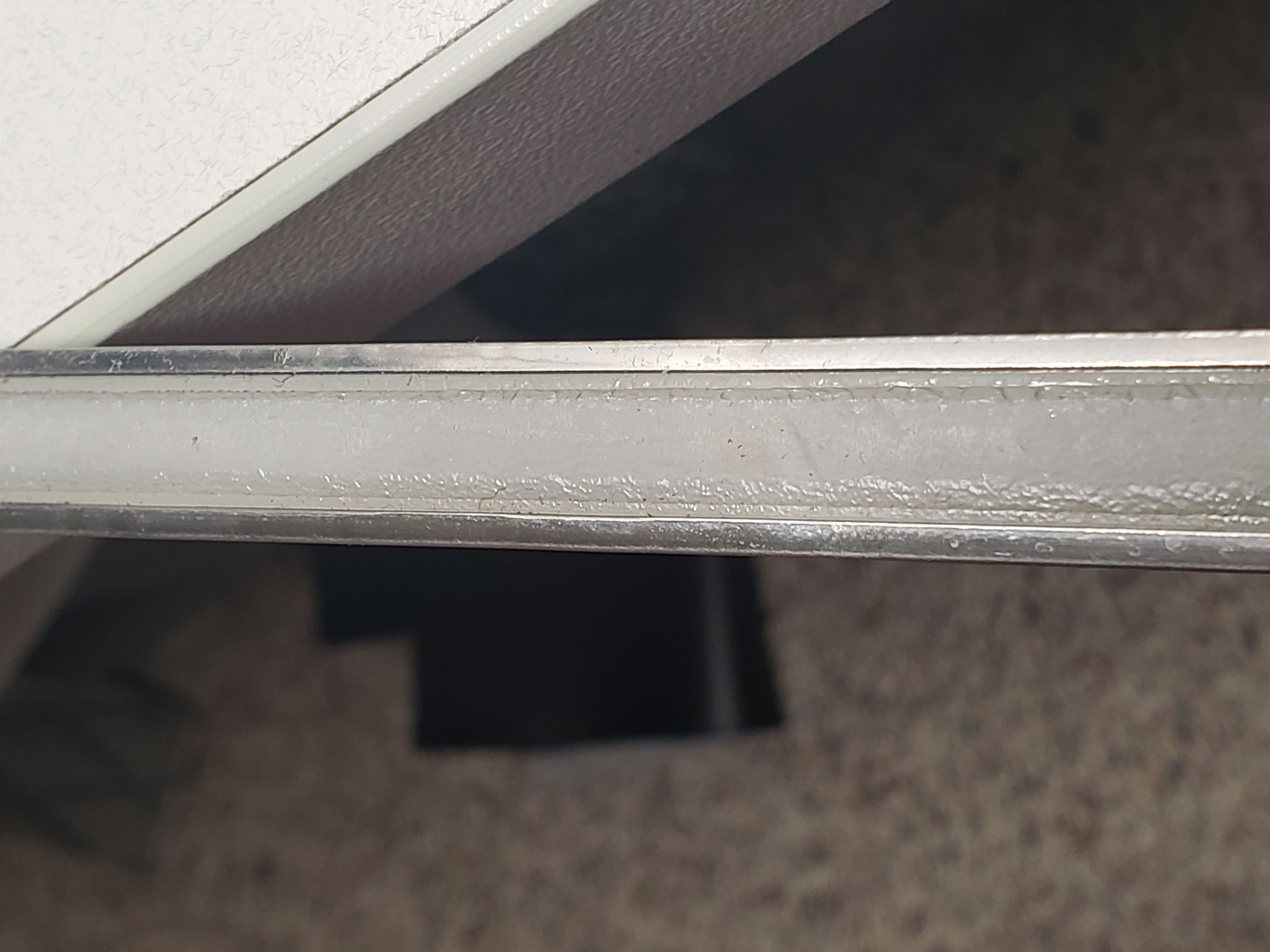

By Matt Hamblin
#11521
John,
Here is what i am dealing with.

Hmmmmm, That is a different situation.
Two thoughts....First, maybe you could add studs with a stud gun like body men use to pull dents. I have one. It's a shame you're not my neighbor.
Secondly, and probably a better solution, is to take a MIG welder and attach welding wire to the back strip. You could pull it tight with 8-10 pieces of wire through holes in the panel.
My origional idea could work but you would have to to take a die grinder with a cut off wheel down the middle of the strip. Once you had the strip split lengthwise, you could remove it and the make the clips a shown above. It would be very labor intensive and I don't think it would be the best way though.
Let us see what you end up doing...Good luck with ot.

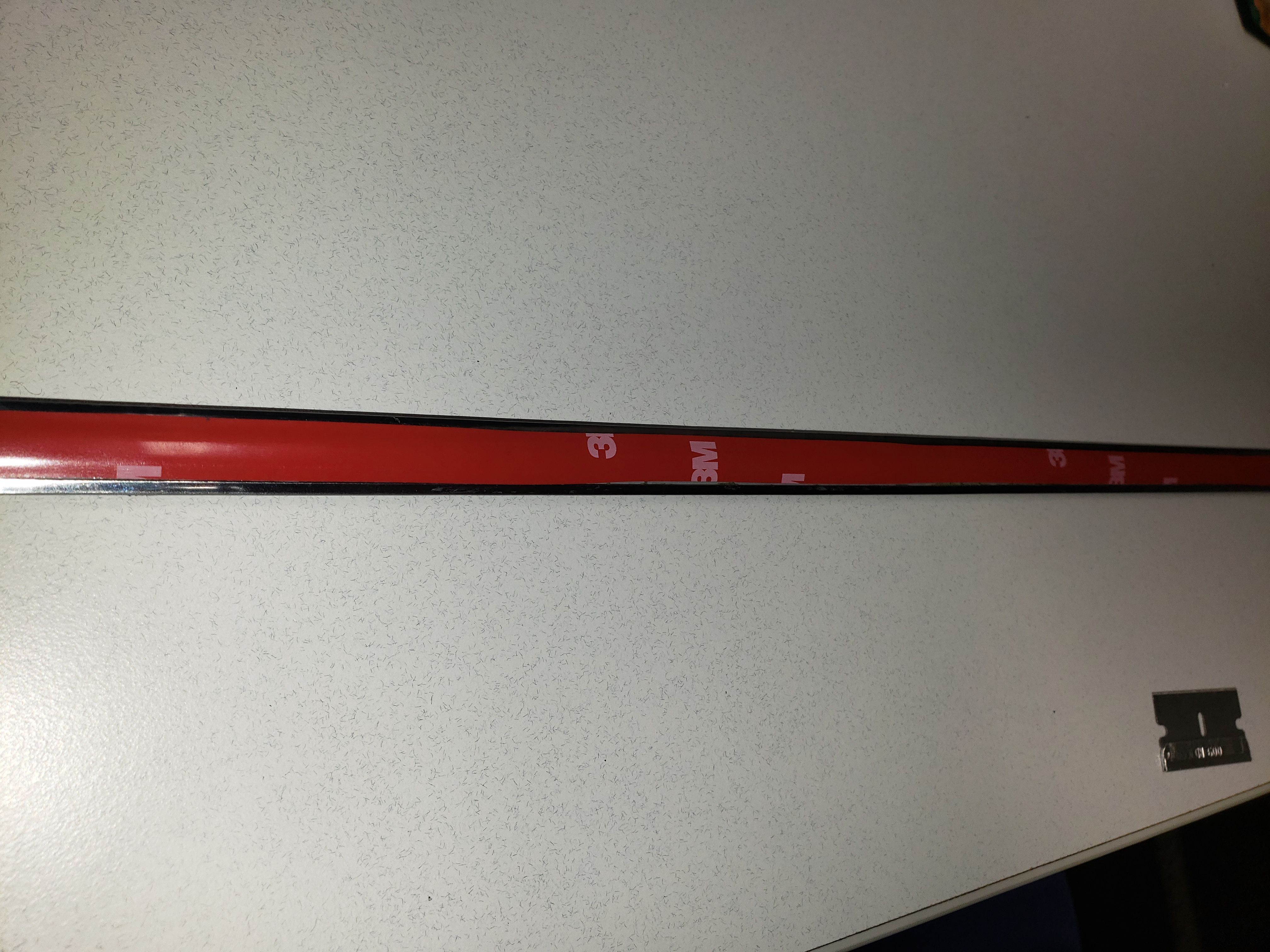

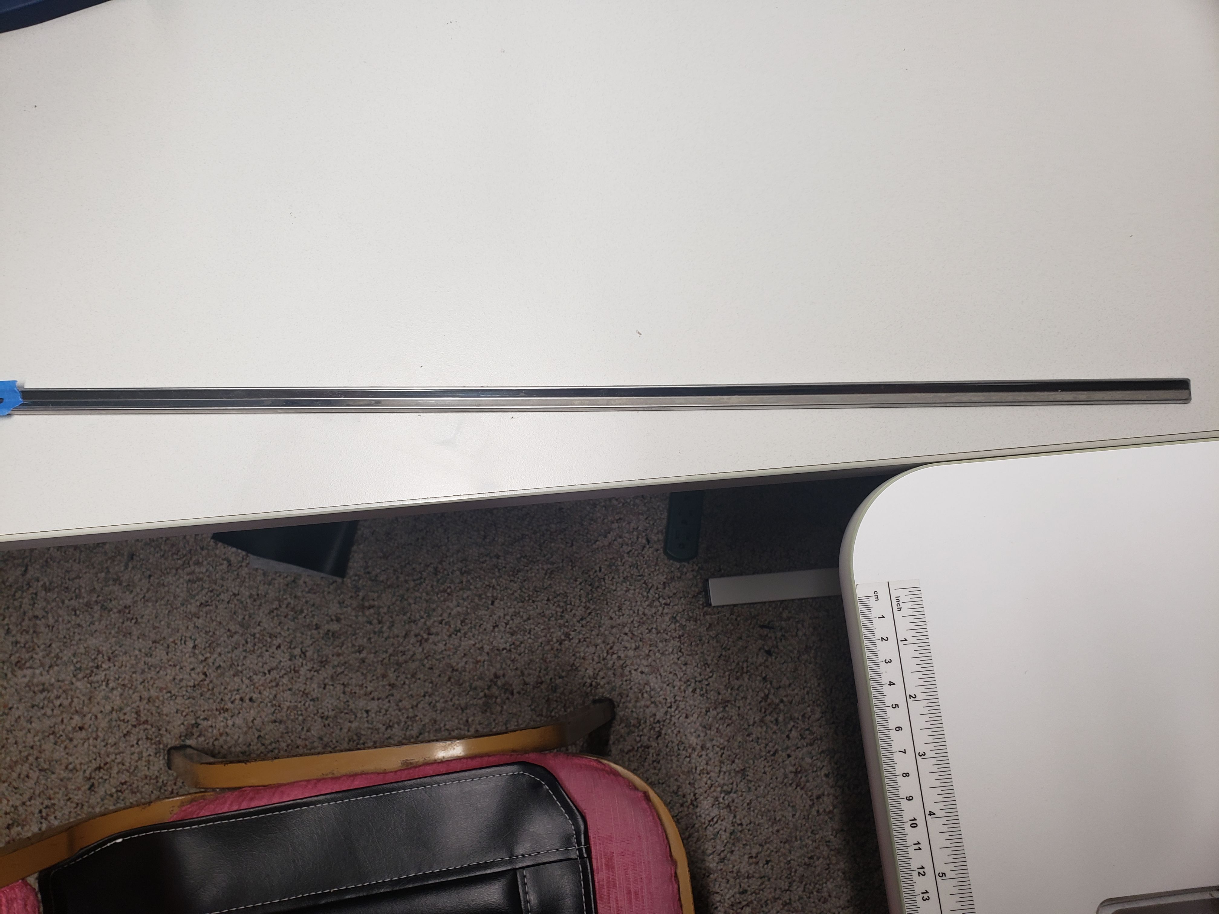

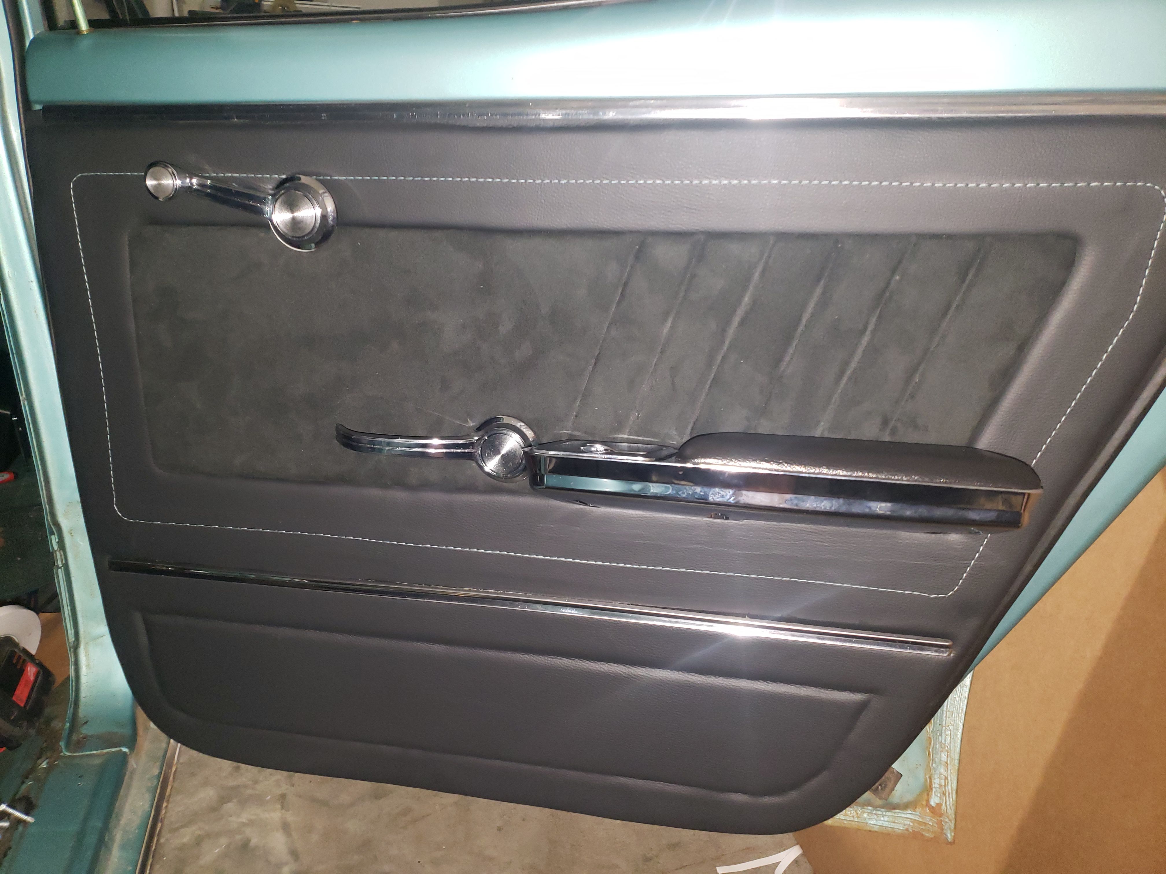

By Matt Hamblin
#11564
John,
Here is what i finally settled on. I just used the classic 3m tape. I tried drilling holes and running wire through to hold them on but it was very tough and risky and the wire really didn't want to feed well into the trim.
I don't have a way to run my welder at home so i did a test piece and it seemed ok so i just did the first one. Seems to be holding very well. Hope it lasts long term but gotta do something to make it work.
Thanks for the ideas!
By Matt Hamblin
#11615
Thanks John! Appreciate all the videos and training! I doubt i would have been able to make them look like that without your videos. Thank you!
