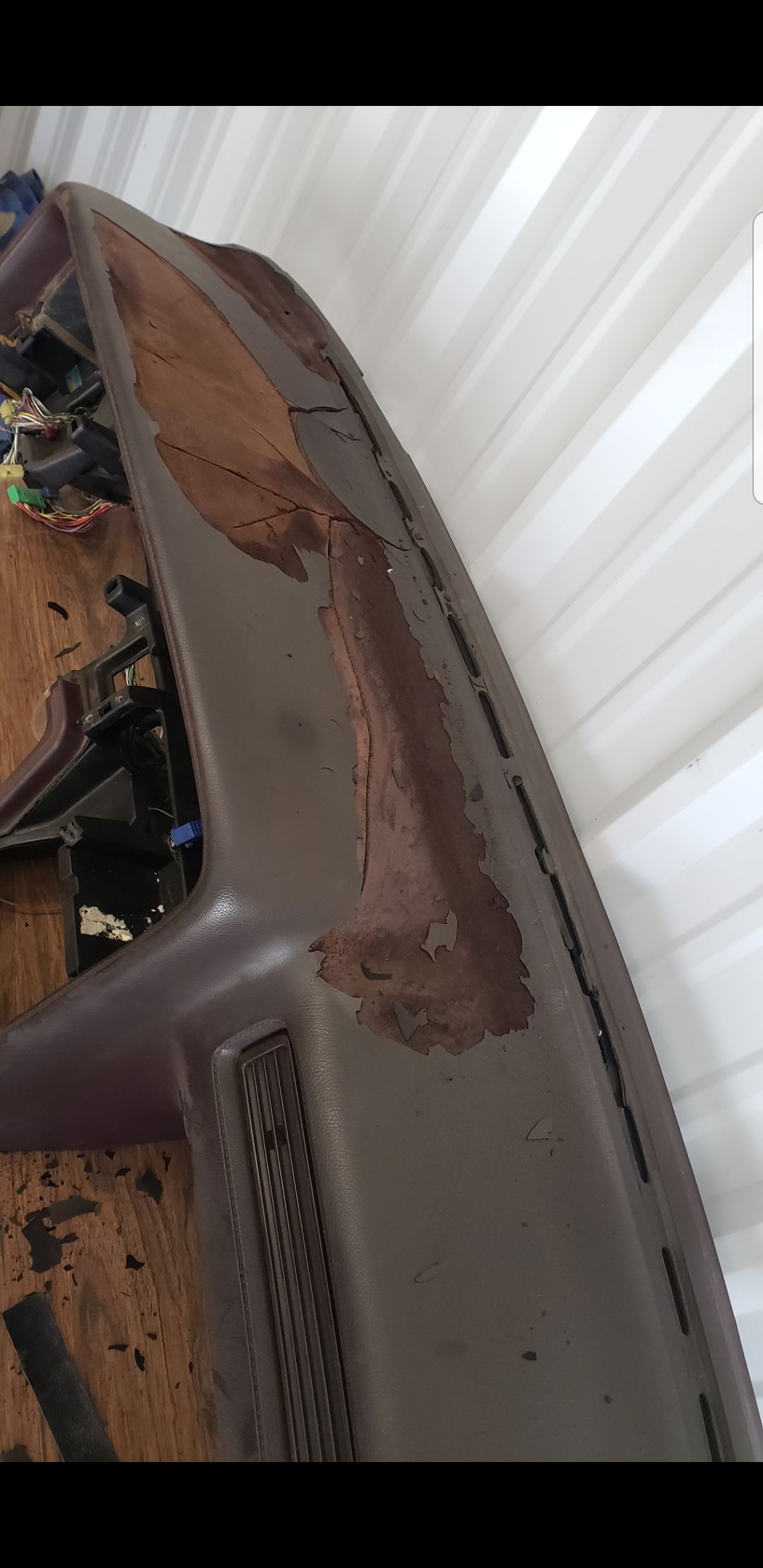

What's up guys first post here. I have a 87 supra dashboard and most of the vinyl ontop is baked and you can take it off, I'm wondering what'll be the best method on repairing it
#10079
That is going to be a tremendous amount of work to repair. Your going to have to body filler it smooth again. Paint it with primer and wrap it in leather or vinyl. Its really the only way to fix those if you cant find a new one.
