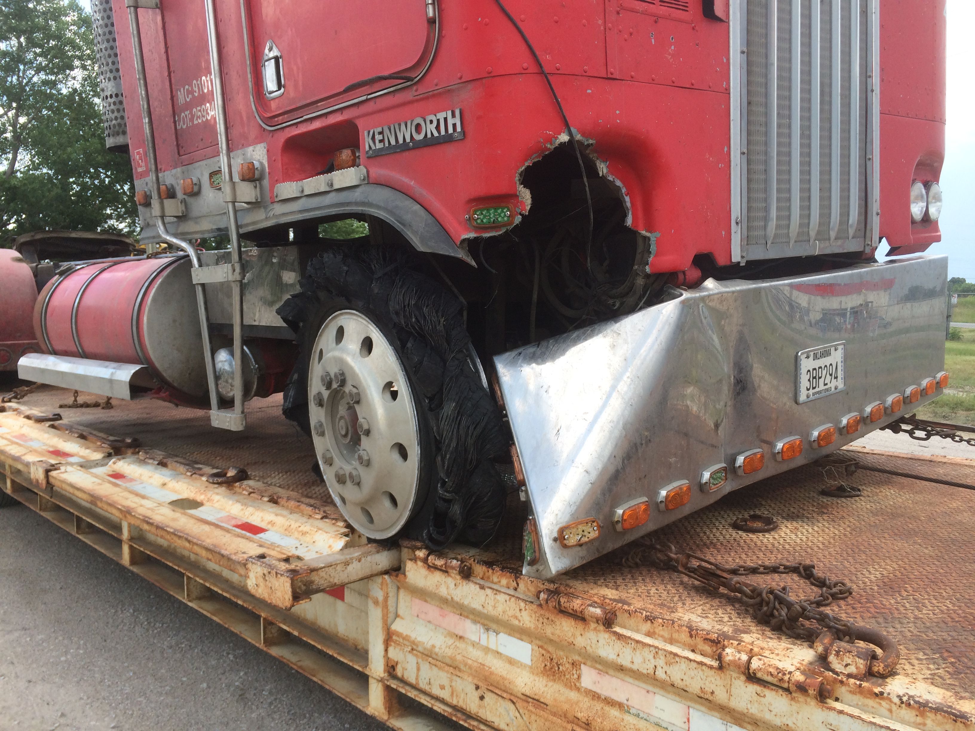

I've got one in the shop right now you might get a kick out of. K100 that blew a steer tire on 244 in Tulsa. I've got a fair amount of fiberglass work to do on this ol girl.

@SmokinSCustoms
That's a nasty black eye! Man I saw a perfect survivor K-100 in Carthage last week, wish it wasn't so far from the house or would have asked about it. Not so far from you. It's on 400.

Its crazy how much damage a steer tire blow out can cause! I bet that was a scary ride.

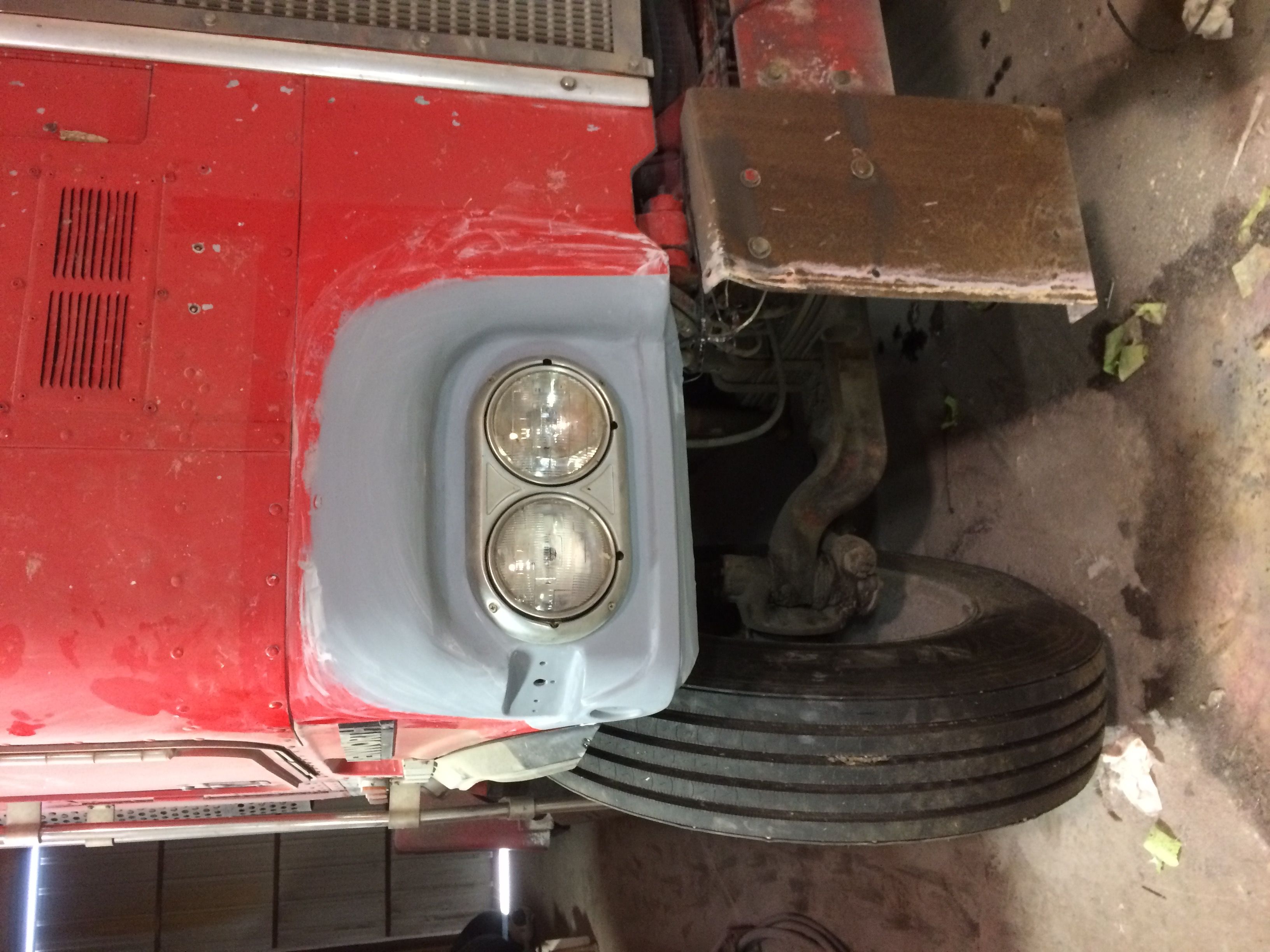

Got her all glassed back together and primed last week. Problem with trying to color match the red is that its single stage that was put on about 4 owners back. So she may be coming back in after a bit for a full paint job.

@Bondo497 .
Hey Bondo, I am curious about why there may be problems with the single stage and repainting from a few paint jobs back? Is it just color matching? You smoothed that out really nice!

Thank ya sir. Luckily they found some of the pieces on the side of the road so I wasn't starting completely from scratch. Probably 50% of it was from scratch. Just time, $, and fiberglass. HaHa.

Sorry I've been away a while, just saw your question. One reason is fade out and oxidation that you get with single stage paints and also hard to blend without leaving a pebbled dirty blend edge.
@SmokinSCustoms
Nice repair. I would recommend buffing surrounding area around the repair to bring up the original color as close as it used to be and have it matched in a base color then spray it base/clear. This way you can blend out the color and melt in the clear.

Since you have the luxury of the headlight panel being separated from the main body panel you could easily tape that panel off which in sure you're going to and put flattening agent into the clear if you decide to go BC/CC and that will immulate the dull existing finish. Just puting that out there.

10-4 on all that. I've done enough repair jobs to know when to blend it back and when to re-spray. Old girl is rock and bug chipped all over the front. Matching would require a "faux finish" Haha. Imagine that, going at fresh paint with a slingshot and rocks just to make it not stand out.Customer wanted it "legal" for now. I was nice enough to seal up the fiberglass and gelcoat. "Customer's always right, even when you would rather do it right".
