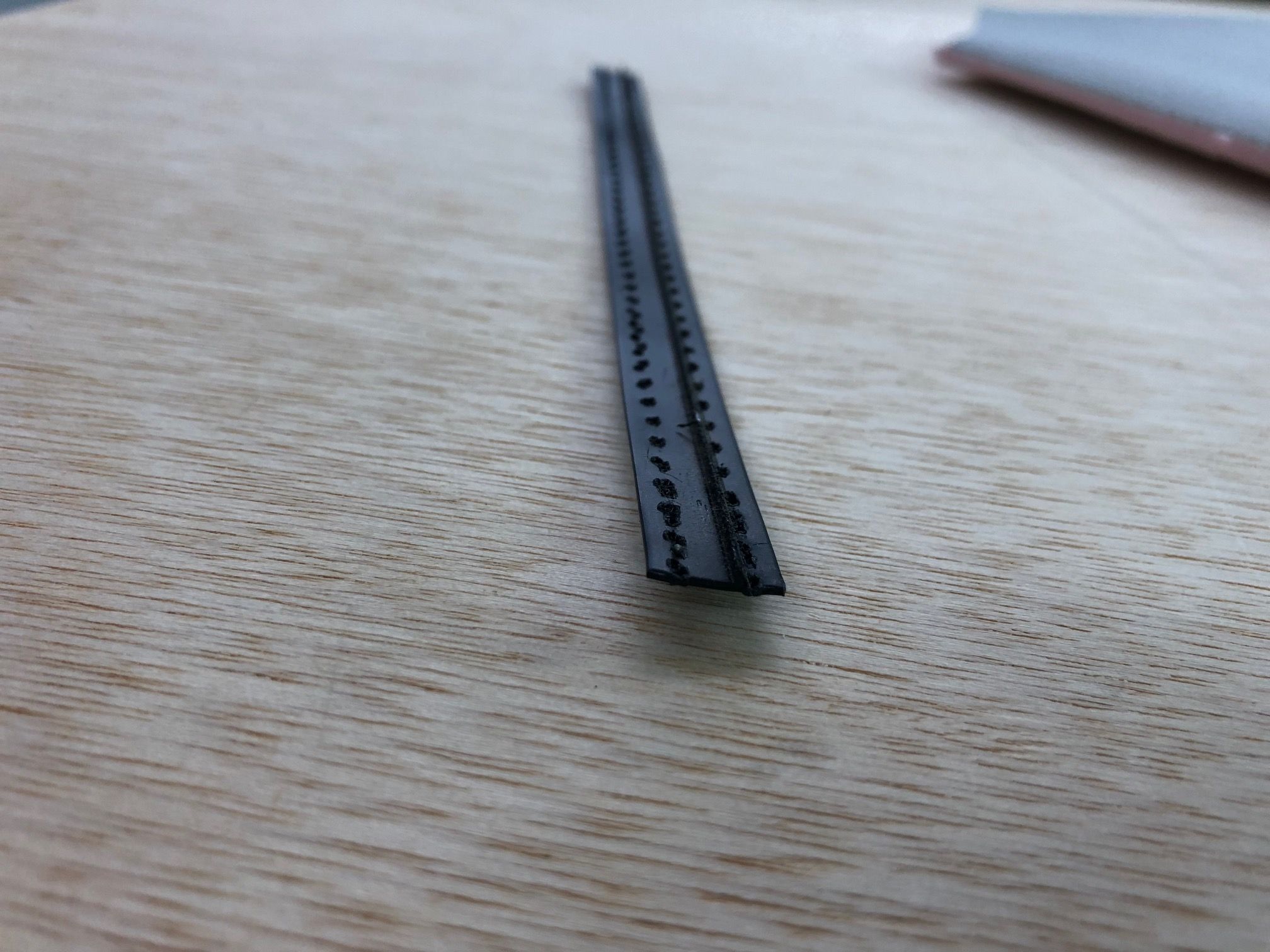

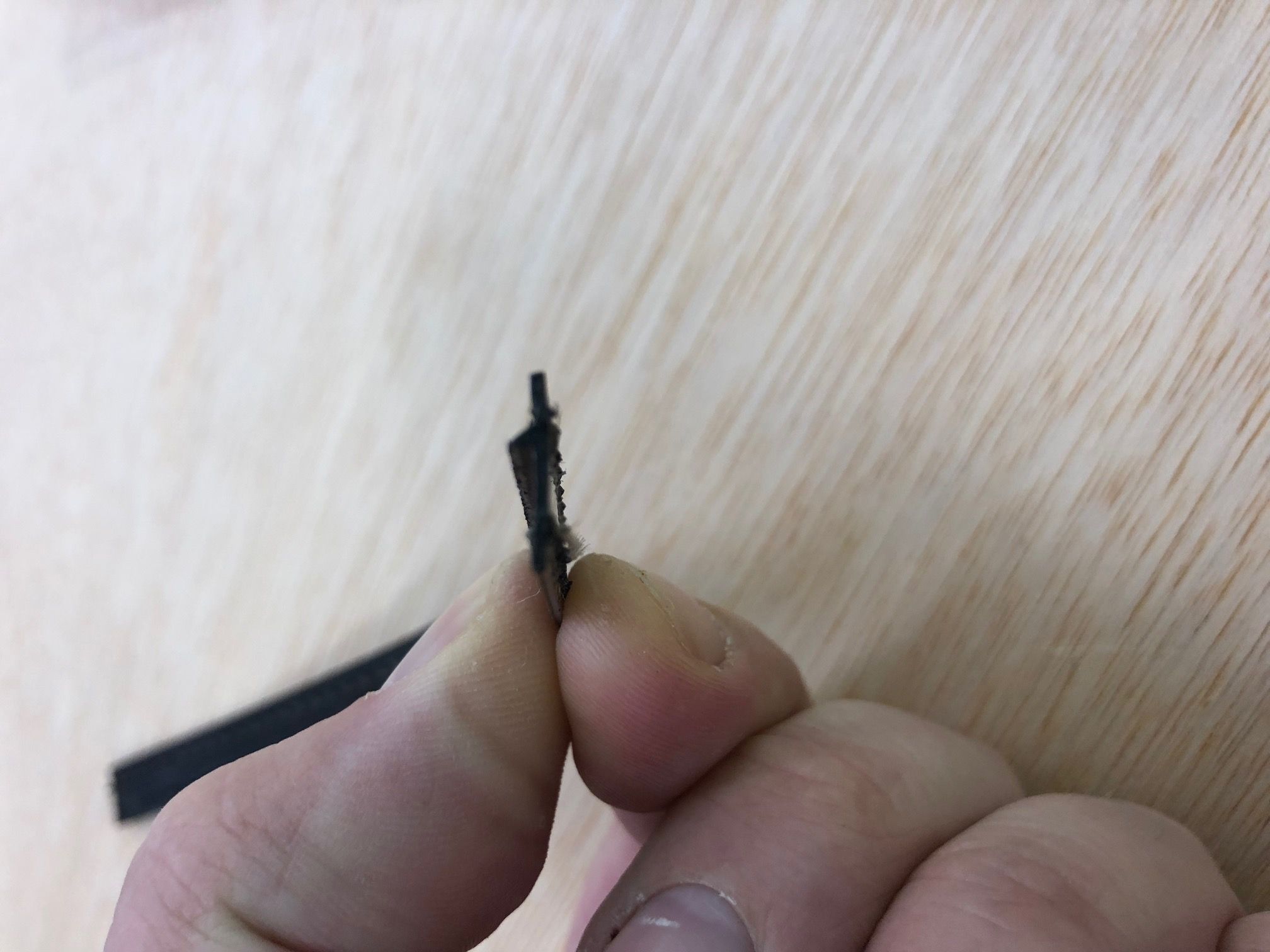

Sorry for high-jacking post but very similar question. In my headrests J-clip is built into headrest frame and on cover there is 2 strips with a "tooth" like on a picture. Is there a place where I can buy new ones? What do they called so I can google it?
I get it they can be reused but the ones I have will be junk by the time I finish practicing. I thought about not practicing with them, then I tried to attach just one and broke 4 needles. So I do need to practice A to Z with those things and ideally I want new ones to finish project.

Same issue here with using up the clips. I see where Albright's has the J part but not the straight part that you are holding. I need to find those as well.
#3322
I got a flier from veterans co showing they sell the j clip along with pyramid trim.
