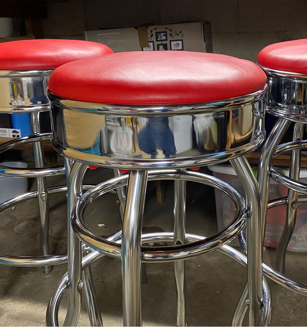

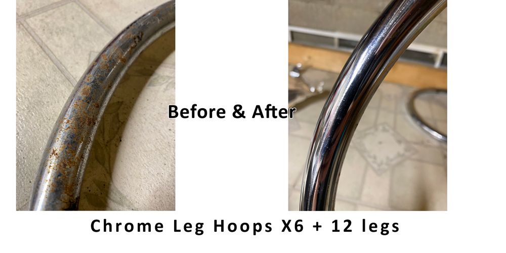

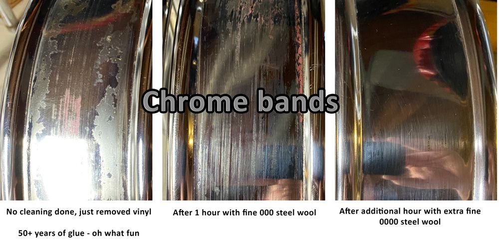

Finally got the vinyl in. Went for the Starboard Red. Those chrome bands are spring loaded so they will not go together happily. 1 pair of hands to take it apart, 2 pairs of hands and patience to put it back together. Only thing holding that vinyl as tight as it is is 2 bolts on the bands. This was a glue-less & staple-less redo. Biggest amount of time on this was the cleanup as this were real chrome legs, hoops and bands. I left the red vinyl off the bands on purpose, I like the chrome look :) I'm kinda enjoying this upholstery gig lol
My estimated to clean all the chrome was approx 10+ hours on the 3 stools, the results are worth it. Now they'll go in my garage and await the bar to match...if I can find one!
