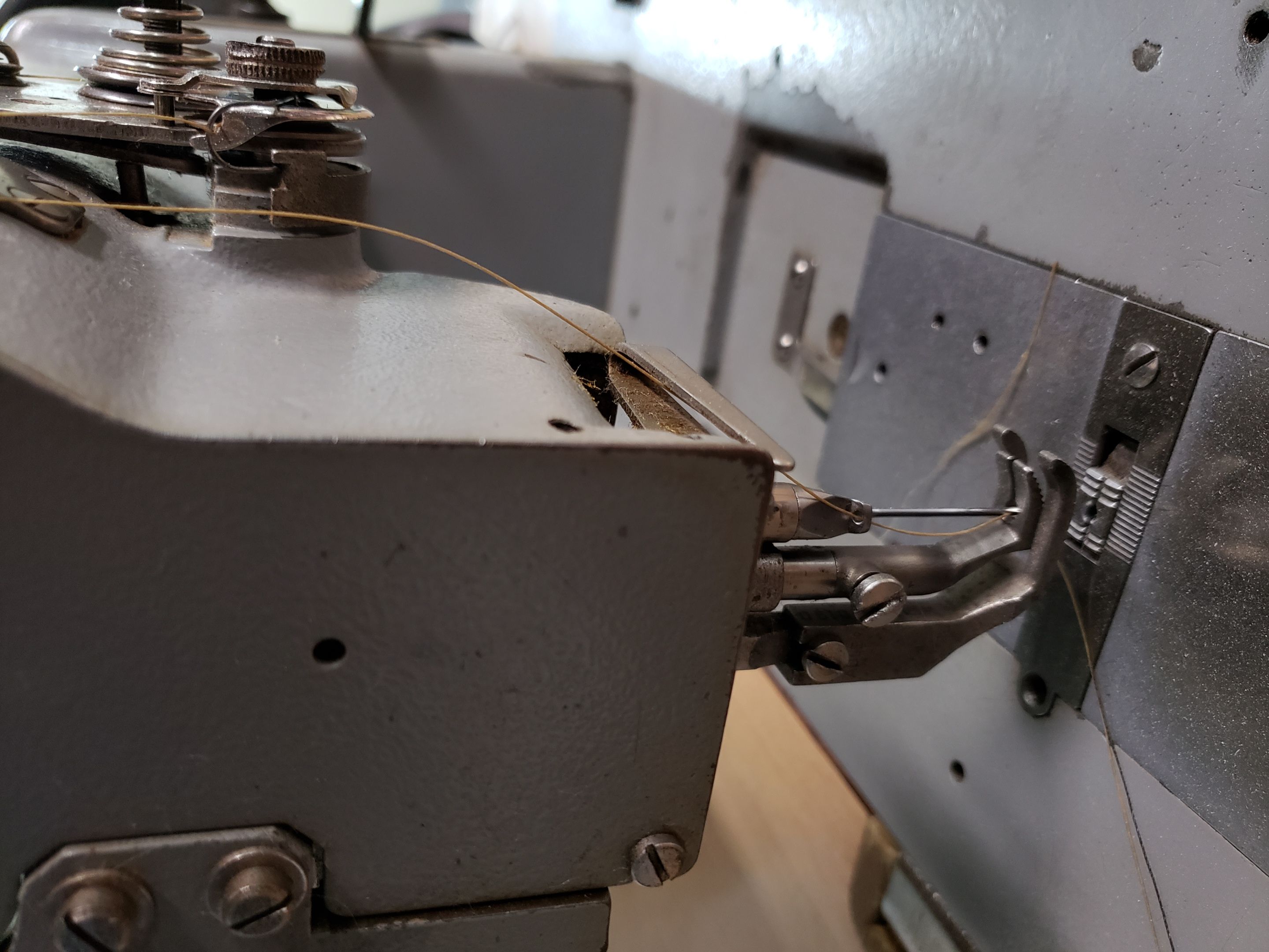

I just purchased an adler chandler 67-gk373 machine and want to do contrasting top stitching. I. Looking for a foot like the one pictured. Haven't found one that says it will fit this machine. Can someone point me in the right direction? Image

You are looking for what is called edge guide feet. I am %90 sure these here will fit you machine. https://amzn.to/2A6Boig
Can you post a picture of the feet you have on your machine now and I should be able to tell if the will work for you.

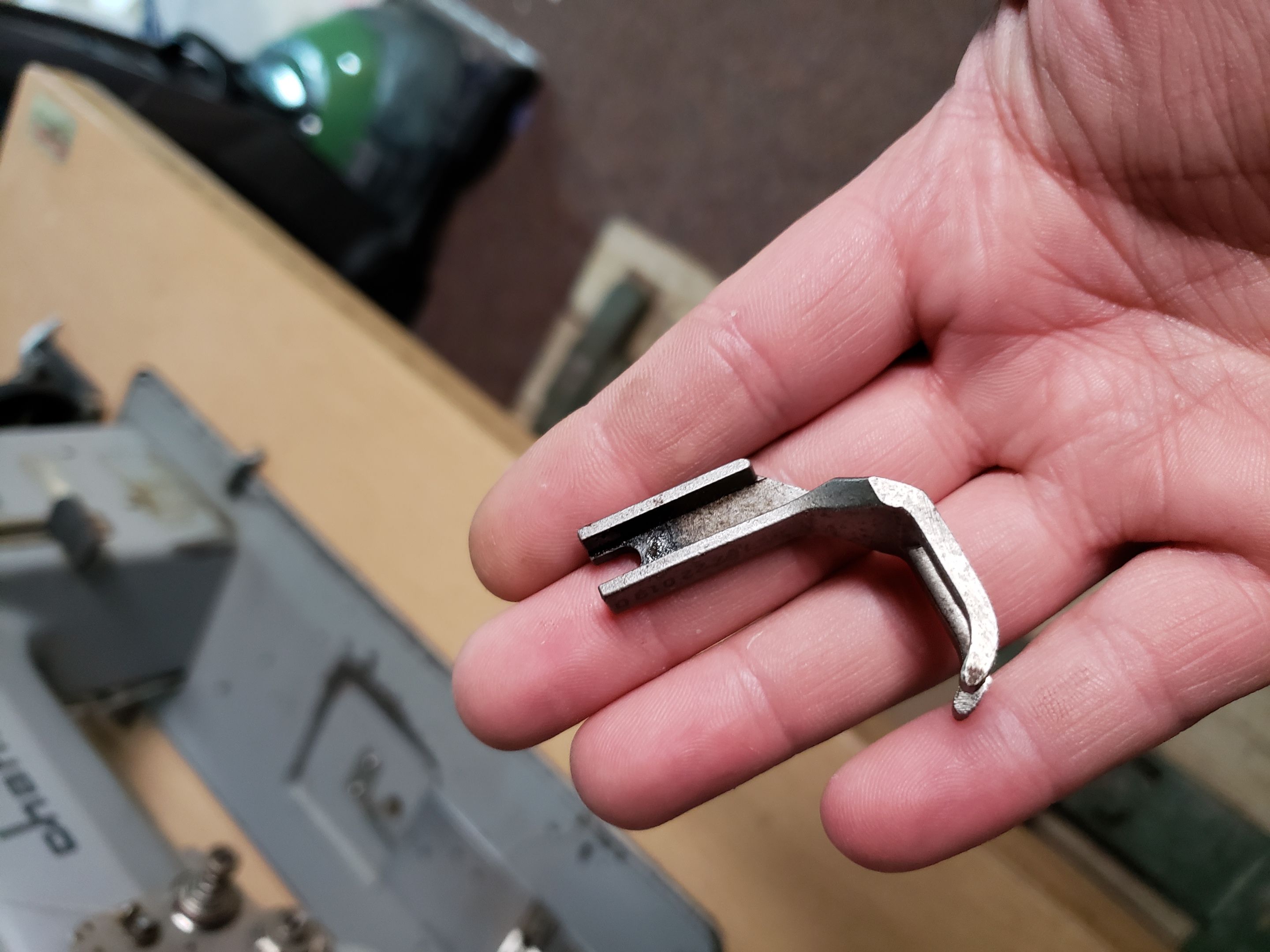

Here are some pics of the foot on the machine now. Also i was watching your beginner videos and you say to use 92 thread for everything. Can i use a #18 needle for that? I just bought a 100 pack of #18 for all the sewing and a 100 pack of #23 needles to use for contrasting top stitching.

Yes I use size 92 thread for almost everything. Size 18 needle will work fine for that size thread and 23 will be good for contrast thread. Check out my video of choosing needles.
The feet I posted will not work on your machine. Try a google search for (Your machine model)+ edge guide feet.
