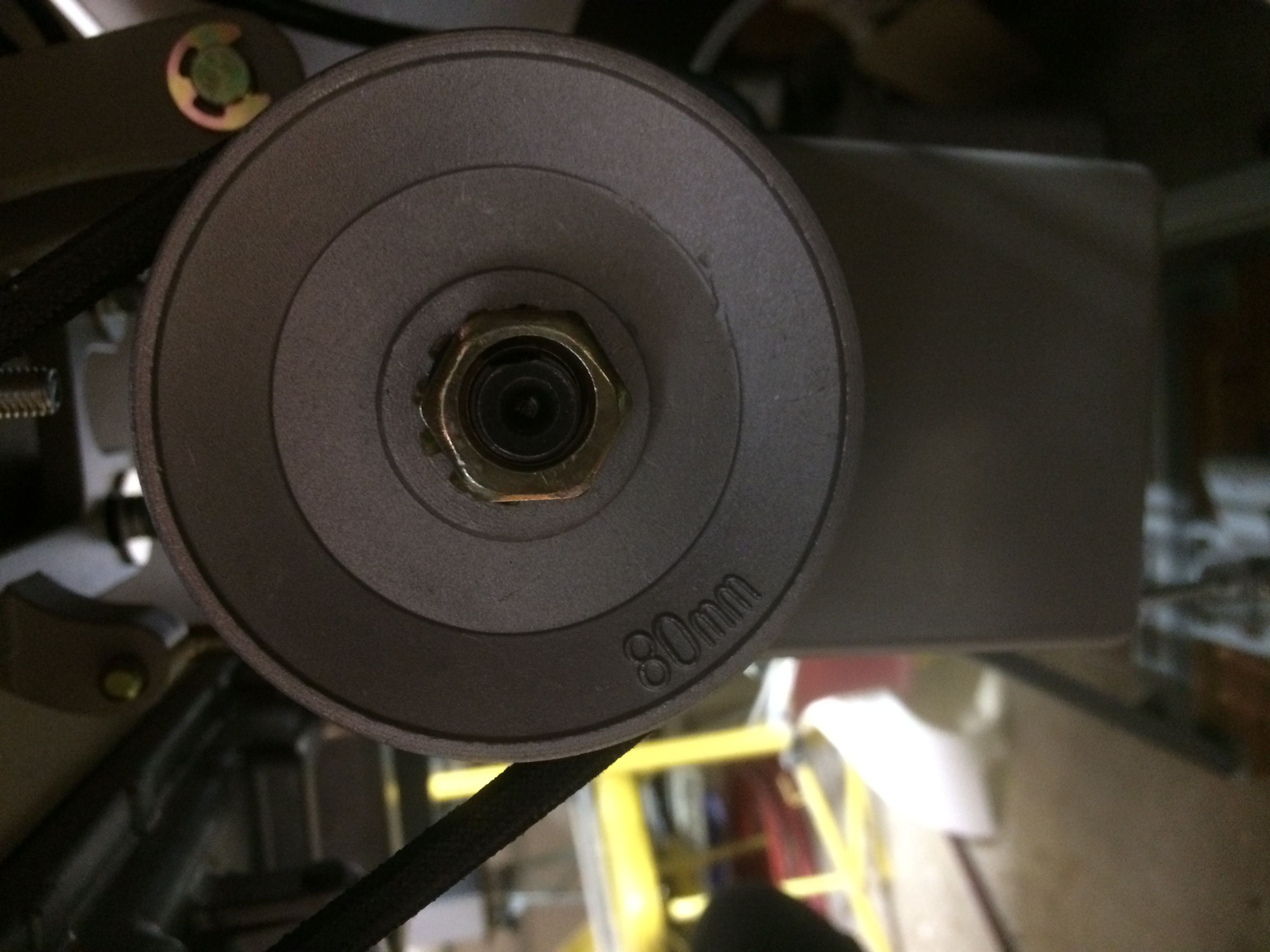

@John I'm looking at potentially adding a speed reducer to my machine just to get some more control and let my motor start easier. I looked on eBay earlier and they want over $200 bucks for one. Do you know anywhere else to find "aftermarket" parts for these machines? I mean its just a pulley and a bearing.

@SmokinSCustoms Do you have a clutch or servo motor on your machine. Ive never used a speed reducer before but I think it will make your machine super slow. I believe speed reducers are more used for adding power for sewing super thick leather. The really slow speed is going to make you crazy when you get better and actually want to be able to sew faster to get work done. How big is the pulley on your machine?
Also for less than $200 you can buy a servo motor and be done.

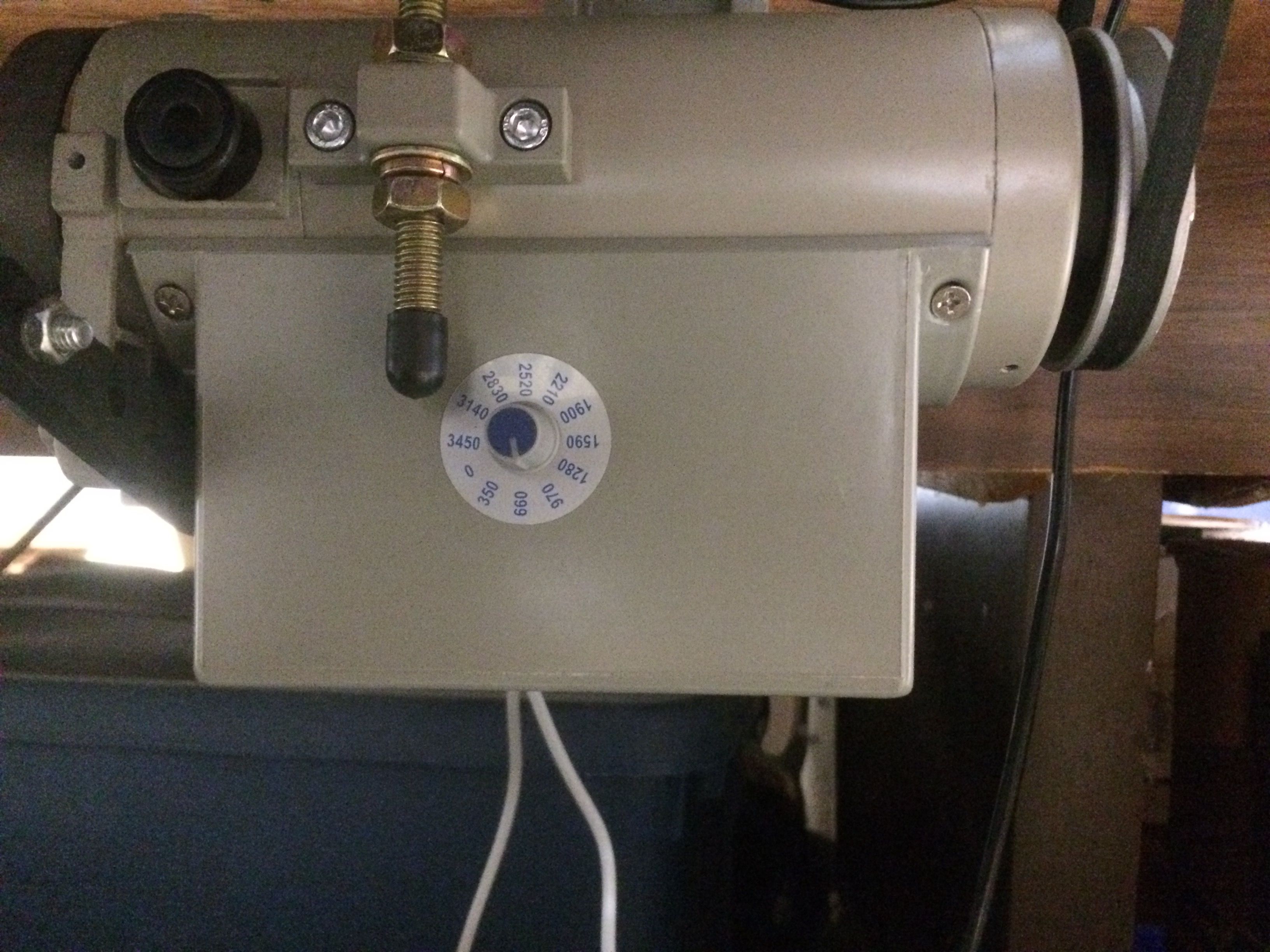

@John I'm running a servo motor currently. The problem I'm having is this machine is extremely fast. Like 2,000 stiches a min fast. I've cranked the motor as far down as I can and sometimes I have to bump start it. I have to hand roll around corners and I just wonder if backing the machine speed down and turning the motor up would result in easier starts and better control.

@SmokinSCustoms
I don't know. It sounds like you have a different problem. With a servo motor you should me able to easily adjust it to a speed that is comfortable to control and has plenty of power to sew.
To me the problem your having does not sound normal. You shouldn't need a speed reducer with a servo motor.
Have you called the place you bought the machine from yet?
Can you post a pic and the info on the motor?
Hope were able to get it figured out. Sound frustrating.

@John
If you slow it down below 660 it won't even turn the machine through. I can't find the specific specs on the motor or in my paperwork, also most of its in Chinese which doesn't help me much. The machine model is a DU-1181N.
It is definitely frustrating, its a servo motor that wants to act like a clutch motor. Extremely touchy.

#776
@SmokinSCustoms Thats really strange.... On most servo motors I have used, when you set it to the lowest setting it wont move like your saying but as soon as you turn it up a few clicks it has plenty of power and is easily controllable. And the motor you have looks like most of the other servo motors Ive used. It shouldn't act like that.
You recently bought this machine new right? Have you called the place you bought it from yet?
@Bondo497 Yeah they are defiantly strong ans super powerful. I was impressed with it. Especially cuz it feels like a tiny light little motor when you take it out of the box.

@John I haven't got in touch with them yet. Was trying to troubleshoot the problem that way I when I talked to them I'd be a bit more knowledgeable. I'll give them a call and explain the issues and see if they have any ideas. Maybe just a smaller pulley swap might do the trick? This machine can run WAY faster than I would ever want to sew. I don't know who would want to lay down 2,000 stitches a minute.
